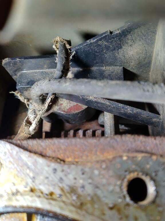

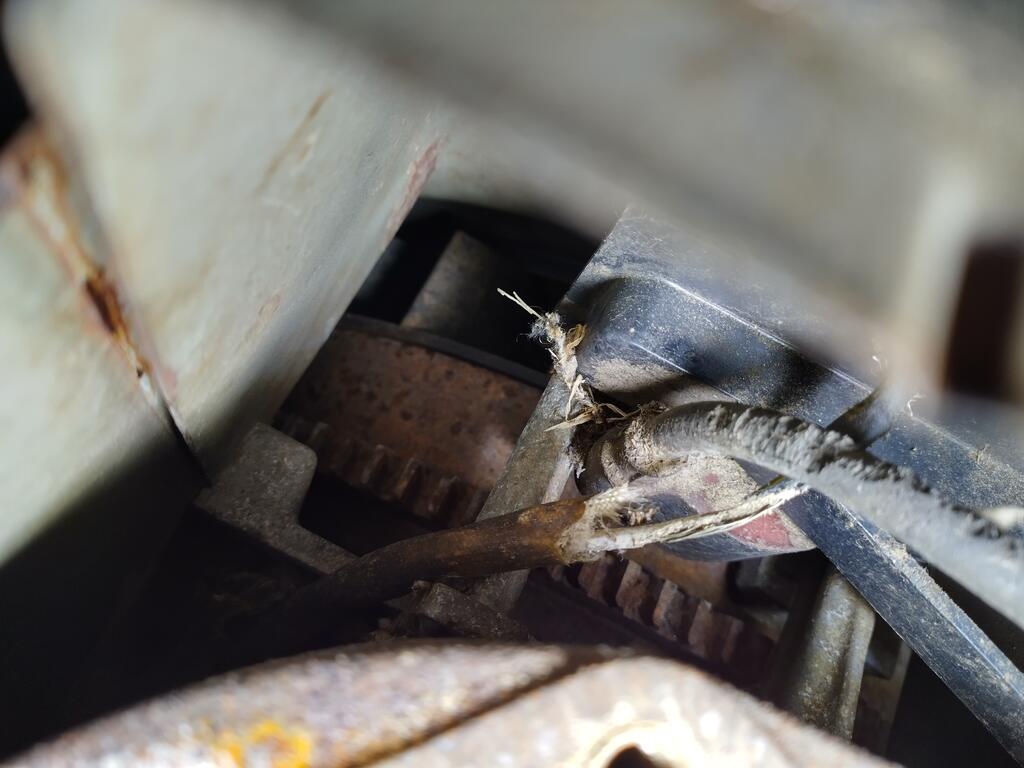

ebinmaine 80,756 #1 Posted August 7, 2023 Is this perhaps the kill wire? Does it need to be repaired? Share this post Link to post Share on other sites
WHX?? 58,177 #2 Posted August 7, 2023 Sure looks like it is. Thinkin it should be insulated. BTW I think yer mice needs dentures... 3 Share this post Link to post Share on other sites

Rick3478 469 #5 Posted August 8, 2023 1 hour ago, ebinmaine said: Is this perhaps the kill wire? Does it need to be repaired? Yes it is. It's low voltage and not much current, so you don't need to get carried away, but maybe slip a piece of small split loom over it or something. 1 2 Share this post Link to post Share on other sites
WHX?? 58,177 #6 Posted August 8, 2023 A piece of shrink wrap? 1 Share this post Link to post Share on other sites
ineedanother 2,871 #7 Posted August 8, 2023 2 hours ago, ebinmaine said: Does it need to be repaired? Uh. Yeah. It's there for a reason and there's not much left of it. The one on my M10 looked similar but they ate the coil wire too so I needed a new too You know you won't sleep well not addressing that 1 Share this post Link to post Share on other sites
ebinmaine 80,756 #8 Posted August 8, 2023 7 hours ago, ineedanother said: You know you won't sleep well not addressing that Normally I'd agree but it's the only thing in there and been that way and fully functional. I only ask because I don't necessarily want to get in there until we tear apart the rest of the tractor to do other work. 1 Share this post Link to post Share on other sites

ineedanother 2,871 #11 Posted August 8, 2023 12 hours ago, ebinmaine said: Normally I'd agree but it's the only thing in there and been that way and fully functional. I only ask because I don't necessarily want to get in there until we tear apart the rest of the tractor to do other work. I get that EB. The mount for the magneto is plastic and there doesn't look to be anything conductive close enough to ground it so you should be good to go for a while IMO. 1 Share this post Link to post Share on other sites

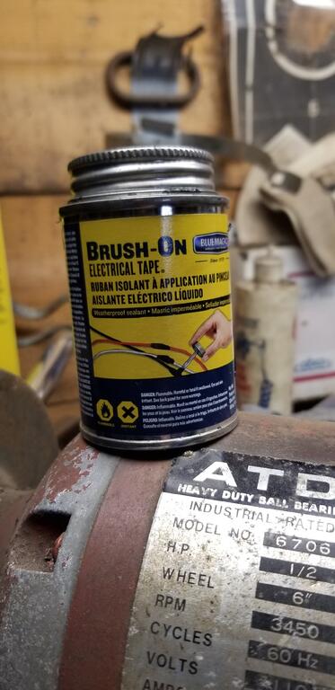

gt14rider 1,278 #12 Posted August 23, 2023 I've had good luck with this liquid electrical tape. Temp fix would be fine. 1 1 1 Share this post Link to post Share on other sites
ebinmaine 80,756 #13 Posted August 25, 2023 On 8/23/2023 at 5:09 PM, gt14rider said: this liquid electrical tape That's interesting stuff. Not one I'd heard of yet. Share this post Link to post Share on other sites
Gasaholic 390 #14 Posted August 25, 2023 Yup, that was my first thought when I read the original post - liquid tape - or even RTV can do in a pinch. it doesn't really hurt anything to leave it if there's no where for it to short to ground, but if you get build up (grass & crud) that gets wet it CAN cause intermittent shorting to ground (and the misfire that would go with it) so often enough a dab of RTV is a quick fix (Field Repair, if you don't have wiring kit handy) - RTV has also temporarily fixed chewed coil wires well enough to drive it across the 6 acres of field to get it to the truck and get 'er loaded. (qucker to wait the 20 minutes or so for the RTV to skin up well than trying to push a Sundstrand hydro unit tractor across 6 acres of field, and far quicker than driving back to the shop for parts which was 30 minutes one way) Share this post Link to post Share on other sites
gt14rider 1,278 #15 Posted August 25, 2023 Use small paint brush, no need to disassemble, Share this post Link to post Share on other sites
