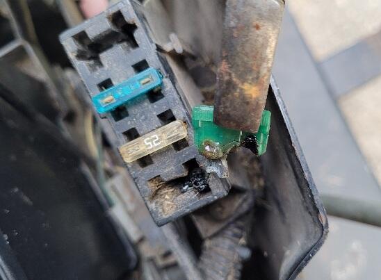

Jrblanke 918 #1 Posted August 7, 2023 Oh boy. Nobody’s fault but my own on this one. I bought this tractor about 5 years ago and parked it for the next 4 years. I swapped my loader over to it last year and just started using it. Of course I changed the fluids, and I blew the grass out of the engine and fins on the hydro, but I didn’t think about blowing the fuse block out. It ran fine for about 20 hours (over the past year), and then over the weekend, I was using it and when I tried to cut it back on, it wouldn’t turn over. The lights just flashed on the dash. I started checking fuses and found the problem pictured below. Ignorance is bliss until its not! Hahaha. Anyways, what is the most common fix for this? I poked around a bit, and It seems like I can get a factory style fuse block and connectors off amazon. Is this how most folks are fixing this? I've never wired a fuse block. 2 Share this post Link to post Share on other sites

ri702bill 11,545 #4 Posted August 7, 2023 Unplated steel terminals that rust over time. The current passing thru, teamed up with the added resistance melts the block. Very similar to the Ford Ranger 3 speed blower motor resistor and plug problem - both unfortunately are common........ 3 Share this post Link to post Share on other sites
lynnmor 8,683 #5 Posted August 7, 2023 Search for Dorman 85668, you will find prices from $3.43 and up. The contacts are plain brass, so use an anti-oxidant like NO-OX ID. Be sure to cut the connector strip on the bottom side just like the original. There is a cover for the fuse block here. 4 Share this post Link to post Share on other sites

squonk 45,805 #8 Posted August 8, 2023 I would cut that block and 9 pin connector right out and get 3 waterproof fuse holders and 2 4 pin trailer connectors. Extend the wires and move everything over to the other side of the tractor to get them away from the muffler heat and for easier access. That's what I did on the 520 that I had. 3 Share this post Link to post Share on other sites

RJC1965 171 #10 Posted August 23, 2023 Just went through this on my1996 520H. Melted the 30 amp fuse. I replaced the nine pin connector and the pins I would suggest as others to ditch the nine pin and go with some weatherproof connectors. I also ran the starter wire separately so it was not in the nine pin If you choose to keep it. And definitely cut new fuse bar to separate out the pink / lights for the dash or they will stay on when you hook up the battery and not turn off. I would also pull your ignition key switch mine was very corroded and clean it up. I have not fired mine up but I feel the wiring is sorted out. 1 Share this post Link to post Share on other sites

Jrblanke 918 #19 Posted September 2, 2023 Thanks for all the help guys! I got it running in about an hour. I think I let the wiring diagram intimidate me. It was pretty simple once I got into it. I replaced the fuse block with a new one and then ran a 12 gage wire from the regulator down to the starter. I tried to ignore all the junk on the top of the motor, but ended up taking the tins off and scraping out a bunch of junk. 1 Share this post Link to post Share on other sites
