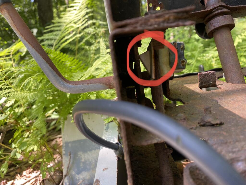

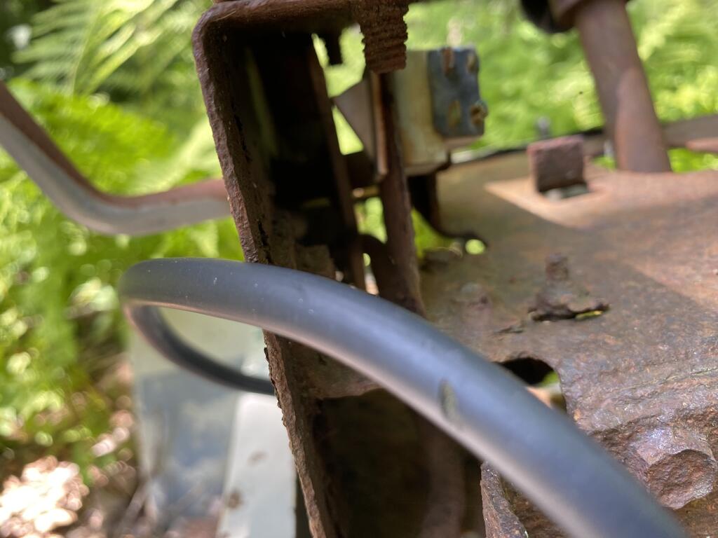

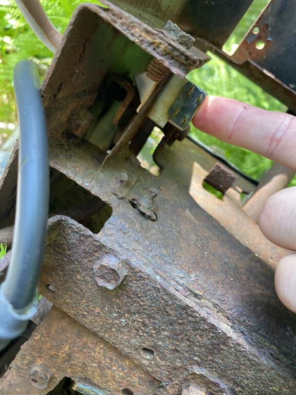

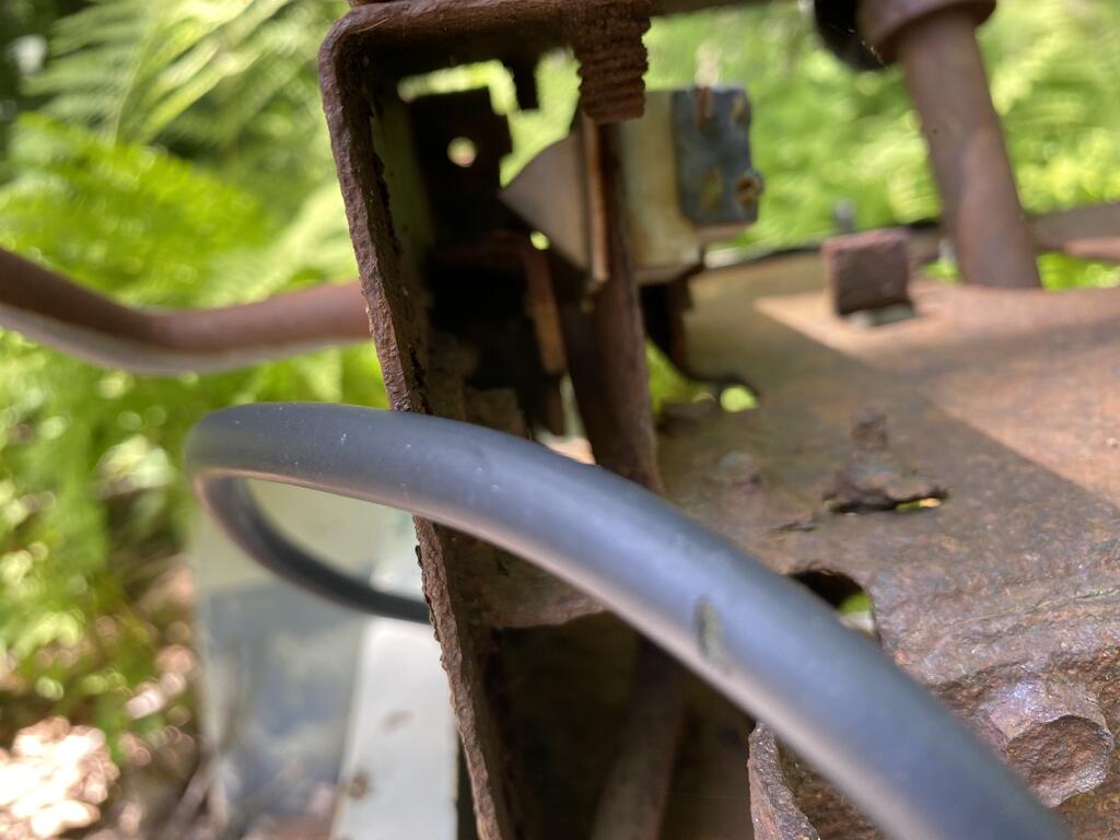

Sparky-(Admin) 26,899 #2 Posted August 6, 2023 The PTO switch probably needs to be bent closer to the PTO handle I suspect. The PTO handle simply pushes on a rocker type switch. You can see the rocker circled in red. On this parts rig where I snapped these pics, the PTO switch is mounted on a piece of metal and is easily pushed (bent) closer to the PTO lever. 2 Share this post Link to post Share on other sites
