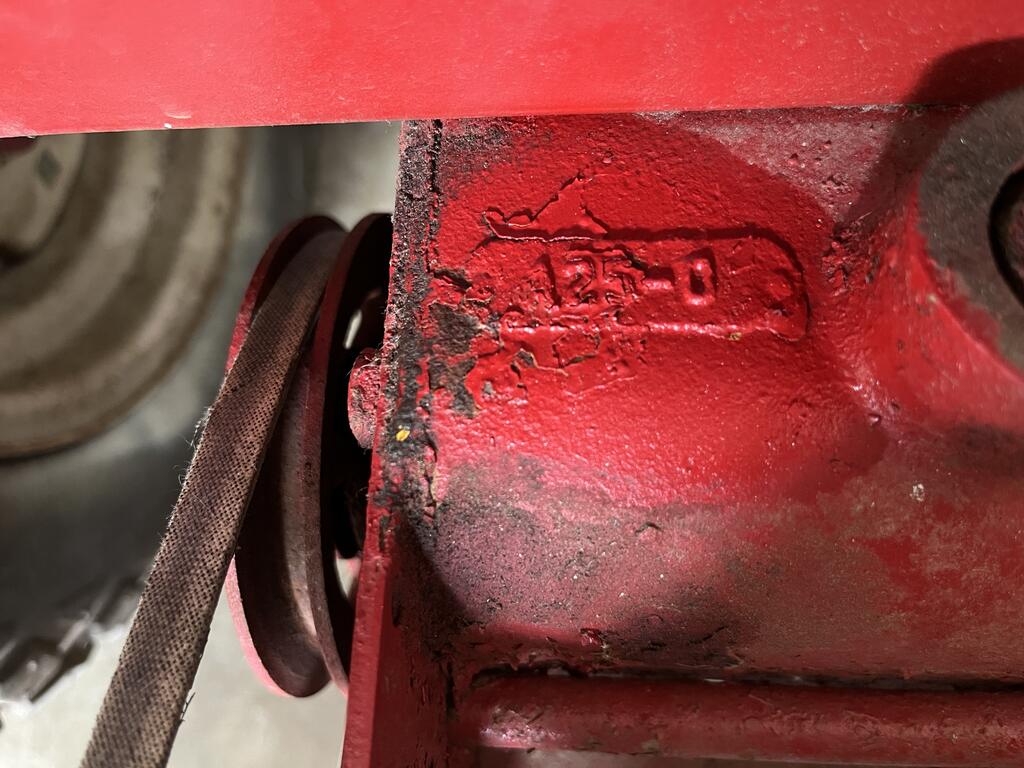

tractorchick 401 #29 Posted August 3, 2023 It looks like 125-0 Am I looking in the right place? I don't see anything in the manual with that number. 1 Share this post Link to post Share on other sites
stevasaurus 23,817 #30 Posted August 3, 2023 (edited) Kate...I think that is an A 25-0...if so...that is "A" = January 25th 1960. "A" is January...25 is the 25th day... and "0" is 1960. That means you have a #5010. I still want to see how the brake band is mounted...that is the test. The #5003 is the right transmission for the RJ-58. The #5010 is the right transmission for the 1960 & 1961's. OK...that being said...I still want to see how that side plate looks with the brake band mount. That means a lot about how the linkage is fabricated. Don't worry about what Wallfish is saying yet. There is only about 5 of us on Red Square that can see through the casting to see what is inside. The early #5003 had a mushroom gear that was an 8 tooth upper and 44 tooth bottom. The bull gear matched the 8 tooth upper. This was a weak situation and Wheel Horse changed that tooth configuration to the popular 11/44toothed mushroom gear and a different bull gear to match. In the #5010's, they kept the 11/44 mushroom gear and the bull gear, but they changed the bull gear to a bolt on to the differential and they changed the brake drum shaft outer bearing to a needle bearing. They also changed the brake band mount to a 45 degree angle and changed the push linkage to the pull linkage we see in the suburban's. That changed how the linkage worked the tension pulley. I would not worry about any of this really-at the moment. Show me the brake band mount...that is the clue we need to know. Let's not worry about the inside of the trans right now. This all depends on how correct you want to make this. Edited August 4, 2023 by stevasaurus 1 3 1 Share this post Link to post Share on other sites

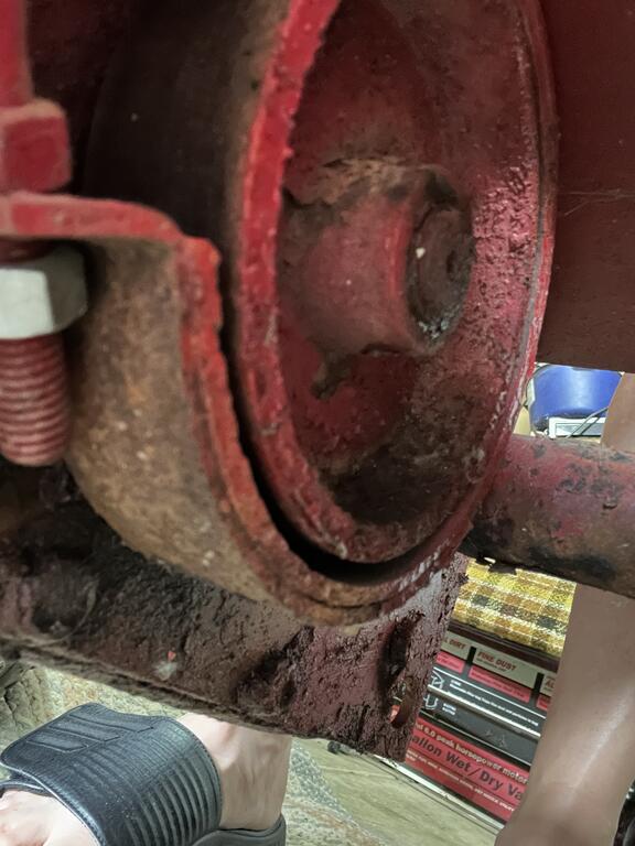

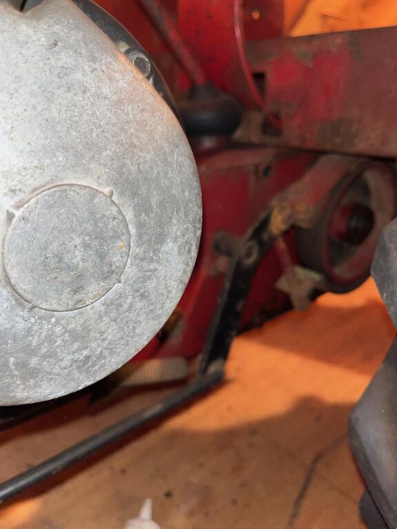

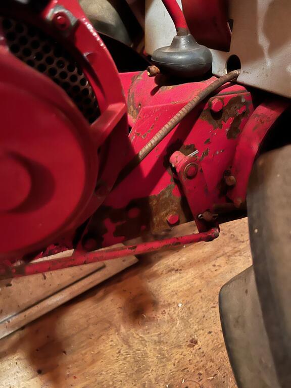

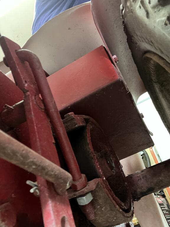

tractorchick 401 #41 Posted August 10, 2023 Believe it or not.... there are collectors of other brands who are extremely critical of not having the correct parts on a machine. UGH! I don't want to be one of those people! Yes, I will enjoy it no matter what pieces or parts are right or wrong. But I did get some more photos. I don't know if this is what you are looking for: For sure I need to get in there and clean up. 2 Share this post Link to post Share on other sites

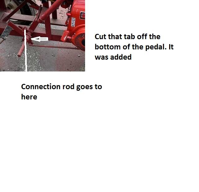

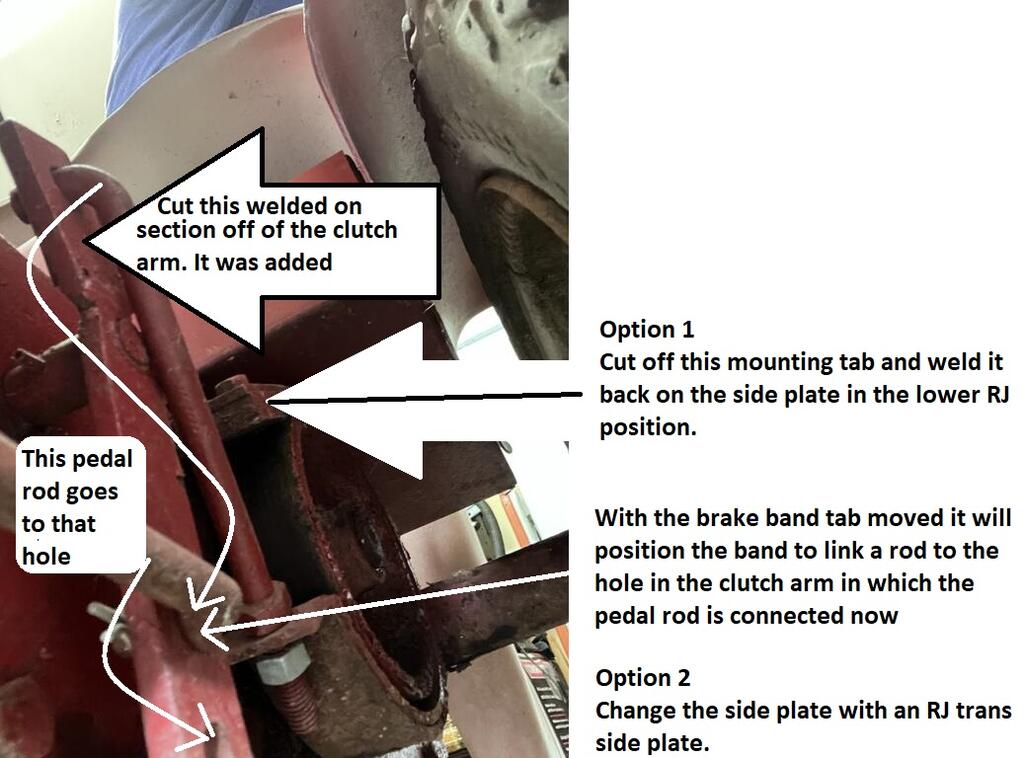

wallfish 20,564 #42 Posted August 10, 2023 (edited) 2 hours ago, tractorchick said: I don't know if this is what you are looking for: He was looking for that tab on the trans that holds the brake band. It is at a 45 deg angle and not 90 deg like an RJ. It's a 1960 Suburban trans. Modified pedal and modified clutch arm to try and make it work like a Suburban does. The RJ was a little different in the set up. Doesn't look too bad to reverse those mods. I'll edit some of your pics to show you what you can do to get it closer to an RJ and then you can find an RJ trans at your leisure until the right one is found or if you even wish to. One thing about WH (and especially the early models) is WH themselves kind of modified some stuff as they went along. Here's an RJ brake band and arm. Notice the mounting tab for the brake band is in a different location. Lower and a different angle. Nothing on the clutch arm above the 3/8 rod the arm is on that goes to the belt side idler pulley 1960 400 Suburban trans brake band and clutch arm Edited August 10, 2023 by wallfish 3 1 Share this post Link to post Share on other sites
wallfish 20,564 #43 Posted August 10, 2023 Of coarse replacing the trans would (Might) be the best option. Couple of changes to make that trans work like an RJ. Not too difficult to do 3 Share this post Link to post Share on other sites
tractorchick 401 #45 Posted August 11, 2023 Soooo...... I don't have a cutter or a welder. I have an impact wrench and various tools from the church thrift store. But I'm going to print this off and study it. I am grateful to you for the terrific suggestions and photos. I am a visual person, so that is just perfect for me! I think when I take it apart, it will be clearer. I think it will just stay as is as far as the transmission goes at least for the time being. I'll keep you all posted! 2 1 1 Share this post Link to post Share on other sites
wallfish 20,564 #46 Posted August 11, 2023 (edited) Ah, we're going to need to get you some tools or help out. You should be able to run that trans the way it is mow but it won't take an RJ belt guard. I'd say get it running and driving like it is and fall in love with it !!!! Then the nurturing to get it more "factory" may occur. Change the engine and use a 2.5" A (1/2") belt pulley on it. https://www.tractorsupply.com/tsc/product/phoenix-standard-a-type-3-4-steel-drive-pulley-2-1-2-in-od That flat idler should be changed to a 1/2" groove idler too if using like it is. This is the smallest one I could find doing a quick search https://www.ebay.com/itm/126042547369?hash=item1d58b8a4a9:g:GHwAAOSwlW1kz9Bz&amdata=enc%3AAQAIAAAAwNnwnqGyIk0ToseQRw6hZIW2o%2FsviLDGr9PvLmjS0sqK%2FOwU1G71TP2ofusfZfjrP4ytzwEvliQ%2FnhvmGy6CMG7rYlxT9Z2mpZPRKiWTF%2Bk3UgpRE%2BL4kjt%2FV7e06DQ2lgaK385mf1eGEYbtba8W59W2hEiVUsTQkM%2B2JzTo9rfWVyIvWTvr8oII6vrS3NW7vZvjnj5r7KPHwr9APiKQaHAYJHQaOcyo1oJ4pJYSurcwJW%2FcqF%2FU7kwYGXyRo%2FpkMQ%3D%3D|tkp%3ABk9SR5rKiKK8Yg Once you have the engine and pulleys going, we can help you to get the belt to slip for clutching so the gears don't grind while shifting without the need for a suburban belt guard. But the belt will be open We work on them right there in the field at the big Wheel Horse show if you find you can make it back there. Might be able to find all the stuff you need to "factory it" right there from the vendors too. So that's another option Edited August 11, 2023 by wallfish 3 Share this post Link to post Share on other sites
