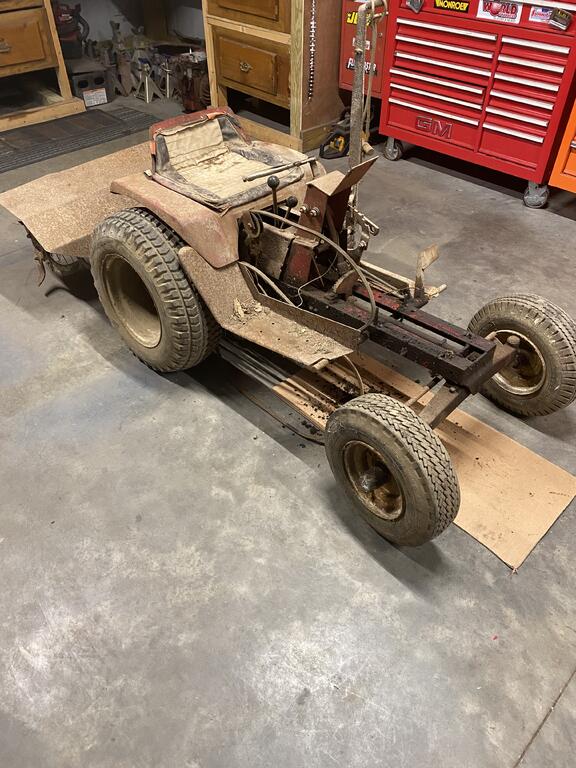

tractorchick 400 #1 Posted August 2, 2023 I bought this unit and as soon as I saw it I knew I'd paid too much. Now I am struggling with keeping it, knowing I will have to put quite a bit of money into making it all correct. One of the rear tires is bad. The transmission isn't correct. The hood has been repaired and is riveted near the gas cap, and has dents in the front. Incorrect engine, seat not right, and it needs the shields. I am so disappointed. I bought it based on photos. The people I bought it from are good people, but they are not Wheel Horse people, so I can only blame myself, not them. On a good note, Myron Miller gave me a much better steering wheel because the one on this tractor is bent. I have an engine that will work with this, but knowing that I have to replace the transmission......that is what really got me. Just ranting. It's in my garage and I look at it every day and cringe every time. I keep going back and forth on whether to cut it loose, or just accept the fact that I'll just need to accumulate parts over time and hope it's complete someday. I'd appreciate some thoughts on this from y'all. Thanks-- Kate 3 3 Share this post Link to post Share on other sites
ML3 2,150 #2 Posted August 2, 2023 Maybe just keep it as is & use/enjoy it?? As time goes by you can accumulate parts if you want to restore it. I bought an RJ & rusty Suburban as a pair back in January. Hood on RJ has been trimmed but I knew that. I'm doing a light restoration on RJ for now to get it up & running. After I get it going I'll start looking for a complete hood & anything else I need. The Suburban is going to be a rat rod theme. Interested in selling your RJ as it is??? 3 Share this post Link to post Share on other sites
peter lena 9,757 #3 Posted August 2, 2023 @tractorchick think its obviousely a unique piece , have recently sold off some of my extra pieces , went thru the whole , love / insure it goes to the right person, etc, feeling .having said that , if you did sell it , would that let you get something else to replace it ? I,M at the stage of not needing more , so its easier , but concern still lingers of any of my past equipment is sitting outside , totally negelcted , something I would not do . understand where you are coming from , pete 2 Share this post Link to post Share on other sites
Pullstart 68,848 #4 Posted August 2, 2023 If it were mine, I’d enjoy it and understand that they don’t make ‘em like that anymore Some people gamble at the casino and walk away with nothing but an empty wallet. My form of gambling at least assures me something at the end of the day! 7 1 Share this post Link to post Share on other sites
squonk 45,476 #5 Posted August 2, 2023 Just curious, what's incorrect about the transmission? 2 Share this post Link to post Share on other sites
stevasaurus 23,606 #6 Posted August 2, 2023 Well, you could look to put a tube in the rear tire. Same question as Squonk on the trans. If it is the #5010 instead of the #5003, you would just need to change the brake side plate to one with the brake mount vertical and redo the linkage. I am pretty sure you know Lane Ralph @Lane Ranger , he is not to far from you and he may be able to help with correct parts. 5 Share this post Link to post Share on other sites

tractorchick 400 #10 Posted August 2, 2023 3 hours ago, squonk said: Just curious, what's incorrect about the transmission? I was told that it's not the correct transmission. But I guess if it works, then it doesn't matter. Maybe I am over-thinking this. 4 Share this post Link to post Share on other sites
tractorchick 400 #11 Posted August 2, 2023 You have helped me see it in a different light. Right now I can put the new steering wheel on and install the right engine and enjoy it. I'm overthinking it and am being hard on myself for what I paid for it. It will be a nice addition to my 401, Snoopy 854, and 500 Special. I'll keep you posted. I need to churn on it a bit more. I appreciate all of your responses. What a great group! 4 5 1 Share this post Link to post Share on other sites
stevasaurus 23,606 #12 Posted August 2, 2023 (edited) Kate, put a pic of the brake drum and band on here. If the mount for the band is vertical, it is the right trans. Edited August 2, 2023 by stevasaurus 3 Share this post Link to post Share on other sites

wallfish 19,249 #15 Posted August 2, 2023 There are cast numbers on the top of the trans right near the shifter. Maybe post those to date the trans and the position of the tab like Steve wrote could help us figure out what's going on with it. The pedal linkage was changed push instead of pull so I'm guessing the trans is from a 60/61 suburban. Certainly not the end of world and only collectors would know the difference. Putting a Kohler K91 or Clinton B1290 engine would certainly make it look better. Repop belt guards and heat shields do show up from time to time. That one looks better than my 2 RJs 7 Share this post Link to post Share on other sites

Achto 30,955 #17 Posted August 3, 2023 (edited) 6 hours ago, tractorchick said: I was told that it's not the correct transmission. But I guess if it works, then it doesn't matter. Maybe I am over-thinking this. The early transmissions had courser mushroom & differential gears in them than the newer ones did. If it has a newer Suburban tranny, maybe it is new enough to have the updated gears. This would be a good thing in my book. Heck, I'm younger than that tractor is and I don't even have all my original parts. Personally I would keep it & enjoy it. Edited August 3, 2023 by Achto 3 5 1 Share this post Link to post Share on other sites

tractorchick 400 #21 Posted August 3, 2023 16 hours ago, wallfish said: There are cast numbers on the top of the trans right near the shifter. Maybe post those to date the trans and the position of the tab like Steve wrote could help us figure out what's going on with it. The pedal linkage was changed push instead of pull so I'm guessing the trans is from a 60/61 suburban. Certainly not the end of world and only collectors would know the difference. Putting a Kohler K91 or Clinton B1290 engine would certainly make it look better. Repop belt guards and heat shields do show up from time to time. That one looks better than my 2 RJs I'll get some better photos this weekend when I can roll her out. Joe Papke told me he has some repop shields so I am going to get what I can from him. IDK if he is on here, but he is a WH collector in northern IN. I've got both engines, not sure which will be the cleaner of the two and the beans are blocking the entrance, so I'll take a look after harvest. 2 Share this post Link to post Share on other sites

tractorchick 400 #24 Posted August 3, 2023 18 hours ago, stevasaurus said: Kate, put a pic of the brake drum and band on here. If the mount for the band is vertical, it is the right trans. Will do! It's raining here today, but I'll roll her out this weekend and get some pics! 1 Share this post Link to post Share on other sites
