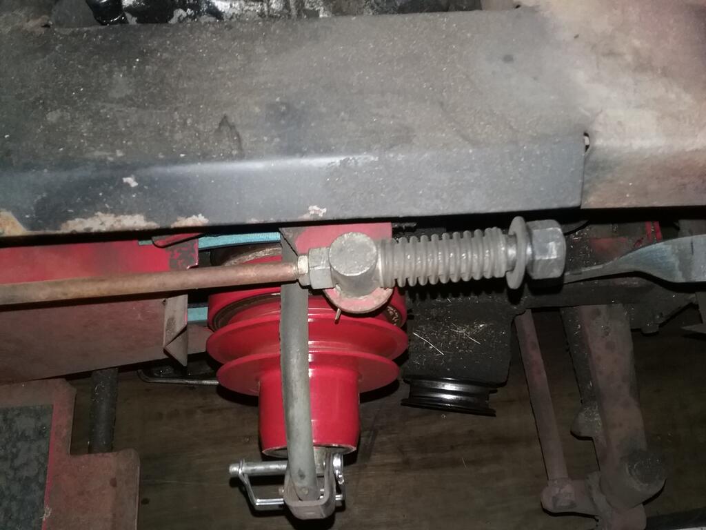

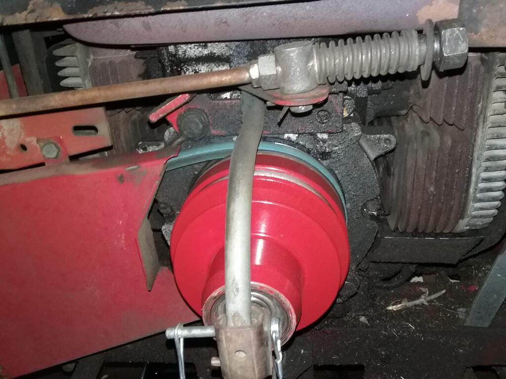

8ntruck 9,296 #5 Posted August 3, 2023 Here are pictures of my C-195 PTO clutch and linkage. Hope they help: Share this post Link to post Share on other sites

muz123 1,193 #7 Posted August 3, 2023 19 hours ago, 8ntruck said: Here are pictures of my C-195 PTO clutch and linkage. Hope they help: Soo, it appears that I do not need that end bracket that is originally installed there for the PTO to engage? Share this post Link to post Share on other sites
8ntruck 9,296 #8 Posted August 3, 2023 Well, all I can say is that the PTO clutch on my tractor was incomplete when I got it. I replaced the PTO bell, a couple of roll pins and the hitch pin. It works fine for me as is. I suppose I should open the parts diagram back up and see what I am missing from factory stock. There was originally a brake on the PTO bell to stop it quickly when it is disengaged. Those parts are missing on my tractor and may be the parts you are asking about. 1 Share this post Link to post Share on other sites
8ntruck 9,296 #9 Posted August 4, 2023 (edited) Yup. I think your bracket is the PTO brake. Find a copy of the Toro parts diagram for the C-195 PTO assembly. Without that diagram the rest of this description is worthless. I did a Google search on 'toro c-195 parts diagram' and ended up picking one of the parts tree sites that listed c-195 PTO clutch and control parts diagram. I'm guessing that your bracket is detail #23 in that diagram. It is held on by details 49,50, 42 through the front hole on detail 25. If you look closely at the first picture I posted, you can see an empty hole in the bracket bolted to the engine just above the pulley. That is where your bracket bolts on. With the spacers and bushings, the bolt should be tight and the bracket should rotate on the mounting bolt. The slot on the top of your bracket goes around the rod going back to the PTO lever. The bracket should end up between washers that are between the front end of the spring on the rod and the nut on the front end of the rod. Edited August 4, 2023 by 8ntruck 1 Share this post Link to post Share on other sites
