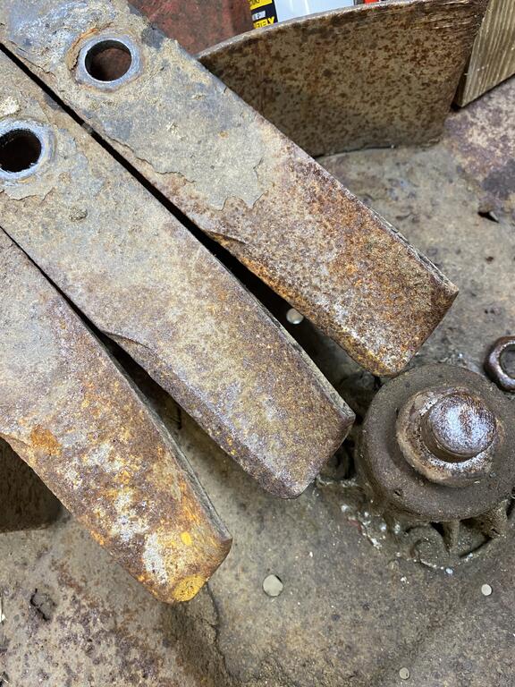

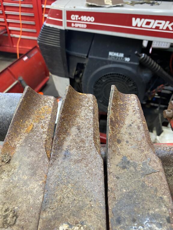

Sparky-(Admin) 26,493 #1 Posted July 31, 2023 When do we condemn mower blades? Dismantling a junk 42SD and I assumed these were junk but maybe not… can these still be sharpened? 1 Share this post Link to post Share on other sites
rjg854 13,404 #2 Posted July 31, 2023 I'd say yes, seems to be a lot of blade left. 5 1 Share this post Link to post Share on other sites
Sparky-(Admin) 26,493 #3 Posted July 31, 2023 3 minutes ago, rjg854 said: I'd say yes, seems to be a lot of blade left. Thanks! 1 Share this post Link to post Share on other sites
Ed Kennell 47,595 #4 Posted July 31, 2023 (edited) Yes, they can be sharpened, but they are all ready a tad shorter than when new. May leave a streak in turns. Edited July 31, 2023 by Ed Kennell 3 1 Share this post Link to post Share on other sites
squonk 48,215 #5 Posted July 31, 2023 You can 2 things with them. E tank them and sharpen and they will still cut like Ed says. OR Use them for anodes in an E tank 1 1 Share this post Link to post Share on other sites
TonyToro Jr. 2,547 #6 Posted July 31, 2023 Yes, you got a lot more sharpening’s out of those and alot more cutting. You can tell if there no good if the lift on the blade on the corner if it is really thin or rub your finger around the edge and if there’s a like ridge they are no good. 1 1 Share this post Link to post Share on other sites

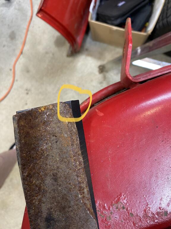

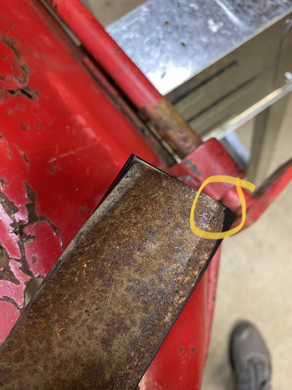

Sparky-(Admin) 26,493 #7 Posted July 31, 2023 47 minutes ago, Ed Kennell said: Yes, they can be sharpened, but they are all ready a tad shorter than when new. May leave a streak in turns. Ed, are you talking about the corners I have circled in yellow? These are the old blades laid directly on top of a brand new one. 1 Share this post Link to post Share on other sites

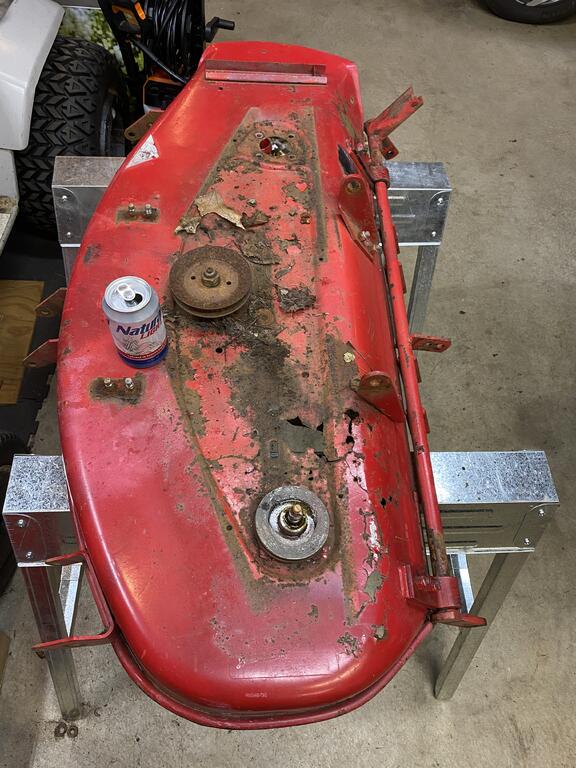

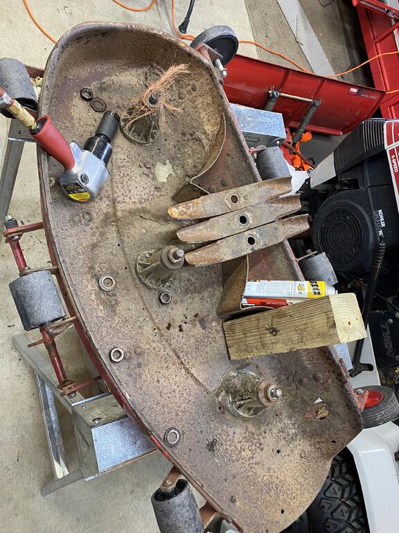

Sparky-(Admin) 26,493 #9 Posted July 31, 2023 13 minutes ago, peter lena said: @Sparky when ever I touch up a blade, I use small fine file , minimizes metal loss , always use a cutting oil with it , does agood job , you going to oil treat that deck ? kill off the grunge and help the deck out . if you establish a lubricant finish , and leave oil on it over winter , upside down , it will soak in place for months , pretty simple , mine are stained oil / grease black , just a suggestion . pete This one can’t be brought back with any oils on the market Pete @peter lena …she’s never going to mow again. Next stop will be the town transfer stations scrap metal dumpster. The plan here is to strip what’s still good and use those parts to keep a solid deck going. 2 Share this post Link to post Share on other sites

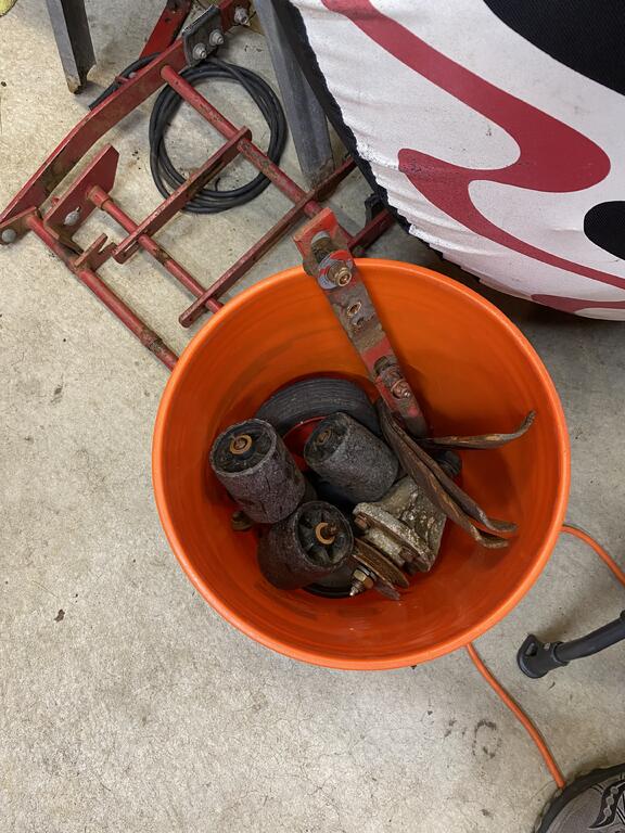

Sparky-(Admin) 26,493 #10 Posted July 31, 2023 One spindle pulley will need to soak to get it off in the next day or two. But she is essentially stripped with the good stuff in a bucket. Gotta stop workin in shorts (Pullstart style !) … one of my knobby knees took a hit. 1 1 Share this post Link to post Share on other sites
ri702bill 13,189 #11 Posted July 31, 2023 Mike - they are still worth the time to clean them up and resharpen. Yes, they are worn - but - I do not see any cracks, broken out areas, etc. Worth redressing as a second set spares, or a first set on a used deck for sale..... 2 Share this post Link to post Share on other sites

Shynon 7,723 #14 Posted August 1, 2023 3 hours ago, Sparky said: Ed, are you talking about the corners I have circled in yellow? These are the old blades laid directly on top of a brand new one. the rounded corners need to be squared off, otherwise grass just rolls passed without cutting 1 1 Share this post Link to post Share on other sites
Rick3478 470 #15 Posted August 1, 2023 2 hours ago, Shynon said: the rounded corners need to be squared off, otherwise grass just rolls passed without cutting Yeah, in fact the tips do most of the work, which is why they wear away and get rounded like that. 1 Share this post Link to post Share on other sites

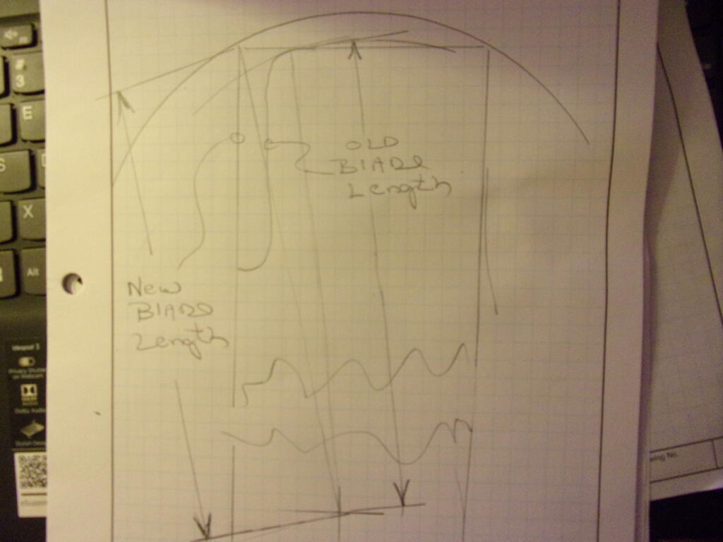

Ed Kennell 47,595 #16 Posted August 1, 2023 5 hours ago, Sparky said: Ed, are you talking about the corners I have circled in yellow? Exactly Mike. Although the old blades are as long as the new blades, The effective cutting length must be measured from the center of rotation to the fartherest point on the blade. It looks like the old blades will measure about 1/4" shorter than the new blades. Here's a crude not to scale sketch to show how the cutting circle decreases in size. c 3 1 Share this post Link to post Share on other sites
Rick3478 470 #17 Posted August 1, 2023 18 hours ago, Sparky said: I've seen worse. When you start getting into the upturned wing area, it's time to retire them. 2 1 Share this post Link to post Share on other sites
Bill D 3,168 #18 Posted August 12, 2023 On 7/31/2023 at 6:29 PM, Sparky said: One spindle pulley will need to soak to get it off in the next day or two. But she is essentially stripped with the good stuff in a bucket. Gotta stop workin in shorts (Pullstart style !) … one of my knobby knees took a hit. I hope you saved the gauge wheel bar. I used one like that for a custom deck build. Share this post Link to post Share on other sites
c-series don 12,519 #19 Posted August 12, 2023 I have several decks like @Sparky does if anybody wants them for parts. I have enough used spindles and parts already and probably will never strip the decks I’d like to give away. Shame but some day I’ll get sick of looking at them and throw them away. Share this post Link to post Share on other sites
Sparky-(Admin) 26,493 #20 Posted August 13, 2023 On 8/12/2023 at 12:31 AM, Bill D said: I hope you saved the gauge wheel bar. I used one like that for a custom deck build. Nope…it went into the scrap metal dumpster with the shell. I know I won’t ever build a custom deck. 1 Share this post Link to post Share on other sites
