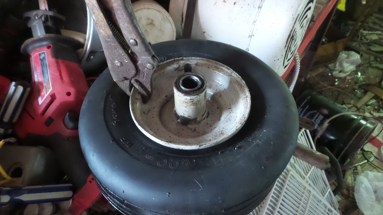

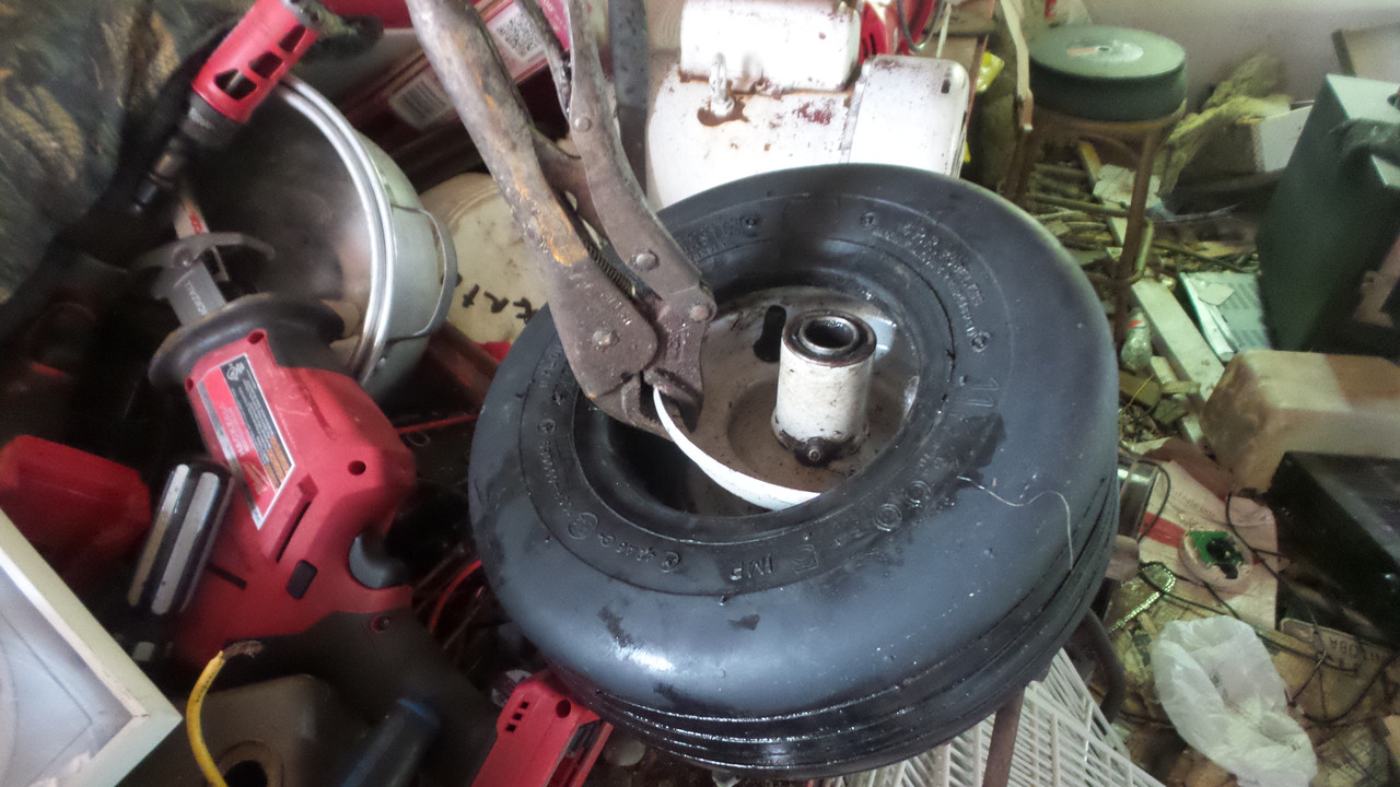

bc.gold 3,406 #1 Posted July 24, 2023 (edited) No explanation required. Image number two says it all, rim held in bench vice. Edited July 24, 2023 by bc.gold 6 1 Share this post Link to post Share on other sites

bc.gold 3,406 #3 Posted July 24, 2023 9 minutes ago, peter lena said: @bc.gold looks old school to me , get er done , pete Showing my age. Took me longer to find a vice grip than it did installing the tire. 1 Share this post Link to post Share on other sites
8ntruck 8,478 #4 Posted July 24, 2023 That solution is so obvious and simple. I'm kind of embarrassed I didn't think of it. Share this post Link to post Share on other sites
ri702bill 10,973 #5 Posted July 24, 2023 I have used an old 6" C clamp to pinch the tire into the recess of the rim as i work the second bead into place... with good results. 1 Share this post Link to post Share on other sites
bc.gold 3,406 #6 Posted July 24, 2023 (edited) 15 hours ago, ri702bill said: I have used an old 6" C clamp to pinch the tire into the recess of the rim as i work the second bead into place... with good results. Edited July 25, 2023 by bc.gold Share this post Link to post Share on other sites
Lee1977 7,506 #7 Posted July 25, 2023 10 hours ago, bc.gold said: Showing my age. Took me longer to find a vice grip than it did installing the tire. I've used that method quite a few time on 4" and 8" wheels I also clamp a bar in the vice to hold the rim. Share this post Link to post Share on other sites
bc.gold 3,406 #8 Posted July 25, 2023 (edited) 10 hours ago, Lee1977 said: I've used that method quite a few time on 4" and 8" wheels I also clamp a bar in the vice to hold the rim. Edited July 25, 2023 by bc.gold Share this post Link to post Share on other sites
John2189 561 #9 Posted July 27, 2023 On 7/25/2023 at 12:21 AM, Lee1977 said: I've used that method quite a few time on 4" and 8" wheels I also clamp a bar in the vice to hold the rim. I use a piece of threaded rod with a couple of washers and nuts in the vise 1 1 Share this post Link to post Share on other sites
