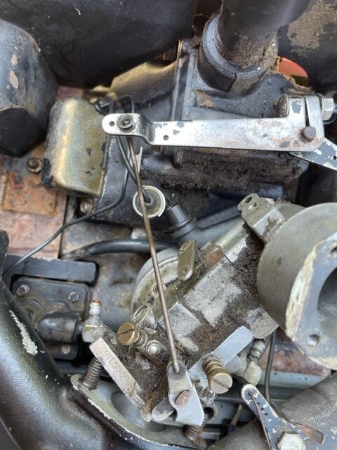

Dreamcatcher 102 #1 Posted July 23, 2023 Hello All, I am finally getting around to putting new fuiel lines and cleaning the carb on my 417 A. Looks like the previous owner has 5/16 inch fuel line but per what I found on the forum, these should be all1/4 inch fuel line. I've purchased a good amount of clamps and line. I I'm having trouble figuring out this last linkage on the carb so I can physically remove it from the motor. It had not just bits of stuff in the bowl but black chunks. I i'd like to remove it to give it a better cleaning that just a sprayout of the bowl and float area. Thanks in advance for your suggestions. Share this post Link to post Share on other sites
ineedanother 1,814 #2 Posted July 23, 2023 That linkage should just pop down out of the governor arm. They a bit of friction fit and I always keep some of those plastic keepers in the shop for when they need to be replaced. The black chunks in the bowl would be fuel line that's deteriorating from the inside. Smaller bits are surely elsewhere in the carb. This is why it is good practice to put your fuel filter as close to the carb as you can. 1 Share this post Link to post Share on other sites

Dreamcatcher 102 #4 Posted July 23, 2023 19 minutes ago, ineedanother said: That linkage should just pop down out of the governor arm. They a bit of friction fit and I always keep some of those plastic keepers in the shop for when they need to be replaced. The black chunks in the bowl would be fuel line that's deteriorating from the inside. Smaller bits are surely elsewhere in the carb. This is why it is good practice to put your fuel filter as close to the carb as you can. I realize the linkage is pretty springy and durable but are you saying that I can be a little forceful with it and it should pop out of the hole? Any special angle needed? Also does anyone have an opinion on the 5/16 back to 1/4 inch fuel line swap? Share this post Link to post Share on other sites

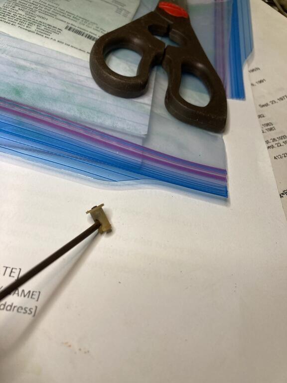

ineedanother 1,814 #6 Posted July 23, 2023 17 minutes ago, Dreamcatcher said: I realize the linkage is pretty springy and durable but are you saying that I can be a little forceful with it and it should pop out of the hole? Any special angle needed? Also does anyone have an opinion on the 5/16 back to 1/4 inch fuel line swap? Right. Here is a picture of one on the bench if you can zoom in and see how the linkage is held in 1 Share this post Link to post Share on other sites
JCM 10,415 #7 Posted July 23, 2023 3 hours ago, ebinmaine said: @JCM Jim we've messed with these. Do you remember how that comes off? I would have to look at the 417 or 420 to be sure. Thought it might be a z bend ? 1 Share this post Link to post Share on other sites
ineedanother 1,814 #8 Posted July 23, 2023 58 minutes ago, JCM said: I would have to look at the 417 or 420 to be sure. Thought it might be a z bend ? It may very well be on the throttle lever end, but the governor end definitely doesn't look to be a z bend and should just pry out of that lever. 2 Share this post Link to post Share on other sites
Dreamcatcher 102 #9 Posted July 24, 2023 Thank you all. the linkage just popped off with a little more mustard. I changed all of the fuel lines and the petcock under the tank. The petcock was leaking. I sprayed out the carb well especially the bowl and float area. The bowl seal is not great looking. Does anyone know the part number for the seal? 2 Share this post Link to post Share on other sites
