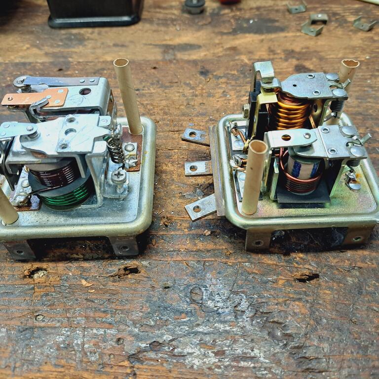

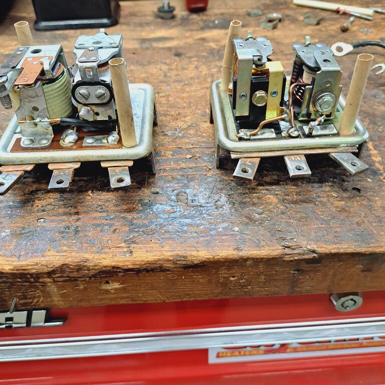

WHX?? 57,461 #26 Posted July 24, 2023 (edited) Regulator... the one that was on it from @Pullstart looked good but check out the pics. Was labeled as a Borg-Warner. Not nowheres near hi test like a crusty Delco which I had out in the parts shed. Problem with the Delco was mounting was hacked. I drilled out the mounting rivets off the Borg. Soldered the ground strap on and put in on the Delco. Borg went in the round file. Worked perfect and got it charging at just over 13. Trying to get this girl ready to go to show so couldn't wait for one to show from Pat's. Borg on the right. No adjustments & couldn't get the cutout relay to close. Edited July 24, 2023 by WHX?? 1 1 Share this post Link to post Share on other sites
