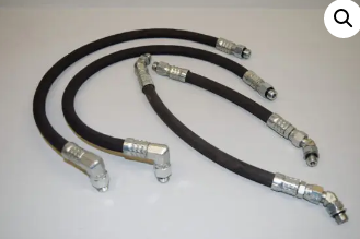

JoeM 9,317 #6 Posted July 21, 2023 9 hours ago, Doc Watts said: Does any of you folks know what he was referring to If you are talking about the hydraulic lift. I am thinking your hoses have o-ring boss fittings on the ends that screw in. #4 or #5. Not a common type. Those hoses can be purchase here https://wheelhorsepartsandmore.com/product-category/hydraulics/ 3 1 Share this post Link to post Share on other sites
pfrederi 19,268 #7 Posted July 21, 2023 Older WH hydraulics use SAE#5 ORB (O ring Boss) fittings. (Later they switched to the much more common SAE#6 ORB) The SAE#5 are near impossible to find now. Lowell has hoses with them. i doubt any local hardware or even hydro place would have them. 3 1 Share this post Link to post Share on other sites

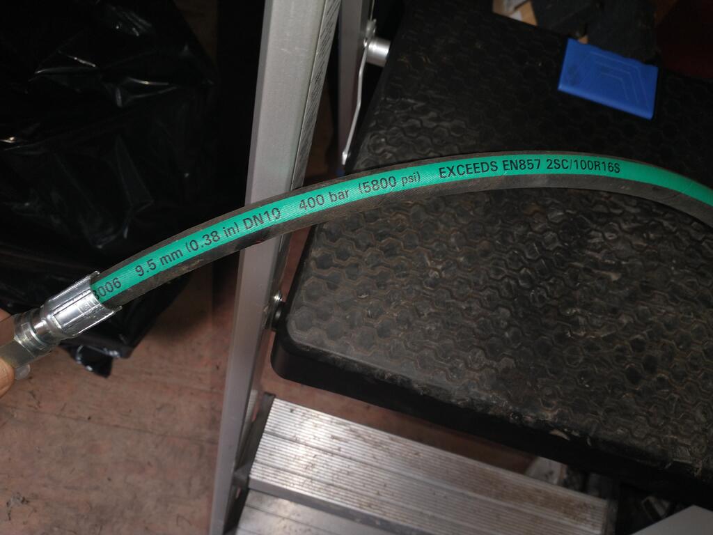

Handy Don 15,186 #10 Posted July 21, 2023 (edited) My last project caused me to spend a LOT of time and cash researching hydraulics. For straight up replacements I, too, endorse Wheel Horse Parts and More. You get exactly the right length and terminations for easy “bolt in”. Stock hoses with adaptors work a la @squonk and can save money but space is tight in our tractors so you have to be careful to fit things in! For custom stuff, PM me and I can offer suggestions. That said... Yes, the ORB #5 fittings are uncommon and with somewhat fewer options, but they are readily available from several online sources that will make custom hoses. 3-wire hose is (IMHO) radical overkill for WH tractor hydraulics which max out at around 700psi. This hose is intended for systems running at 4,000 to 6,000 psi plus it is very stiff both for bending and twisting and it is larger in diameter. 1-wire is plenty; 2-wire if you must. Edited July 21, 2023 by Handy Don 2 Share this post Link to post Share on other sites
squonk 44,860 #11 Posted July 21, 2023 (edited) I bought a set of hoses from a popular WH site for my C-160. One hose leaked in a year. Replaced it with an Eaton hose. Twice as much money. Another is seeping. I bought another Eaton hose to replace it when it really starts to leak bad. Over kill or not, I don't want leaks!(Plus when it leaks, it leaks on your shoes! ) Edited July 21, 2023 by squonk 3 1 Share this post Link to post Share on other sites

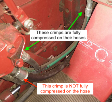

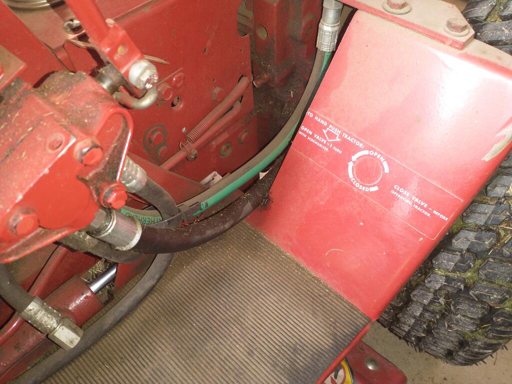

Handy Don 15,186 #12 Posted July 21, 2023 Just now, squonk said: I bought a set of hoses from a popular WH site for my C-160. One hose leaked in a year. Replaced it with an Eaton hose. Twice as much money. Another is seeping. I bought another Eaton hose to replace it when it really starts to leak bad. Over kill or not, I don't want leaks! The wire spec doesn’t address leaks in particular, only that the OD is usually larger so it might fit tighter in the maker’s “standard” fitting collar. I suspect the Eaton hoses are better put together. My experience is that the fit, quality, and installation process of the hose-end fitting are much more important. The compression collar must be correct for the hose OD, be of sufficient strength to hold its crimp, and be fully compressed by a crimping tool of adequate strength. Failure of any of these leads to premature hose leaks. 1 Share this post Link to post Share on other sites
