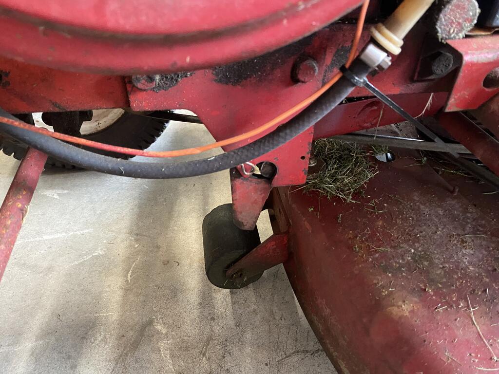

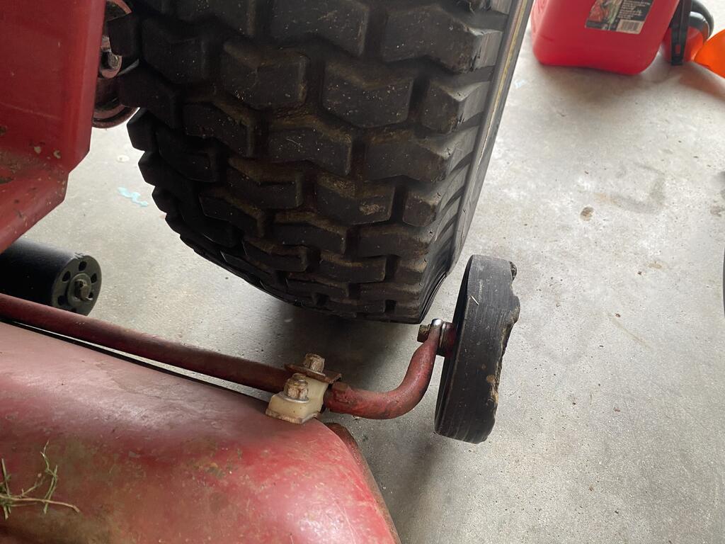

JMBoriss 21 #1 Posted July 20, 2023 I've been looking for a wheel horse for a while, to use, eventually restore and then pass down to my son. Yesterday this Wheel Horse came up on Marketplace and I picked it up for $425. I absolutely love it. Runs great, seems to have original tires and it seems to be in pretty good shape. I mowed my entire lawn and it didn't miss a beat. I've searched the forums and have downloaded all the manuals I could, however I was not able to find a user manual specific to the Raider 14, only 8,10 and 12. Questions: Does anyone happen to have a .pdf copy before I buy a hard copy off ebay of a user manual specific to the Raider 14? I'd like to lube all the moving parts, sharpen the blades, change all filters, oil etc. before my next mow. I prefer a mulching kit but I don't want to modify the deck in anyway. Any thoughts on that? However mowed great, and lawn looks great without the mulching. Please see below pictures for the next questions: When turning left, the deck shifts and the deck level wheel (that is all chewed up) rubs on the left rear tire. I assume because the front mount "rod" isn't securly in the holder? See picture. Any thoughts there? On the front manual PTO, I can't get that metal piece (that looks like a boat sail) to stay in the little metal pulley, any ideas there? Anything you experts recommend I do before continued use? I plan to keep this thing forever and thankfully I have the means and desire to put however much money into this as I want. What would you do to it if you were me? 4 Share this post Link to post Share on other sites

pfrederi 21,345 #6 Posted July 20, 2023 Deck Manual you need to tighten the engine to deck belt 1 Share this post Link to post Share on other sites

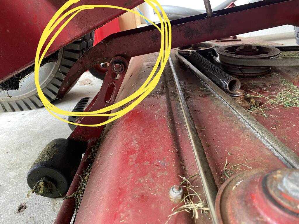

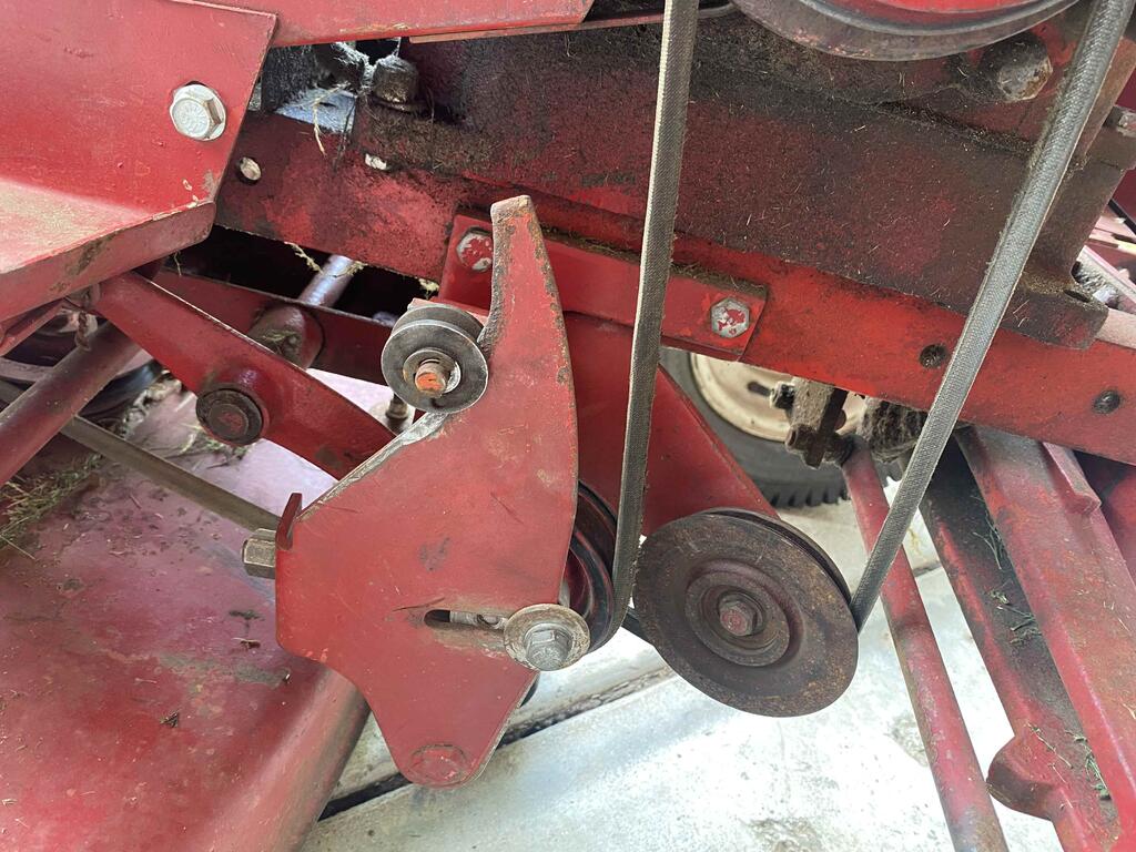

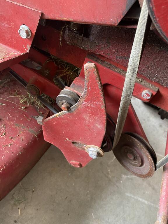

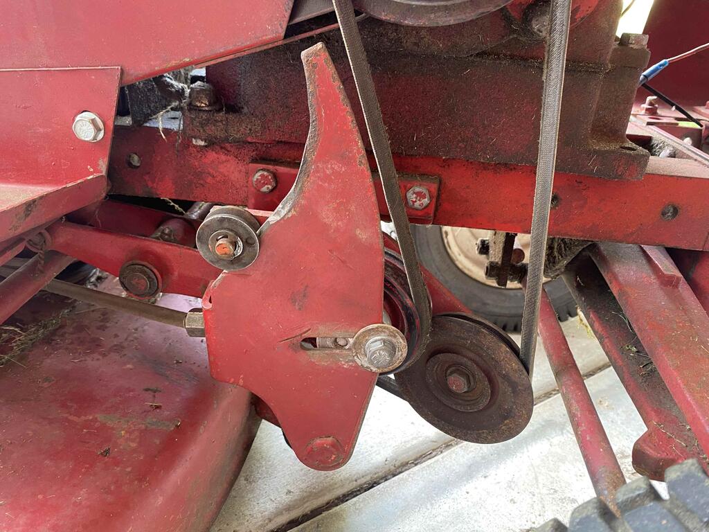

JMBoriss 21 #12 Posted July 21, 2023 (edited) I tried to tighten the belt, per the manuals and There seems to be a lot of slack in the belt even with it tightened as far as it can go. I put the deck back on, adjusted everything and still seems loose? Could the belt just be that worn and stretched? Please see pictures with mower deck raised and lowered of the cam assembly. Should the rear of the deck be above or below the slanted part. Please see picture with yellow circle drawn on it. Finally, the parking brake, no matter how I adjust it, it doesn't stay engaged. Am I missing a piece? Please see video. Thank you! Edited July 21, 2023 by JMBoriss Share this post Link to post Share on other sites

JMBoriss 21 #14 Posted July 21, 2023 Is that correct? Share this post Link to post Share on other sites
pfrederi 21,345 #15 Posted July 22, 2023 The yellow circled set up is correct. Same parking brake on my L107. Father bought it new in 1967 in 56 years have never been able to make it useful. Loose enough to engage won't hold the tractor, tight enough to hold cannot engage it with out a struggle... Looks like some sort of extra plate under the 2 bolts holding the brake band...try leaving it out... are you sure it is the correct belt??? 1 Share this post Link to post Share on other sites
JMBoriss 21 #16 Posted July 22, 2023 @pfrederi Thank you, I'll try removing that plate under the two both. Good point on the belt, no idea if it is even the correct belt at all. I'll order a new one. Can you help me confirm this: I think I have the 48" mower deck 5-1201, 5-1202. I looks like it calls for a 107" v-belt to drive the 3 blades and a 71" v-belt from the PTO. I'm new to all this, do I just order any v-belt those sizes? I may just buy the entire kit from aztractor. Share this post Link to post Share on other sites
pfrederi 21,345 #17 Posted July 22, 2023 They are both 1/2" wide belts so the Gates Belt numbers would be 6871 and 68107 Share this post Link to post Share on other sites
