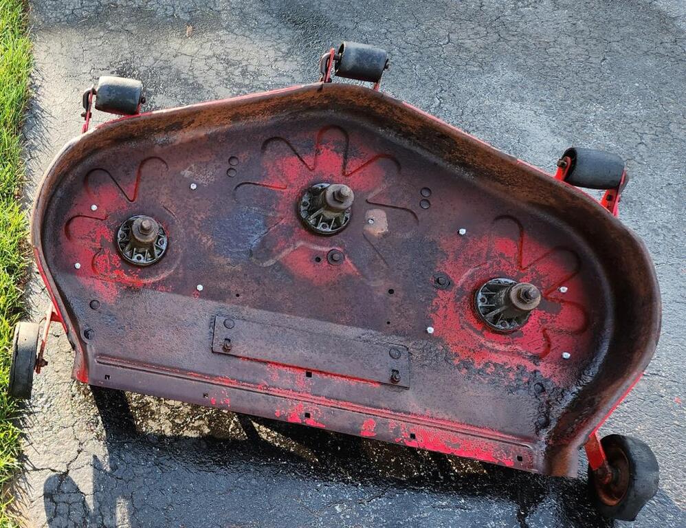

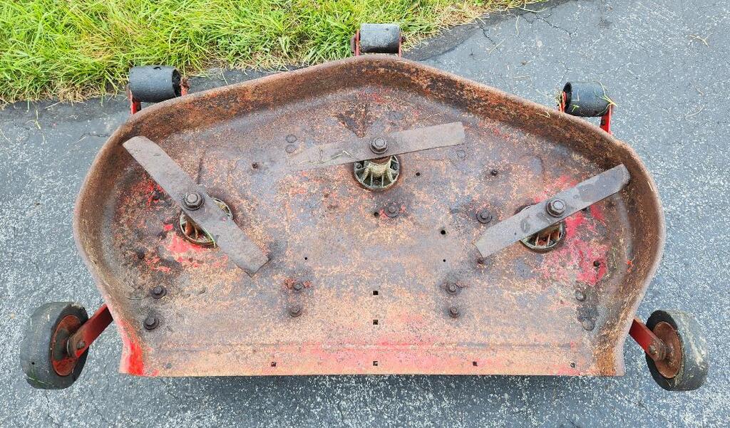

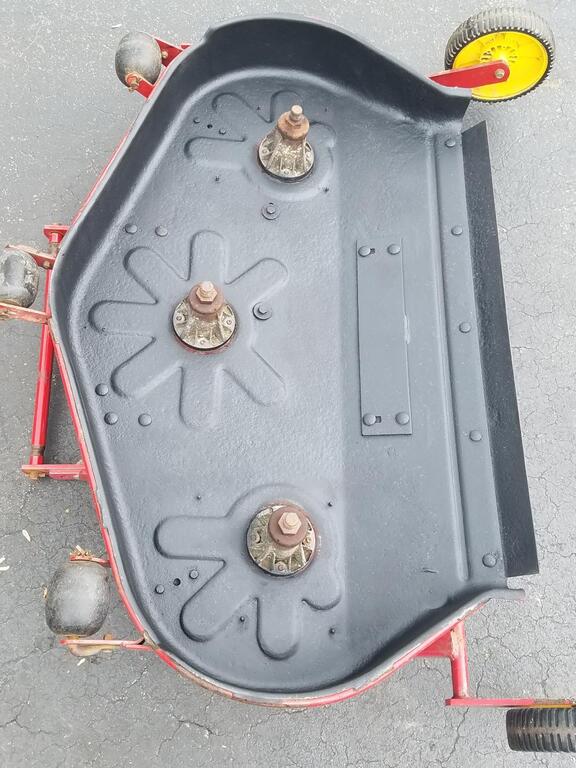

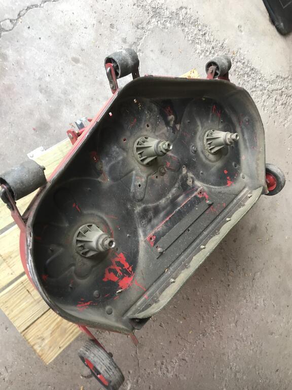

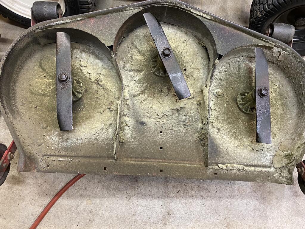

Sparky-(Admin) 26,492 #1 Posted July 19, 2023 I have a couple 42” RD decks here. Been using both and the one with baffles cuts better than the one without. So does anyone know why one has no baffles? Was it an add-on option from WH? Neither are recycler decks. Of course the no baffle deck is the one with a better shell . For experimental purposes I just swapped blades and will see if that changes anything when I mow again this weekend. 3 1 Share this post Link to post Share on other sites
WHX?? 58,302 #2 Posted July 19, 2023 Odd Sparky... got any model #s or years? Be interesting to see if the shells have different PNs. 51 minutes ago, Sparky said: Was it an add-on option from WH? Wouldn't have thought so ... aren't the baffles factory welded in? Share this post Link to post Share on other sites
squonk 48,212 #3 Posted July 19, 2023 (edited) That bottom deck looks just like my recycler deck without the insert. Edited July 19, 2023 by squonk 1 Share this post Link to post Share on other sites

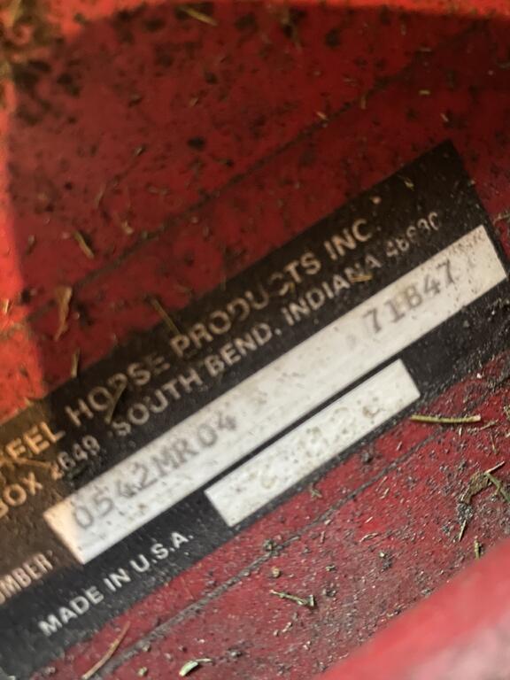

gwest_ca-(File Mod) 12,508 #5 Posted July 19, 2023 Mower DNA 1976 model 65-42MR01 replaced by - (Has the flat spindle belt idler pulley mounted on a triangular plate.) - (Has multi-link hardware at the gauge wheel support) 1977 model 75-42MR01 - Both use blades with 5/8" x 3/4" double-D center hole unless the spindles have been upgraded. (Has the flat spindle belt idler pulley mounted on a triangular plate) - (Has multi-link hardware at the gauge wheel support) ---------------------------------------------------------------------------------------------------------------------------------------------------------------------------------------------------------------------------------------------------------------- These all use blades with 3/4" center hole. 1977 model 75-42MR02 replaced by - (Has the flat spindle belt idler pulley mounted on a flat bar) (Has multi-link hardware at the gauge wheel support) 1978 model 85-42MR01 - (Has the flat spindle belt idler pulley mounted on a flat bar) (Has multi-link hardware at the gauge wheel support) 1979 model 95-42MR01 - No ipl available 1979 model 95-42MR02 - (Has no multi-link hardware at the gauge wheel support) 1980-1983 model 05-42MR01 1984 model 05-42MR02 - Last year for bearings with 3/4" ID 1985 model 05-42MR03 - First year for bearings with 17mm ID unless older spindles were updated. 1986-1988 model 05-42MR04 1989-1990 model 15-42RC01 1990-1992 model 15-42RC02 1993-2012 model 78350 Note - 17mm is .669" 1 Share this post Link to post Share on other sites
Lane Ranger 12,133 #6 Posted July 19, 2023 The recycler deck baffle was bolted in not welded. The deck Sparky has with beagles was an earlier rear discharge deck that had welded in baffles. That is what I know from the various (7 or 8) 42 inch decks I have had over thirty years. 2 Share this post Link to post Share on other sites
Sparky-(Admin) 26,492 #7 Posted July 19, 2023 This is the ID tag off the non-baffled deck: 1 Share this post Link to post Share on other sites

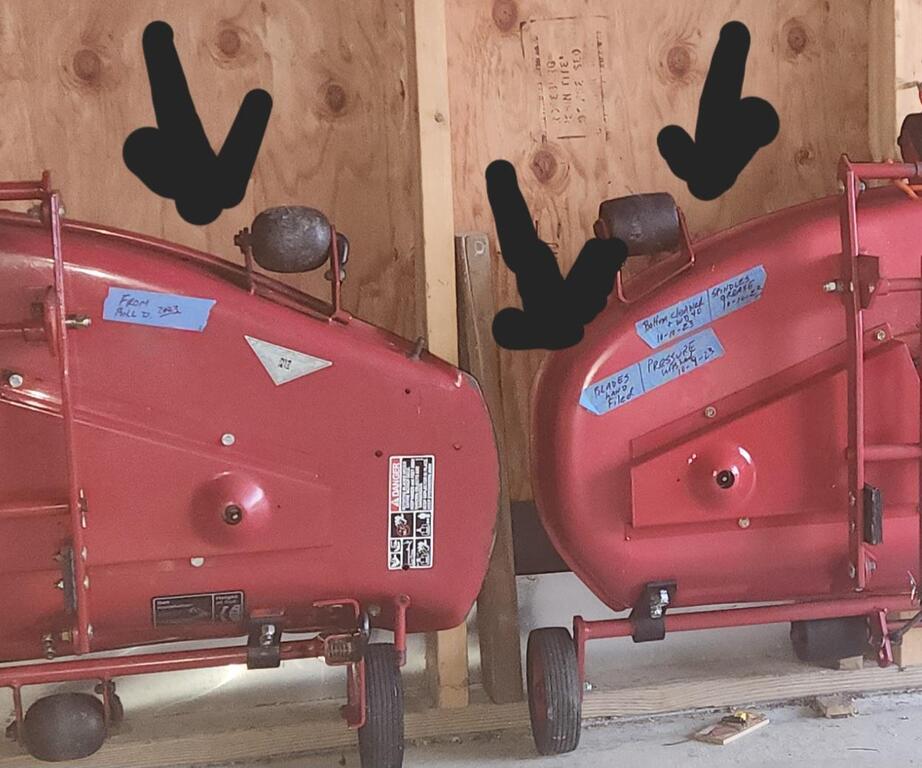

Sparky-(Admin) 26,492 #9 Posted July 20, 2023 2 hours ago, Brockport Bill said: wow - you guys must have e.s.p. - i was just going to post almost the exact same question 2 days ago about the 42 r.d. mowers -- asking about the differences in the underneath design ---- but in addition to your question about the baffles/flanges, i was going to ask about the "reinforcement plate" that's underneath that reinforces the anchor bolts that go to the back rear of the lift carriage assembly to prevent shell fractures occurring from the carriage bolt anchor stress points? i have a 42 r.d. with the baffles, but also a few different other 42 rd's - one with the plate, the other without the plate ? Even the recycler model had those reinforcment plates -actually looks like 2 plates??? Was curious any insights anyone could give??????? I was actually as a preventive maintenance to save future fractures, was thinking of adding a reinforcment plate to the 42 r.d. that does not have one? i notice the photo your display of the 42 without the baffles, has no reinforcement plate but squonks does have the plate?? I never realized there were so many differences in the 42RD… I just always assumed if it was 1973 or newer they were all the same. 1 Share this post Link to post Share on other sites
Sparky-(Admin) 26,492 #10 Posted July 23, 2023 Small update: blade swapping did not improve the way the non-baffled deck mows. All I can figure is that the baffles keep the grass “in the deck” for another blade revolution or two and that’s enough to improve its cut. No matter what though, neither RD deck is good if I delay mowing for a couple days and the grass gets a bit long. They both leave long clumpy grass behind. 2 Share this post Link to post Share on other sites

elcamino/wheelhorse 9,363 #12 Posted July 23, 2023 @Sparky I cleaned my 42 RD deck this working with the power washer so there are no pictures (I got soaked), anyway it does not have any baffles. I guess it is from the 70's no stickers. @squonk probably removed them to mess with me before I purchased the deck. All my 36" RD decks have baffles at the front. Grass gets caught in the curves and if one is not careful brown weld appears at the end of a mowing season. 1 Share this post Link to post Share on other sites
Rick3478 470 #13 Posted July 23, 2023 Without the baffles, wind from the blades will bend some of the grass over into the triangular areas between the blades along the front edge. The baffles control that wind, so all else being equal the baffled deck will make a bit more even cut. I don't think any of my RD's have baffles. My neighbor cuts his about every other day, but I let mine go until it "needs it". I might go back over bad areas a second time, but usually I just figure it's going to have to be done again anyway, and sometimes good enough is good enough. 1 Share this post Link to post Share on other sites

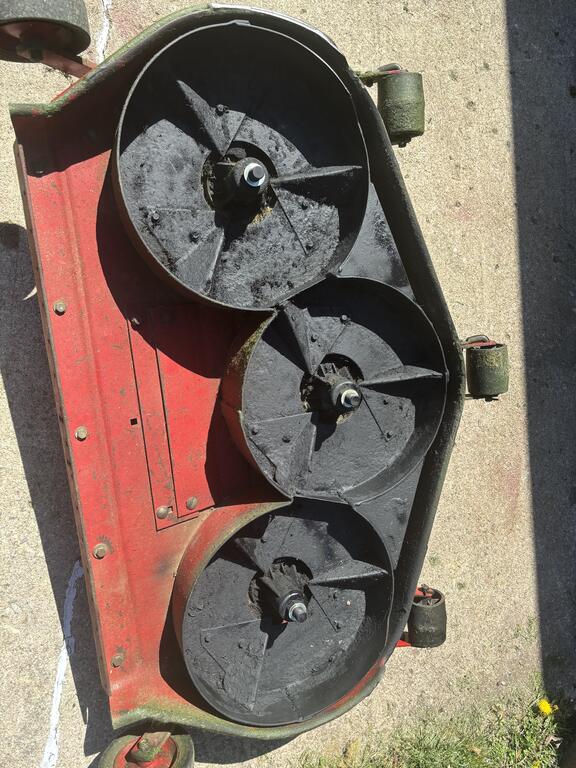

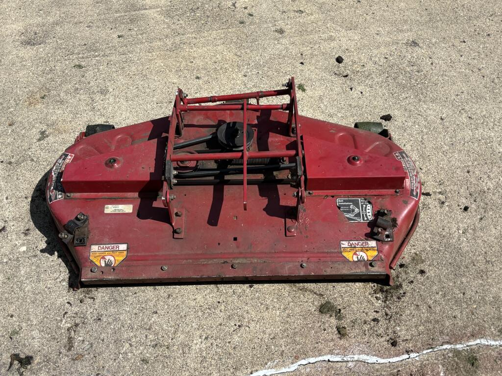

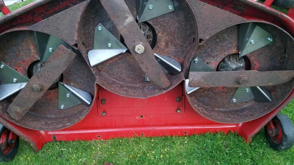

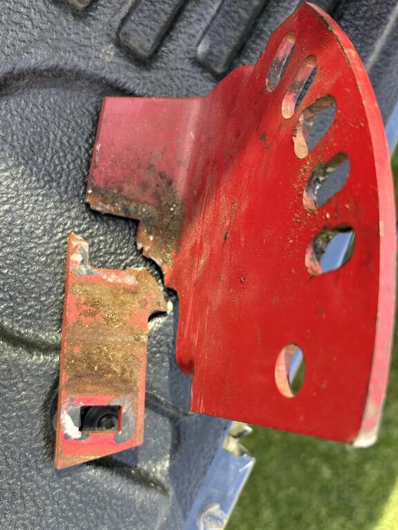

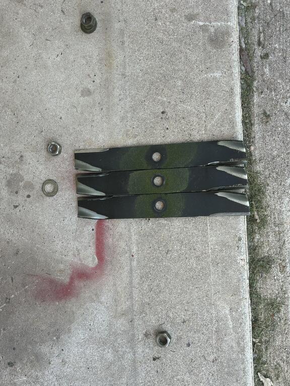

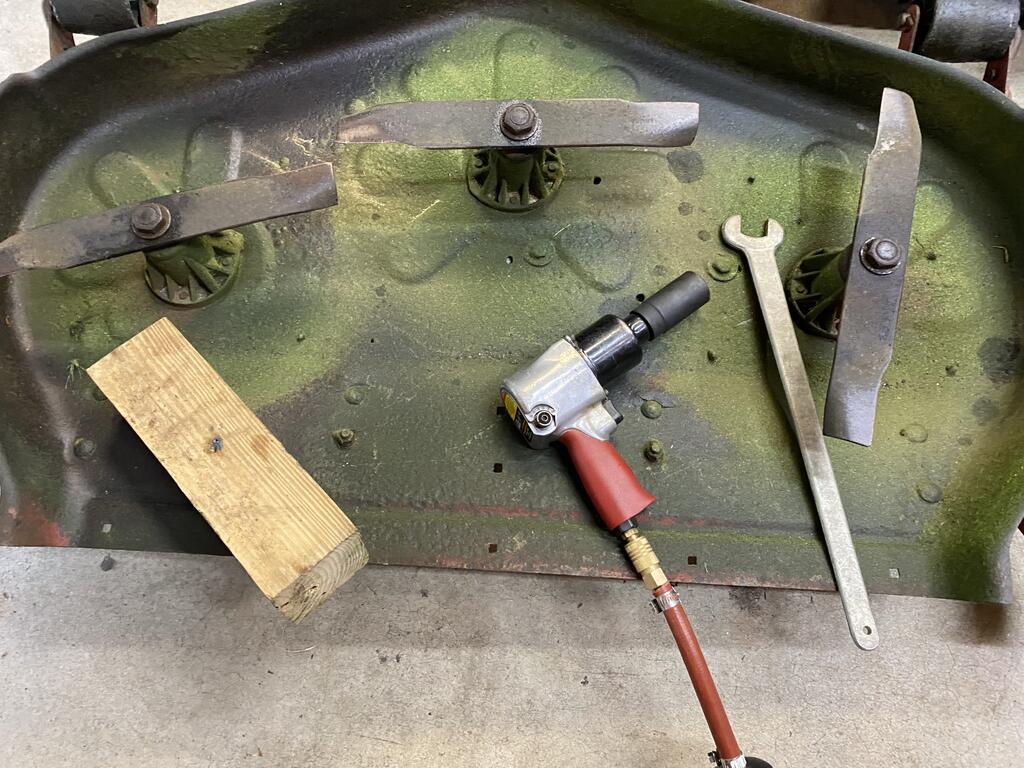

Lane Ranger 12,133 #15 Posted March 29, 2024 My 42 Inc recycler deck was pretty clogged up with wet grass when I took it off this am. I cut the lawn yesterday and it was a little high , not wet but the deck just wasn’t cutting RJ night. I changed the deck to PTO belt with a ne as one as old one was well worn . cleaned off deck and re coated with some Rustoleum. Not my best cleaning job but very little rust anyway. Buster my quadrant for the rear wheels lift after sharpening and reinstalling the mower blades. So ordered a r Ed placement quadrant and will reweld the old one as a spare Looks like I will put my old 36 inch rear discharge deck on my B-80 got my next mowing job! 1 Share this post Link to post Share on other sites
peter lena 10,088 #16 Posted March 29, 2024 @Sparky have 3 RD 42" decks , my experience with the baffle set up , was to remove the ROT BOXES , literally could not keep up with , packed , rotting grass, since removal , and regular lubrication / hot sun drying , have zero rust / rot or any unit cracking / splitting , another benefit is a very clean discharge , and very good cutting , have found the lubrication soaking far outdoes the , paint coating , underside is stained black , from open gear lube , and chain lubricant , regularly rub down the outside , with mineral oil , preserves paint , and zero rust . of course , each deck , has re greased , spindle bearings , as well as PTO DRIVE SET UP , AND MULE DRIVE BEARINGS . lucas 550 flash point grease , quiet , smooth spinning . repetitive operational failure , demanded a change , none since , the redo , pete Share this post Link to post Share on other sites

lynnmor 9,050 #18 Posted March 29, 2024 When looking for a 42" RD, know that some models have a nice solid bar around the bottom edge where others are just rolled tin. I believe that you can see it in the above photos. 1 Share this post Link to post Share on other sites

Brockport Bill 2,480 #20 Posted March 29, 2024 39 minutes ago, lynnmor said: When looking for a 42" RD, know that some models have a nice solid bar around the bottom edge where others are just rolled tin. I believe that you can see it in the above photos. on different era mower decks the perimeter of the shell edges on 42 Side Discharge also can include, or exclude, that reinforced edge bar -- adding strength, or not ?? Share this post Link to post Share on other sites
peter lena 10,088 #21 Posted March 30, 2024 @Brockport Bill think that bar adds strength , obviousely that was an attempt to retain older style / type , deck heft / strength. another thing , that I do , is to make sure that bar to deck connection , gets a regular penetrating oil / chain lube spray down . would rather have oil feeding a rust prone area than moisture . just how I see it , don't have any faded / unlubricated areas on my stuff . BTW , the paint stage on those decks , is perfect for a penetrating oil spray down / soak down , let sit a day or 2 , then wipe down . been doing this for years , all my decks have the squared off wheels , like a silicone grease on them , stands up , enhances function . thats in the SUPER LUBE CATAGORY , also comes in small bottle liquid form . perfect for choke / throttle cables , add a light spring to those for closing assist , and you will always have a slide assist on movement . thanks for the shout , pete Share this post Link to post Share on other sites
Lee1977 7,805 #22 Posted March 31, 2024 (edited) On 3/29/2024 at 5:47 PM, lynnmor said: When looking for a 42" RD, know that some models have a nice solid bar around the bottom edge where others are just rolled tin. I believe that you can see it in the above photos. I have added a 3/8" bar to my decks that don't have the one from the fractory. Add plate supports inside the deck at the rear lift points and the gage wheel support that didn't have them. The 42 side discharge need the support at the gage wheel bracket as they usually crack there and rust out. Edited March 31, 2024 by Lee1977 Share this post Link to post Share on other sites
Handy Don 17,558 #23 Posted April 4, 2024 On 3/29/2024 at 3:49 PM, Lane Ranger said: This shot clearly shows the very sturdy individual blade housings and the deflectors and how there isn’t a lot of room in there for an accumulation of clippings. This unit works best with well-sharpened blades--dull blades equals poor cut. Running one of these over sandy soil would get frustrating pretty fast, I suspect. When we must cut more than 2” off the grass, we tend to do a high pass and then a low pass. A huge plus of the recycler is that the deck shell has little exposure to clippings and the close, smooth circular housings don’t collect much, forestalling rot. Share this post Link to post Share on other sites
