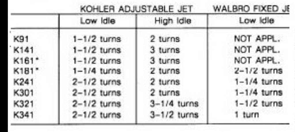

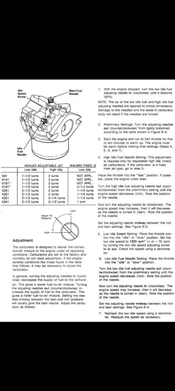

ebinmaine 81,139 #40 Posted July 22, 2023 Thanks to Joe for sending me the copy of the adjustment. I'll be putting in a request to my local Lamination Department (Trina) so I can post these pics on the shop wall. 1 Share this post Link to post Share on other sites

GAJoe 852 #42 Posted July 23, 2023 I found a modern PDF of a Kohler K series manual. "1. With the engine stopped, turn the low and main fuel adjusting needles in (clockwise) until it bottoms lightly. NOTE: The tip of the idle fuel and main idle fuel adjusting needles are tapered to critical dimensions. Damage to the needles and the seats in carburetor body will result if the needles are forced. 2. Preliminary Settings: Turn the adjusting needles out (counterclockwise) from lightly bottomed per the chart. Start the engine and run at half throttle for 5 to 10 minutes to warm up. The engine must be warm before making final settings. Main Fuel Needle Setting: This adjustment is required for adjustable main jet carburetors only. If the carburetor is a fixed main jet type refer to Walbro adjustment. Place the throttle into the wide-open or “fast” position. If possible, place the engine under load. Turn the main fuel adjusting needle out (counterclockwise) from the preliminary setting until the engine speed decreases (rich). Note the position of the needle. Now turn the adjusting needle in (clockwise). The engine speed may increase, then it will decrease as the needle is turned in (lean). Note the position of the needle. Set the adjusting needle midway between the rich and lean settings. 5. Low Idle Speed Setting: Place the throttle control into the “idle” or “slow” position. Set the low idle speed to 1200 RPM* (+ 75 RPM) by turning the low idle speed adjusting screw in or out. Check the speed using a tachometer. *NOTE: The actual low idle speed depends on the application - refer to equipment manufacturer’s recommendations. The recommended low idle speed for basic engines is 1200 RPM. To ensure best results when setting the low idle fuel needle, the low idle speed must not exceed 1500 RPM. 6. Low Idle Fuel Needle Setting: Place the throttle into the “idle” or “slow” position. Turn the idle fuel adjusting needle out (counterclockwise) from the preliminary setting until the engine speed decreases (rich). Note the position of the needle. Now turn the adjusting needle in (clockwise). The engine speed may increase, then it will decrease at the needle is turned in (lean). Note the position of the needle. Set the adjusting needle midway between the rich and lean settings. Adjust To Midpoint Lean Rich -0-B Figure 8. 7. Recheck idle speed using a tachometer. Readjust speed as necessary." In the last step 7 is the speed adjustment done with the "Idle Speed Adjusting Screw" as in step 5? 1 1 Share this post Link to post Share on other sites
ebinmaine 81,139 #43 Posted July 23, 2023 7 hours ago, GAJoe said: In the last step 7 is the speed adjustment done with the "Idle Speed Adjusting Screw" as in step 5? Yes sir 1 1 Share this post Link to post Share on other sites

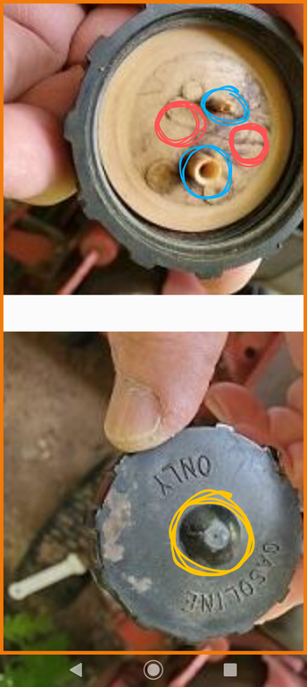

GAJoe 852 #44 Posted July 23, 2023 On 7/16/2023 at 3:44 PM, GAJoe said: @ebinmaineIs this the correct cap? Thanks for chiming in! The hole in the cap wasn't sealed intentionally there is a spot on the underside of the hood where the cap touches and has the paint worn off. So the vibration slowly rubs the hole full of the plastic. Got a solution? 1 Share this post Link to post Share on other sites
ebinmaine 81,139 #45 Posted July 23, 2023 22 minutes ago, GAJoe said: solution In your upper pic below I'm not sure if the ventilation is ONLY occuring at the larger of the places circled in blue. A#1. Check to see if the interior tan disc rotates. If not: Was it mine, what I'd do is drill a wee bitty hole in the top so it's ON the yellow circle (getting the hole away from the top of the cap) and lined up with one of the red circles (keeping the hole from being lined up with EITHER blue one). If it doesn't work you've lost nothing because you already have a cap that does not vent right. 1 1 Share this post Link to post Share on other sites
GAJoe 852 #46 Posted July 23, 2023 2 hours ago, ebinmaine said: In your upper pic below I'm not sure if the ventilation is ONLY occuring at the larger of the places circled in blue. A#1. Check to see if the interior tan disc rotates. If not: Was it mine, what I'd do is drill a wee bitty hole in the top so it's ON the yellow circle (getting the hole away from the top of the cap) and lined up with one of the red circles (keeping the hole from being lined up with EITHER blue one). If it doesn't work you've lost nothing because you already have a cap that does not vent right. great idea 1 1 Share this post Link to post Share on other sites
ebinmaine 81,139 #47 Posted July 23, 2023 13 minutes ago, GAJoe said: great idea I only got about one a year so hopefully this works. 3 Share this post Link to post Share on other sites
GAJoe 852 #48 Posted July 23, 2023 (edited) There is a filter material between the vent part and the top cap to prevent a splash from coming out. I put a couple 1/16" holes just off of the top center where it rubs the hood. Edited July 23, 2023 by GAJoe 1 Share this post Link to post Share on other sites
GAJoe 852 #49 Posted July 23, 2023 On 7/22/2023 at 8:54 AM, ebinmaine said: Thanks to Joe for sending me the copy of the adjustment. I'll be putting in a request to my local Lamination Department (Trina) so I can post these pics on the shop wall. I made the adjustments to the mixture needles. I couldn't get a good RPM reading from the photo tachometer to set the minimum yet. I'll have to revisit that. Share this post Link to post Share on other sites
