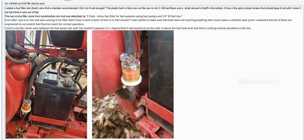

GAJoe 852 #1 Posted July 16, 2023 (edited) Back in Jan I installed a fuel filter that met everyone's approval. And I have been cutting the grass so far this summer without issue until this past Friday. I crank it up by choking and putting the throttle at half plus then turn the key. It always starts within seconds and I have to open the choke right away as it runs rough and smokes running rich until I do. So on Friday I started it as described and backed it out and began moving forward and it started to die as if out of gas then suddenly revs up as if I choked it, runs rough and smokes then sounds better and nearly dies and repeats a couple times then died. I verified that I have fuel (always non-ethanol) in the tank and that the new fuel filter is clean. Now that strainer at the bottom of the tank is laying over and slightly collapsed. I found that earlier and cleaned it out before adding the fuel filter in Jan. I also verified that the choke linkage is tight and the plate isn't moving. The air filter was a little dirty but not enough to cause this I don't believe. I'm thinking that I need to drain the tank and straighten the strainer out and inspect it closely out of the tank. Will the assembly come out of the tank? Remove it or replace it if it's a problem? But if that is not the problem I plan on picking up some new fuel line and putting on the fuel pump discharge into a catch container to make sure that it's pumping good. If it's pumping good I may leave out the check valve and see how it runs. If it behaves the same after all that then I think it's a float sticking in the carb' and I'll get a rebuild kit for it. I've been wanting to do a few of the 5 things in: but it was sounding so good that I didn't. If I decide to rebuild the carb it may be a good time. Please comment and tell me if I'm headed the wrong way. Any suggestions much appreciated. Thanks in advance. Edited July 16, 2023 by GAJoe 1 Share this post Link to post Share on other sites

ebinmaine 81,139 #10 Posted July 16, 2023 Having a fuel filter only part full is normal. That screen is looking a bit ragged. Definitely do a carb rebuild. IMHO: That really needs to be considered a part of consistent maintenance nowadays. Carefully check the upper shaft to carb body clearance. It should not be able to move much other than the standard circular motion. If that's loose it'll allow too much air along with difficulty regulating what does get. If that needs help lemme know. I keep the parts here to fix them. 1 Share this post Link to post Share on other sites

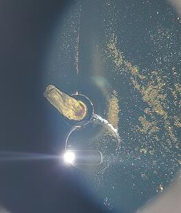

ineedanother 2,885 #13 Posted July 16, 2023 3 hours ago, GAJoe said: No hole in this so I'll put one in it in the center. Thanks! Before you replied I ran it with the cap loosened slightly to make suren air could get in but no difference. I did get a shot of the screen. And I noticed that the filter that I had added in January wasn't "gas-logged" but did have about 1/4 to 1/2 inch gas in it. I'm thinking that I need to order a gromet, valve, and air filter and see if that helps before diggin' in deeper. Probably get a carb' rebuild kit in same order to save shipping later. I can't tell for sure but that looks to me like sand in your fuel tank. It's very likely that you'll find a bit of a mess in the bowl on the carb and that it could use some compressed air to clean out the jets and drillings. I would replace the fuel lines and clean the whole system while I was at it. Pretty cheap maintenance IMO. 3 Share this post Link to post Share on other sites
GAJoe 852 #14 Posted July 17, 2023 26 minutes ago, ineedanother said: I can't tell for sure but that looks to me like sand in your fuel tank. It's very likely that you'll find a bit of a mess in the bowl on the carb and that it could use some compressed air to clean out the jets and drillings. I would replace the fuel lines and clean the whole system while I was at it. Pretty cheap maintenance IMO. I gave the fuel tank a good cleaning and will be getting fuel rated clear vinyl hose to replace the hardened black fuel lines. Getting a carb' rebuild kit. 3 Share this post Link to post Share on other sites
ineedanother 2,885 #15 Posted July 17, 2023 2 minutes ago, GAJoe said: I gave the fuel tank a good cleaning and will be getting fuel rated clear vinyl hose to replace the hardened black fuel lines. Getting a carb' rebuild kit. Lots of opinions here but not many in favor of the clear or "next best thing" fuel line. I would recommend Gates or whatever your local NAPA has in stock. 3 Share this post Link to post Share on other sites
