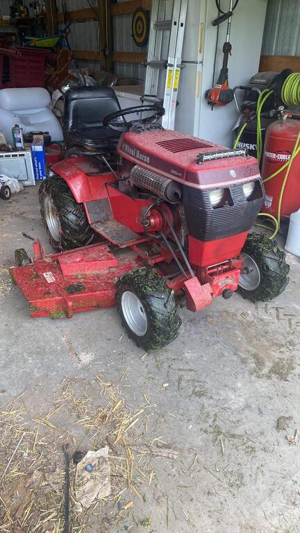

Creapy8x 7 #1 Posted July 15, 2023 So a couple years back I bought an 88 520h and a couple other tractors and last year I got lucky a found out my boss’s dad has/had a 520 (unsure of year) as well with a 60” deck and a mid mount grader blade that unfortunately met it’s demise in a barn fire but luckily the grader blade and deck wasn’t attached to the tractor at the time of the fire an was stored elsewhere! So it all began with me lookin for a 60” deck for my tractor when the boss told me his dads got one an needless to say I was able to buy the deck which is now under my tractor but the problem I’m running into is my tires rub on the deck only allowing me to make partial turns because of my straight front axle! Well as it turned out his dad still had the burnt tractor which he has since let buy from him and I have pulled the front axle from it but still have to pull the steering shaft from front shaft up to the column an and I’m to start tearing my tractor apart to do an axle swap! But In doin some looking the wheels on my current axle I don’t believe will fit the forward swept one because of the larger spindles, I do have to old wheels from the burnt horse which pretty sure will need new bearings but I notice I don’t have the spindle nuts! so on another note in doing some research looking for parts lists and owners manuals for my tractor I’m having a hard time figuring out what exactly mine is, I can only find one sticker under the seat with an ID number (3120OE01) which im finding is a 520h but looking around mine has the dash from an 520hc so I’m just not sure. 1 Share this post Link to post Share on other sites
c-series don 10,804 #2 Posted July 15, 2023 The HC came with the forward swept axle and heavy duty spindles, so yours is not an HC. Also the HC didn’t have chrome anything I don’t believe. The 520-HC and the 418-C had something in the transmission to make them just a touch faster, I think 7 mph? 2 Share this post Link to post Share on other sites

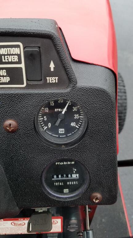

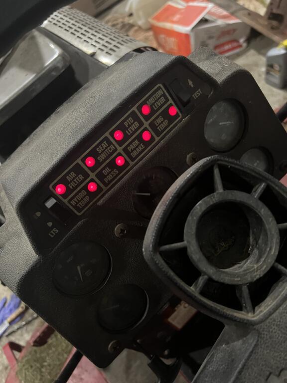

Lee1977 7,460 #3 Posted July 16, 2023 How many test lights are there on the top panel? Share this post Link to post Share on other sites

Creapy8x 7 #5 Posted July 16, 2023 51 minutes ago, Lee1977 said: How many test lights are there on the top panel? Share this post Link to post Share on other sites
Lee1977 7,460 #6 Posted July 16, 2023 It is a 520 -H the others have 6 llights up there, 1 Share this post Link to post Share on other sites

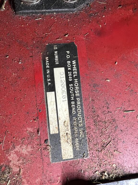

gwest_ca-(File Mod) 11,852 #7 Posted July 16, 2023 2 pages of search results for 31-20OE01 https://www.wheelhorseforum.com/search/?q=31-20oe01&quick=1&type=downloads_file 2 Share this post Link to post Share on other sites

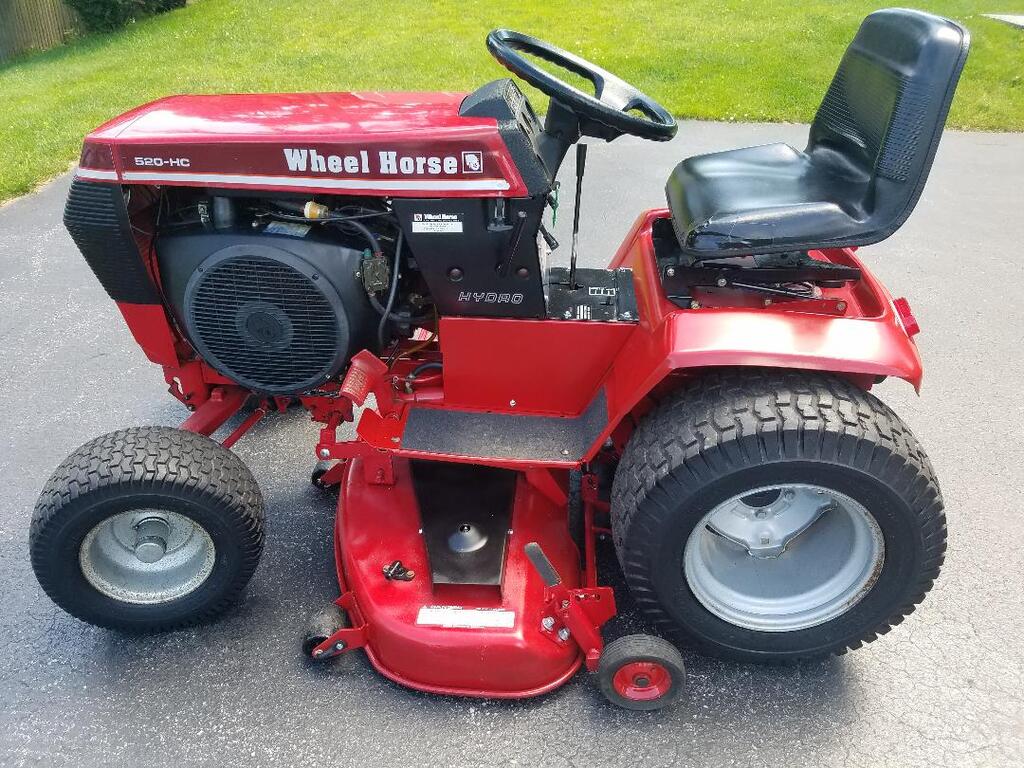

JCM 10,415 #8 Posted July 16, 2023 520-HC had 16x7.50 front tires and 23x10.50 rears and the 520-H had 6.50 and 9.50 tires. Folding arm rests on the HC, among other things. 1 Share this post Link to post Share on other sites

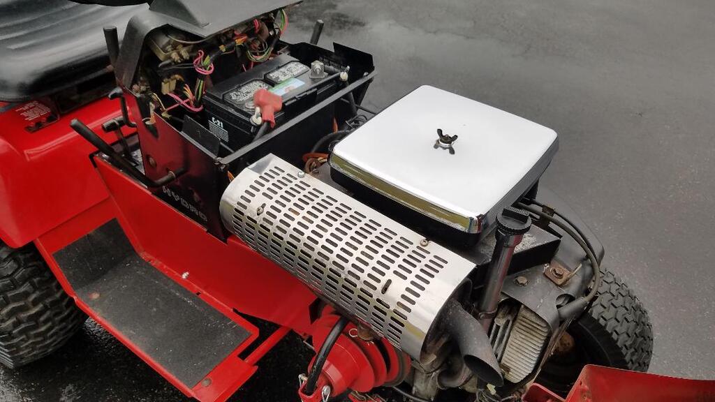

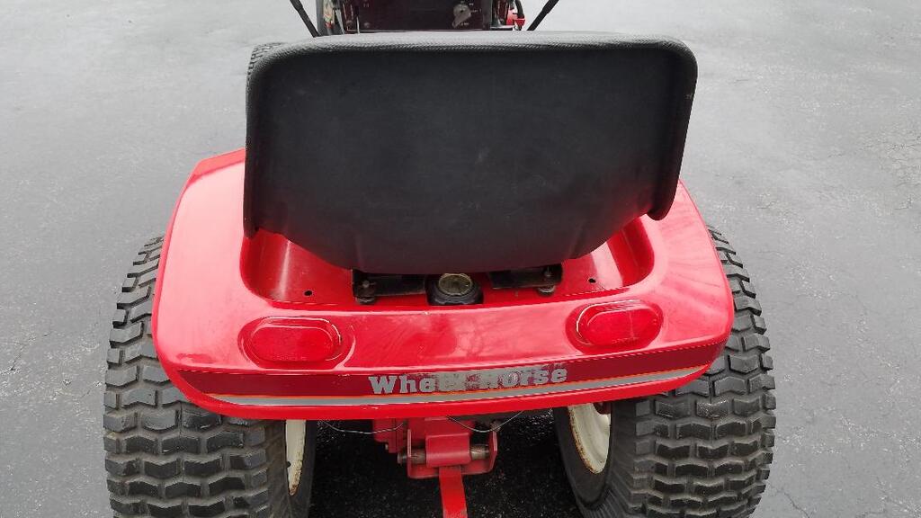

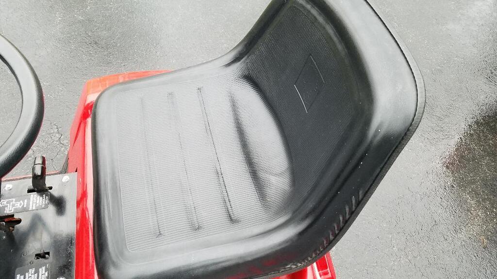

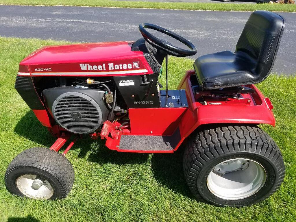

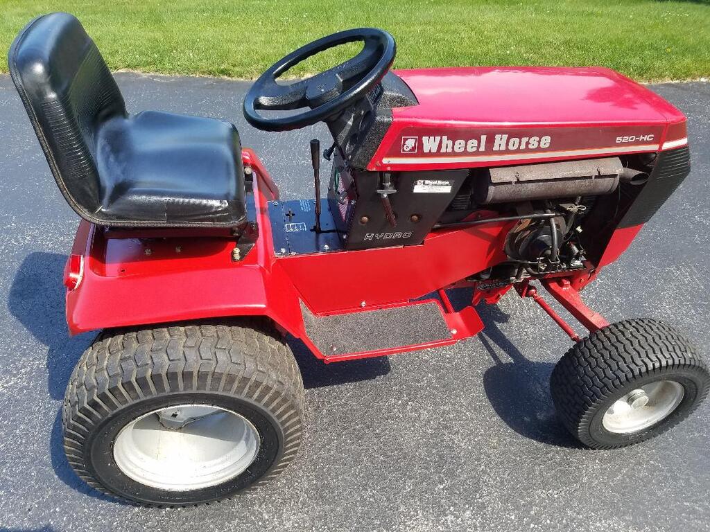

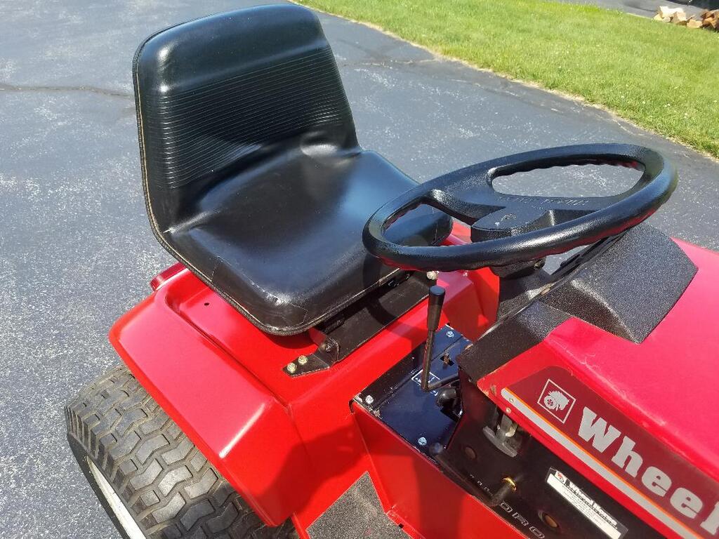

Brockport Bill 2,125 #11 Posted July 16, 2023 22 hours ago, c-series don said: The HC came with the forward swept axle and heavy duty spindles, so yours is not an HC. Also the HC didn’t have chrome anything I don’t believe. The 520-HC and the 418-C had something in the transmission to make them just a touch faster, I think 7 mph? here are some 520 HC photos I took that my grandson now has..... yes Don, per my WH brochure, the HC had a top speed 7.5 versus 6.4 for the 520H 1 Share this post Link to post Share on other sites

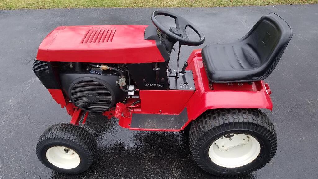

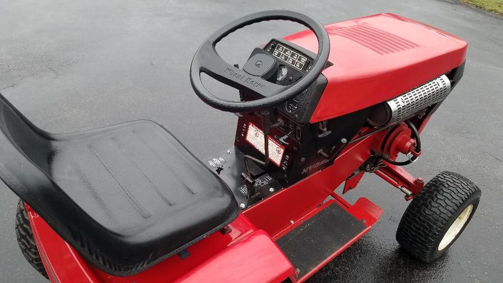

Brockport Bill 2,125 #12 Posted July 16, 2023 here are some of our 520h photos from different views for comparison to HC - sold this a year ago Share this post Link to post Share on other sites
