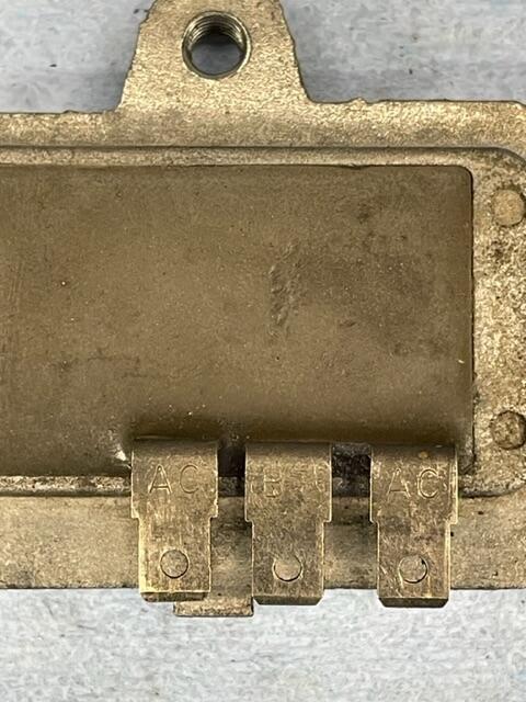

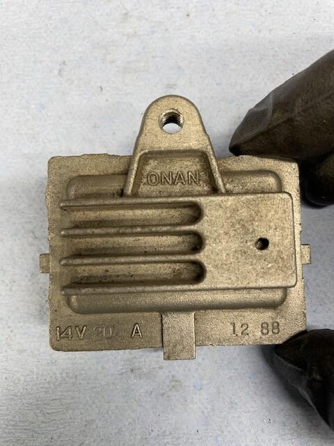

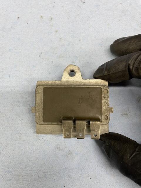

Kissinger_520H 3 #5 Posted July 14, 2023 I meant to add this to my last post but forgot so here they are. This at least looks original to me. If 12 88 is a date code, that would seem consistent with a 1989 520H. Share this post Link to post Share on other sites

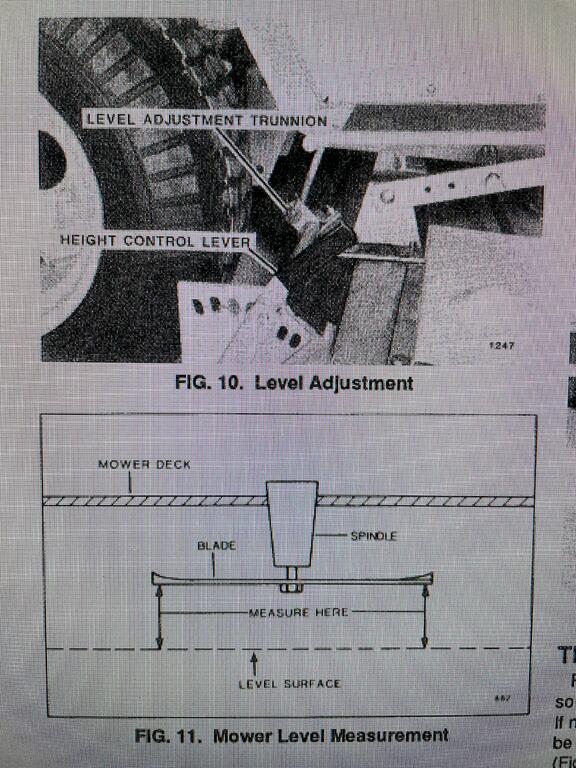

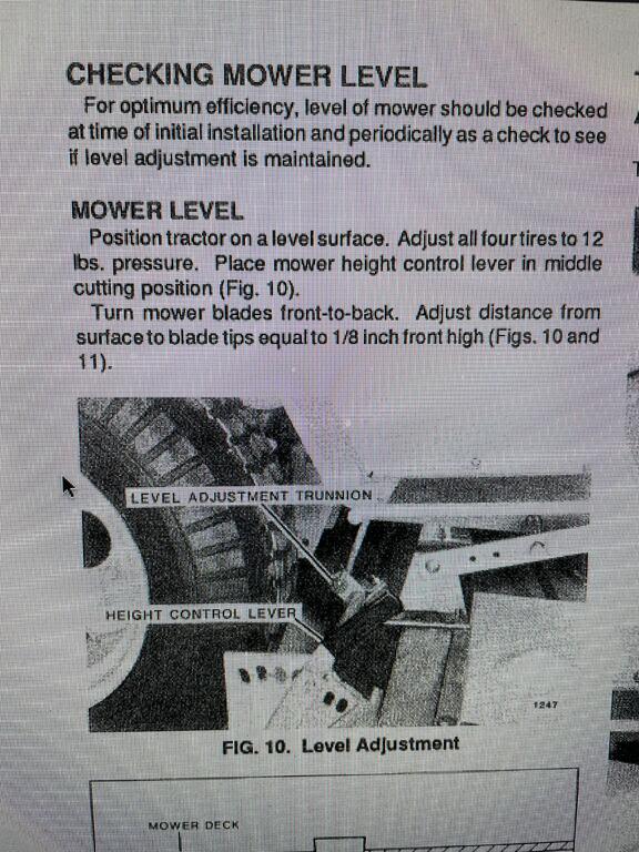

Kissinger_520H 3 #18 Posted July 23, 2023 4 minutes ago, rick said: That is correct on the narrower decks, I don't have a 60" deck so no manual to check . So this is the description of the leveling adjustment and I’ve gotta admit this makes no sense to me. “Adjust distance from surface to blade tips equal to 1/8 inch front high.” I don’t know who wrote this but I can’t quite imagine what this is indicating. I would think you would simply measure the front of the blade tip to the ground and the rear blade tip to the ground and adjust until they’re the same. But setting them 1/8” from the surface seems extremely low for any height setting. Am I missing something? Share this post Link to post Share on other sites
Kissinger_520H 3 #20 Posted July 23, 2023 Okay thinking this over for a while has me thinking perhaps this means to set them at equal height to the front being 1/8” higher than the rear. Share this post Link to post Share on other sites
rick 296 #21 Posted July 23, 2023 Yes, from equal height front and rear to front being 1/8" higher. Be sure the deck lift arm is lowered all the way so it isn't influencing the deck carriage. It's best to use the same tip for both measurements. 1 Share this post Link to post Share on other sites
Kissinger_520H 3 #22 Posted July 23, 2023 Well I've done some adjusting and think I've got it nicely leveled when in the lowered position. It seems the lower trunnion nut when tightened raises the front of the deck. It was actually almost perfect before I touched it so I slightly tightened up the nut and brought the front up 1/8th". Now when it comes to leveling the lifted deck, that is a different story. The manual says that the bumpers should be set at the lowest setting and any adjustments necessary made to level the lifted deck. So with both bumpers at the lowest setting and the deck lifted, the right side against the bumper and a few inches higher than the left which cannot reach the bumper. It took me a minute to realize that the top of the deck on the left side was bottoming out against the left side of the attach-a-matic front attachment. On the left side, there's an arm that flips down when the carriage is secured and it hangs down several inches. So when I raise the deck, it runs into this arm and keeps the left side from hitting that bumper or going as high as the right side. I can lower the right side bumper to even things out but that ultimately results in a deck that doesn't lift as high but as I see no means of adjusting that mounting switch arm, this seems like the only option. That said, I can clearly see wear marks on the bumper towers that show the deck was able to be raised higher in the past which has me puzzled. I may be overthinking and analyzing this but this is just how my brain works. I want it to be perfect and I want to fully understand the manner by which it was designed to function. So for anyone following along, thank you! Share this post Link to post Share on other sites

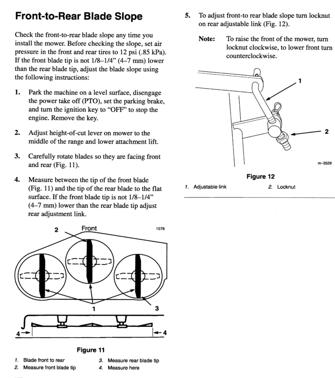

lynnmor 8,875 #23 Posted July 23, 2023 My 60" deck manual says this: I adjust it to level when in the desired cutting height, Typically the blades are adjusted to 1/8" low in front to avoid additional cutting at the rear. The manual for some 42" decks says to adjust to the front high 1/8", I don't know if that is a typo. Since most Wheel Horses cut too low even at the maximum height setting, I adjust to level to get as much height as possible. 1 Share this post Link to post Share on other sites
