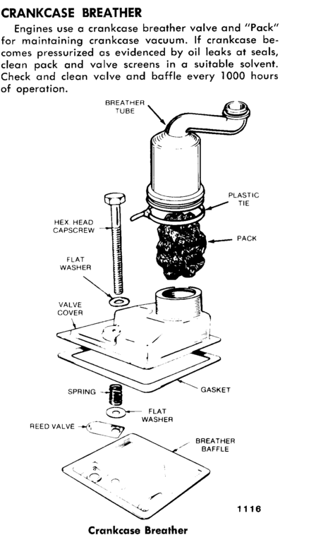

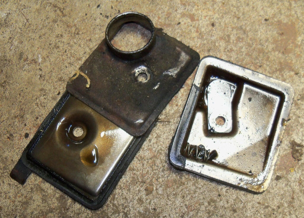

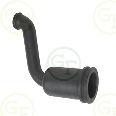

CrossThread Industries 31 #1 Posted May 11, 2023 Hi Everybody, I found a good deal on an almost unused 518H. Onan P218G engine. Immaculate. Question 1) The Hobbs indicates 900 hours and there is no way this unit has seen more than 50 active hours. Did I read somewhere that as long as the key sits in the ignition, the Hobbs runs? Question 2) more serious, after 10 minutes of running from cold, a ton of oil is making its way up through the crankcase breather tube into the carb and belching a huge white cloud of smoke. It burns off, then repeats. The previous owner mentioned this problem. I read every manual I could find but I don't see how that much oil can get purged up into the air filter area. Is there a plugged oil return path? Perhaps it has something to do with the reed valve not work correctly, maybe. I found a used one on ebay (pic below) but I don't know if replacing the reed valve group really cover what's broken about this setup. Does anyone have any experience with this ? Share this post Link to post Share on other sites

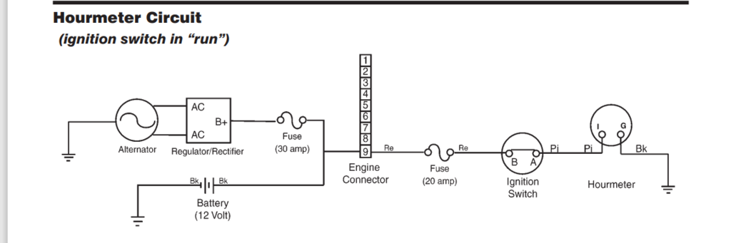

lynnmor 9,073 #4 Posted May 11, 2023 Most Onans have the hour meter wired thru the oil pressure switch so that the meter will not run, apparently the 518-H isn't wired that way. The breather tube should be a tight fit going thru the bottom or the air filter housing, that loose fit allows dirt into the engine. The breather may not be assembled correctly. 1 Share this post Link to post Share on other sites

CrossThread Industries 31 #7 Posted May 11, 2023 1 hour ago, lynnmor said: Most Onans have the hour meter wired thru the oil pressure switch so that the meter will not run, apparently the 518-H isn't wired that way. The breather tube should be a tight fit going thru the bottom or the air filter housing, that loose fit allows dirt into the engine. The breather may not be assembled correctly. Excellent info, thanks for the drawing... I will start by disassebling the breather circuit and checking the reed valve. Definitely getting the feeling it's the rings. Share this post Link to post Share on other sites
squonk 48,326 #8 Posted May 11, 2023 518H hour meter circuit 88-89 1 Share this post Link to post Share on other sites
CrossThread Industries 31 #9 Posted May 11, 2023 29 minutes ago, squonk said: 518H hour meter circuit 88-89 Thanks - I will check to see if any electrical got changed - there does seem to be a home-job on a switch for the lights. You never know what happens when the owner tinkers. Cheers - PJ Share this post Link to post Share on other sites

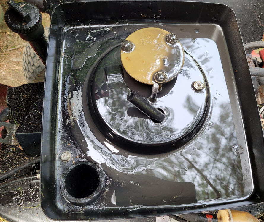

RED-Z06 2,720 #12 Posted May 13, 2023 (edited) Oil looks discolored...possibly fuel thinned? Edited May 13, 2023 by RED-Z06 Share this post Link to post Share on other sites
Wild Bill 633 943 #13 Posted May 13, 2023 Again, I am not familiar with an Onan, but, in the picture above of the air cleaner housing, there is a hose coming up thru a hole which is not totally sealed. If the hole is not sealed, dirt can bypass the air cleaner and get sucked into the engine causing damage. Share this post Link to post Share on other sites
lynnmor 9,073 #14 Posted May 13, 2023 5 hours ago, Wild Bill 633 said: Again, I am not familiar with an Onan, but, in the picture above of the air cleaner housing, there is a hose coming up thru a hole which is not totally sealed. If the hole is not sealed, dirt can bypass the air cleaner and get sucked into the engine causing damage. Apparently he has the earlier version of the breather tube, they are getting hard to find and he should buy two if he intends to keep the tractor. Share this post Link to post Share on other sites
