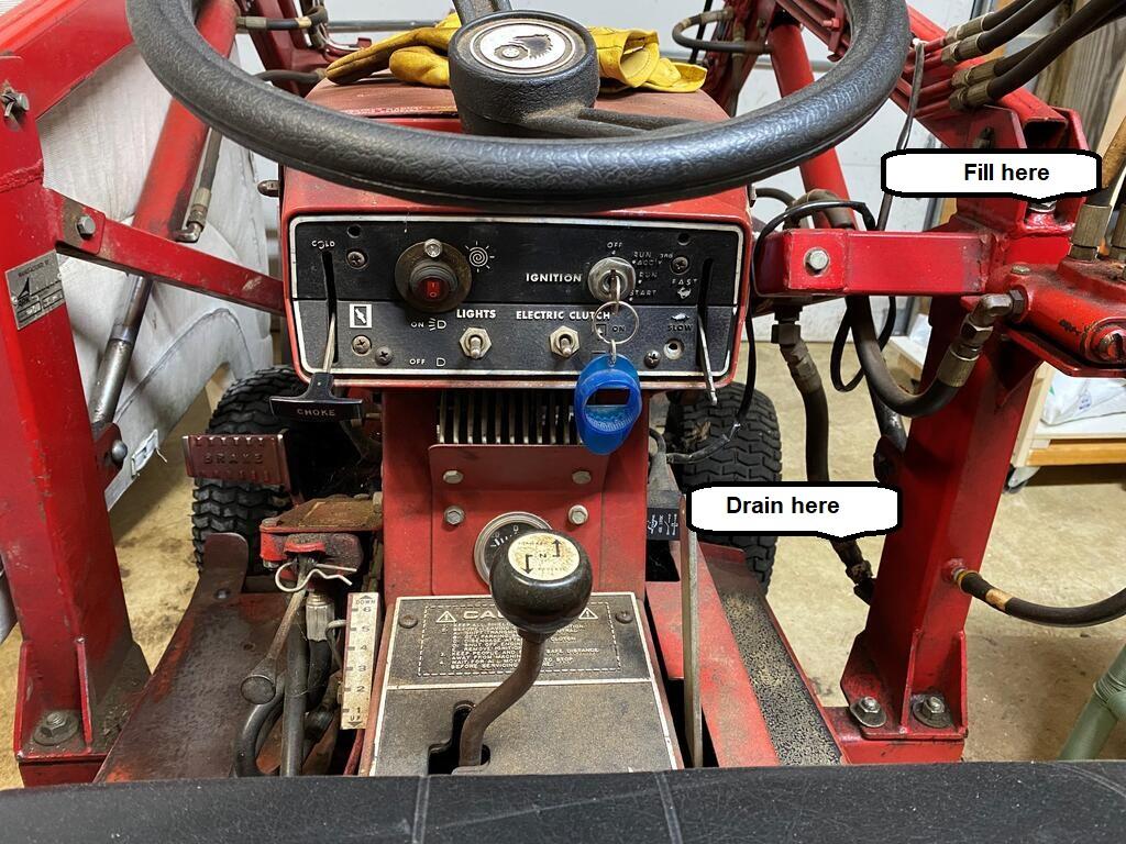

HyperPete 939 #11 Posted April 16, 2025 Thread revived from the dead. I have read 4 manuals and multiple threads. I cannot, for the life of me, find any information concerning changing the oil. There is plenty of info concerning total oil capacity, what kind of oil, where to fill, how to bleed, and where to check fill level. Can anyone tell me how to completely DRAIN it in order to fill it with fresh oil? Do I have to disconnect hoses and do several fills & drains to get all of the old oil out? I have many projects in various states of completion, but this just became a priority because the FEL won't lift a rototiller. Probably just low on oil, but that's a good reason to change it for the 1st time since I have owned it. Thank you! Share this post Link to post Share on other sites
953 nut 68,462 #12 Posted April 16, 2025 You won't get 100% of the old oil out but removing the lower hose will drain most of it. 1 Share this post Link to post Share on other sites
HyperPete 939 #13 Posted April 16, 2025 12 minutes ago, 953 nut said: You won't get 100% of the old oil out but removing the lower hose will drain most of it. That's exactly what I needed. Thank you! 1 Share this post Link to post Share on other sites

HyperPete 939 #20 Posted May 14, 2025 So, I have been thinking about returning to transmission fluid. It bugs me that I can only drain fluid from the right upright by removing a hose, and not at all from the left leg. So, basically, it's impossible to get more than about 50% of the fluid out of the system as-is. So I have not done anything since I drained & filled last. I've thought about drilling a hole in the bottom of the left upright, threading it, and installing a drain plug so I can drain both sides.. Am I asking for trouble; will it depressurize / leak regardless of the kind of plug I use? Can I just use a pipe thread plug with Teflon tape, or would I need some kind of compression fitting? Are metal chips a serious concern if i use rare earth magnets around the hole I drill, and possibly grease on the drill bit? Share this post Link to post Share on other sites
8ntruck 9,215 #21 Posted May 14, 2025 You don't want to use Teflon tape on threaded fittings in a hydraulic system. Doing so introduces the possibility of slivers of Teflon tape contaminating the system - mechanically, not chemicaly. The plant I retired from banned the use of Teflon joint tape for this reason. Share this post Link to post Share on other sites
wallfish 20,508 #22 Posted May 14, 2025 17 hours ago, HyperPete said: So, I have been thinking about returning to transmission fluid. It bugs me that I can only drain fluid from the right upright by removing a hose, and not at all from the left leg. So, basically, it's impossible to get more than about 50% of the fluid out of the system as-is. So I have not done anything since I drained & filled last. I've thought about drilling a hole in the bottom of the left upright, threading it, and installing a drain plug so I can drain both sides.. Am I asking for trouble; will it depressurize / leak regardless of the kind of plug I use? Can I just use a pipe thread plug with Teflon tape, or would I need some kind of compression fitting? Are metal chips a serious concern if i use rare earth magnets around the hole I drill, and possibly grease on the drill bit? There shouldn't be any fluid in the left upright unless someone modified it. The right upright is the only reservoir from the factory. Are there hoses or lines connected to it? Waffling back and forth between fluids is just going to keep mixing fluids and take more effort. Pick one and stick with it and change the fluid a couple of times. Follow the draining instructions you posted for changing the type of fluid even though you are keeping it the same fluid and that will remove the most of the mixed fluid as well. If you're getting a quart of ATF flowing out of the breather then jack it up even farther and get even more out first. (That seems like an excessive amount) Drain per instructions, run and operate the system, rinse and repeat as long as necessary. Yeah it's a PITA, but once the fluid type was changed... Share this post Link to post Share on other sites
HyperPete 939 #23 Posted May 14, 2025 (edited) 1 hour ago, wallfish said: There shouldn't be any fluid in the left upright unless someone modified it. The right upright is the only reservoir from the factory. Are there hoses or lines connected to it? Waffling back and forth between fluids is just going to keep mixing fluids and take more effort. Pick one and stick with it and change the fluid a couple of times. Follow the draining instructions you posted for changing the type of fluid even though you are keeping it the same fluid and that will remove the most of the mixed fluid as well. If you're getting a quart of ATF flowing out of the breather then jack it up even farther and get even more out first. (That seems like an excessive amount) Drain per instructions, run and operate the system, rinse and repeat as long as necessary. Yeah it's a PITA, but once the fluid type was changed... yep, well, maybe ill stick to the 10w30 then. I expect that a second fill & drain should clear the system pretty well, and the 3rd ffill should be fine. I'm just frustrated by the ATF coming out after following the instructions to a T. I keep thinking of my 2017 Ridgeline where you have to do 3 transmission fluid changes in a row to change most of the fluid since there is no way to drain the torque converter. Danged engineers! I operated it a little after the 1st change, so it should be pretty well mixed. And no, now that you mention it, there are no lines to the left upright. I don't know where that ATF came from. To jack the front any higher, I'll have to remove the weight box. It's already up about as high as I am able to jack it. I have not brewed in decades, or I would "relax, and have a homebrew!" Edited May 14, 2025 by HyperPete 1 Share this post Link to post Share on other sites
