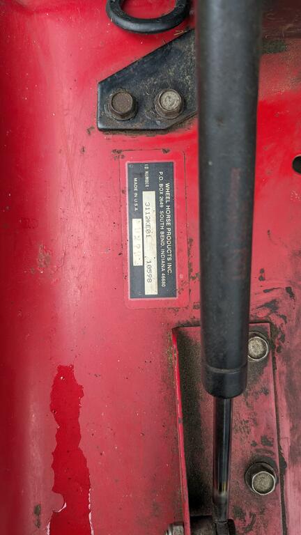

gwest_ca-(File Mod) 12,454 #5 Posted July 5, 2023 It ran out of fuel and quit. The pto may be still engaged - pto must be off to start. Transmission must also be in neutral. Have a tractor model and serial number? Needed to find the correct wiring diagrams. 1 1 Share this post Link to post Share on other sites
Phan 68 #6 Posted July 5, 2023 10 hours ago, Jon Paulsen said: If the engine is not turning at all, then it could be the starter. There's a gear on it that should pop up and engage the teeth on the flywheel. If it doesn't jump up and engage the flywheel, it's usually caused by crud. You will probably have to get that cover off to see it in action. I've really only worked on B&S engines. I've gotten a few Koehler's running for neighbors, but no real troubleshooting experience. If the gear is stuck, this might not be the best way but it's always worked for me as a permanent fix. I just clean up the sliding surface with carb cleaner and spray some dry lube (teflon spray) on the offending part. You'll see how it works when you look at it. I also put some really sticky red grease on the teeth that engage. Just a very small amount. Listen to the advice of others on the grease before me. It might just attract dust. I can give you a cool red splatter stain across your T-shirt I bit of advice on spraying flammable stuff into a carb. Never, ever, ever do this on a running engine. If it backfires it can ruin your day. Or year. Or kill you. When I was a kid, an experienced mechanic that went to our church sprayed ether (starting fluid, quick start, whatever you want to call it) into a the carb of a poorly running engine. The engine backfired and he got 3rd degree burns from head to toe. It might be rare, but it can happen, and it's not worth a year of skin grafts to get a vehicle to start. Carb spray is probably safer in this regard. I spray, get the breather cover on, then try to start it. Jon Paulsen: Thanks ! Your expert recxommendation is consistent in this post "c-145 starter not engaging flywheel". And "spraying the inflamable liquid" - I don't understand why they sale such "quick start" - so people like me are at risk of injuries ! Share this post Link to post Share on other sites
Phan 68 #7 Posted July 5, 2023 10 hours ago, gwest_ca said: It ran out of fuel and quit. The pto may be still engaged - pto must be off to start. Transmission must also be in neutral. Have a tractor model and serial number? Needed to find the correct wiring diagrams. gwest_ca: Agree + Thanks ! I will have them this afternoon. Share this post Link to post Share on other sites

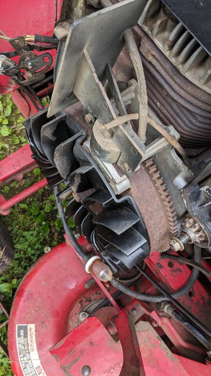

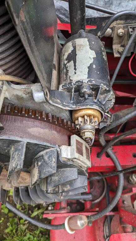

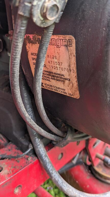

Phan 68 #10 Posted July 9, 2023 Hello - Sorry for my pause. I felt better for the flu. I remove th ecover and foud out Bendix and the flywheel of my 312-H - why she cannot start after running the fuel with serial number and model number. Any thoughts/comments on this issue. Thanks you a ton ! 1 Share this post Link to post Share on other sites

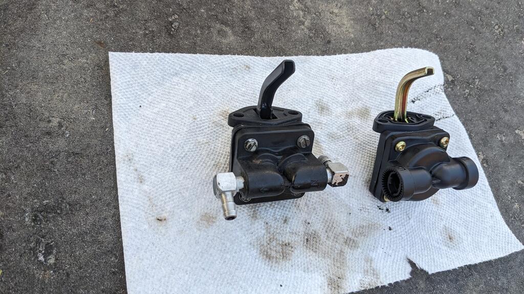

Phan 68 #11 Posted July 9, 2023 Also,I noticed that the OEM and a new pump are signbigificantly different - aI clened the OEM pump and put back. You may notice that the wire was damaged by a mice. Share this post Link to post Share on other sites

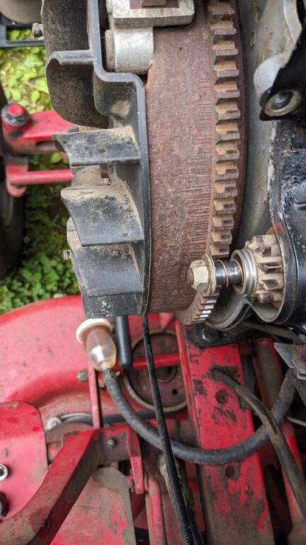

Phan 68 #12 Posted July 9, 2023 On 7/5/2023 at 9:52 AM, Ed Kennell said: Sounds like the starter is running but not engaging the flywheel.. The engaging spiral probably just needs cleaned. Remove the tin, pull the gear into the flywheel. Then spray the spiral with carb cleaner until the parts are clean. Then lube with powered graphite. The starter should now engage and crank the engine unless the starter shaft has broken....I have found the shafts broken on three of the 50+ tractors I have worked on. With the starter now working, you may have to prime the pump to get fuel to the carb. to get the engine to start. Ed Kennell: I wish to see your clip at you mentioned "Remove the tin, pull the gear into the flywheel. Then spray the spiral with carb cleaner until the parts are clean. Then lube with powered graphite. ..." I tried to find on YouTube but could find one so far Share this post Link to post Share on other sites
lynnmor 9,012 #13 Posted July 9, 2023 Ed had a typo, he meant powdered graphite, a black dry dust, available at many hardware and auto parts stores. The small gear in your photo needs to move freely when you pull on it to compress the spring, Ed wants you to pull that gear in and out while cleaning the shaft with the cleaner. 1 Share this post Link to post Share on other sites
Phan 68 #15 Posted July 9, 2023 2 minutes ago, lynnmor said: Ed had a typo, he meant powdered graphite, a black dry dust, available at many hardware and auto parts stores. The small gear in your photo needs to move freely when you pull on it to compress the spring, Ed wants you to pull that gear in and out while cleaning the shaft with the cleaner. Hi lynnmor: Thanks for your contribution. I was able to clean this morning with cab cleaner. The spring is compressed freely althought the grear appeared not to be. However, I will check the gear again - I think Ed aid I should be able to pull the gear with my fingers and compress the spring ! Share this post Link to post Share on other sites
Phan 68 #16 Posted July 9, 2023 1 minute ago, Ed Kennell said: Hi Ed: Thanks a lot - I am going out to a store before it closed. Share this post Link to post Share on other sites
Ed Kennell 46,985 #17 Posted July 9, 2023 3 minutes ago, Pokk said: I think Ed aid I should be able to pull the gear with my fingers and compress the spring ! You will have to rotate the gear as you pull it to the flywheel. Share this post Link to post Share on other sites

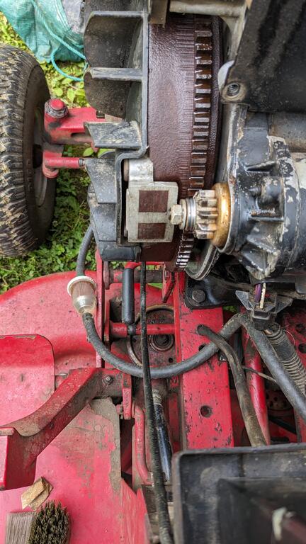

Phan 68 #18 Posted July 9, 2023 Hi eryone - To update, I was able to perform what Ed said. Also, I found the powdered graphite - should I just lube on the both grears of the flywheel and the starter. Share this post Link to post Share on other sites
Ed Kennell 46,985 #19 Posted July 10, 2023 Not on the gears. Just on the shaft under the starter gear. 1 Share this post Link to post Share on other sites
Rick3478 462 #20 Posted July 10, 2023 1 hour ago, Pokk said: Hi eryone - To update, I was able to perform what Ed said. Also, I found the powdered graphite - should I just lube on the both grears of the flywheel and the starter. I don't think it will hurt the gear teeth, but where it really needs is up inside the little gear where spiral grooves you can't see propel it out into the flywheel. Your slightly different looking fuel pump is the plastic replacement made to replace the old metal type. I'm not a huge fan, but they work okay. Your spark wire looks usable, I've seen much worse. It's stiff and spaced far enough from the shroud that it shouldn't arc. Share this post Link to post Share on other sites
