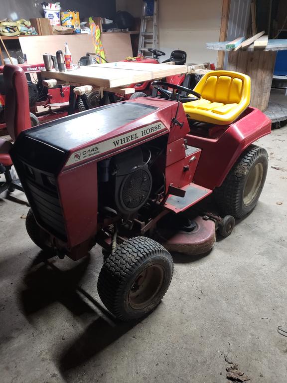

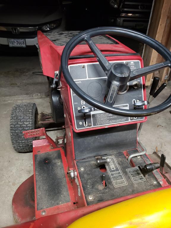

Kody Bob 17 #1 Posted January 29, 2019 Hi guys, I just purchased a 1981 c145 automatic hydro. Got it home and tried to start it. With the hood up I could see the starter spinning but it did not sound like it was contacting anything. Little about me, I was handed down my dad's 310-8. It's the first GT I learned to mow and plow snow on. Always loved it and wheel horse and finally found a good deal to add to/start my collection. I am sure I am going to run into other issuss and hope to learn more about the eaton hydro and automatic transmission. Anyway, thanks in advance for any help. Share this post Link to post Share on other sites

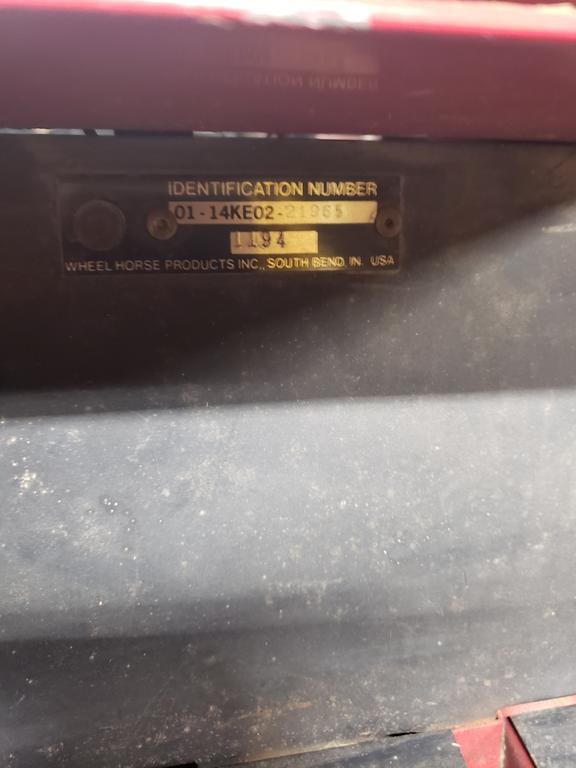

gwest_ca-(File Mod) 12,369 #4 Posted January 29, 2019 Welcome to the forum. Is your serial number 21965? Hard to read. Click on the picture Garry Share this post Link to post Share on other sites

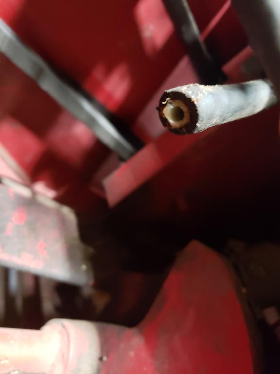

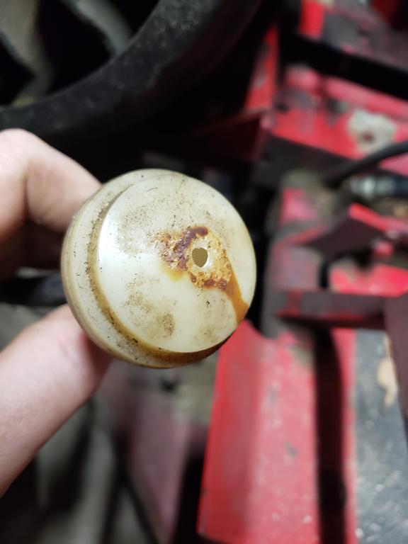

Kody Bob 17 #19 Posted January 30, 2019 So I pulled the starter and got the bendix to move freely, put it back on along with my battery from my 310-8 and boom! Contact. One problem solved, however it appears there is still some work to be done as it would not start. I think the biggest discovery of the night was the fuel filter... It appeared dry... And in trying to disconnect it from the hose the brittle plastic broke. I'm guessing I am probably in need of some new fuel line and a filter? Would love to hear yalls thoughts. Also, what is the best way to test for spark? I believe the coil and condenser have been replaced. 1 Share this post Link to post Share on other sites

Kody Bob 17 #22 Posted January 30, 2019 10 hours ago, Tuneup said: So much fun! If you want to hear it, connect the battery (+) to the coil (+), give a 1 second squirt of carb cleaner or even WD40 in the carb throat and hit the starter. If she coughs, there's a spark and you just have to clean the carb and replace the fuel line. You're almost there! Found a good deal on fuel line, both kohler oem fuel and air filters, and kohler carb rebuild kit. I was surprised that all of this was available on Amazon for around 35 bucks... Anyway, it should be here tomorrow. Tonight I will hook the battery to the coil as suggested and see if I have spark. Thanks again for all of the advice guys. Also, read a six page thread on here from a guy who was having a hard time starting his grandfathers tractor which I believe was also a C-145... Super long thread but it seems you all touched on just about everything under the sun that could keep the old girl from starting. should be able to use that to help in additional troubleshooting should I need it. 1 Share this post Link to post Share on other sites
formariz 12,379 #23 Posted January 30, 2019 (edited) Definitely change entire fuel line. In addition to that if tractor sat for a long time there is a good possibility that fuel tank has a bit of water in it along with the usual crud. That tank has a "dead" section where fuel remains even when it is out of gas. Recommend taking fuel tank off and totally clean it, it is relatively easy. The little filter screen inside may also be clogged and damaged. I simply get rid of it. This way it will never clog and exterior filter is better at catching any debris anyway. This way fuel tank is always clean. Since you changing line it is also a good time to introduce a check valve right under fuel pump. It will greatly with starting tractor by not allowing pump to lose prime.https://www.amazon.com/Excelvan-0-24Inch-Chrome-Aluminium-Non-return/dp/B01C3PD06K/ref=sr_1_3?ie=UTF8&qid=1548881697&sr=8-3&keywords=fuel+check+valve+1%2F4 Should also reverse that condenser with wire facing down,so no water collects on top which eventually will cause it to fail. Edited January 30, 2019 by formariz 1 Share this post Link to post Share on other sites
