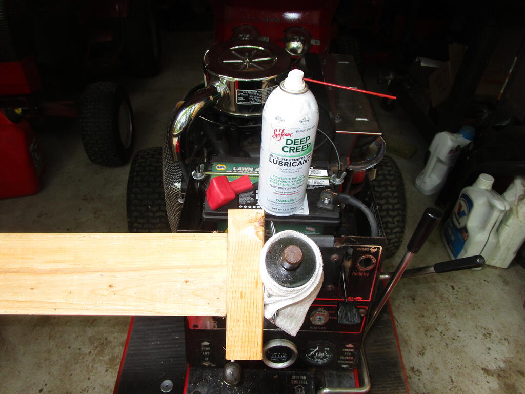

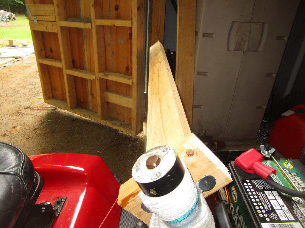

JCM 11,415 #1 Posted July 1, 2023 Been contemplating for some time to do this so I could replace the steering / top console that someone along the line decided to cut a hole in the upper right corner. Also the gauge and shift plate need to have the decals removed and strip and paint all three. I have a source on a replacement top console that is part # 111271 that I am awaiting confirmation. If for some reason that doesn't pan out I will put an add in the classified section here looking for a 400 or 300 series console. both have test lights. Made a support bracket to stabilize the steering shaft and after some deep creep soaking got out the 3/16 snap-on roll pin punch to do its job. The black cover for the shaft is solid on this model unlike the 300 and other 400 series tractors. 2 3 Share this post Link to post Share on other sites

peter lena 10,047 #3 Posted July 1, 2023 @JCM wait you can,t do that ! eliminate wheel bounce , with a wall stud , you been snoopin around in my trouble zone ? only horsing around on that , once I eliminated that bounce , and a solid 3/16 roll punch , in holder , and 3/ lb hammer , pin slid right out .that deep creep , gets it done , pete 2 1 Share this post Link to post Share on other sites
JCM 11,415 #4 Posted July 1, 2023 Once I removed the roll pin Bill, the hub came right off, no puller needed. Steering wheel has a bolt on adapter. 3 Share this post Link to post Share on other sites

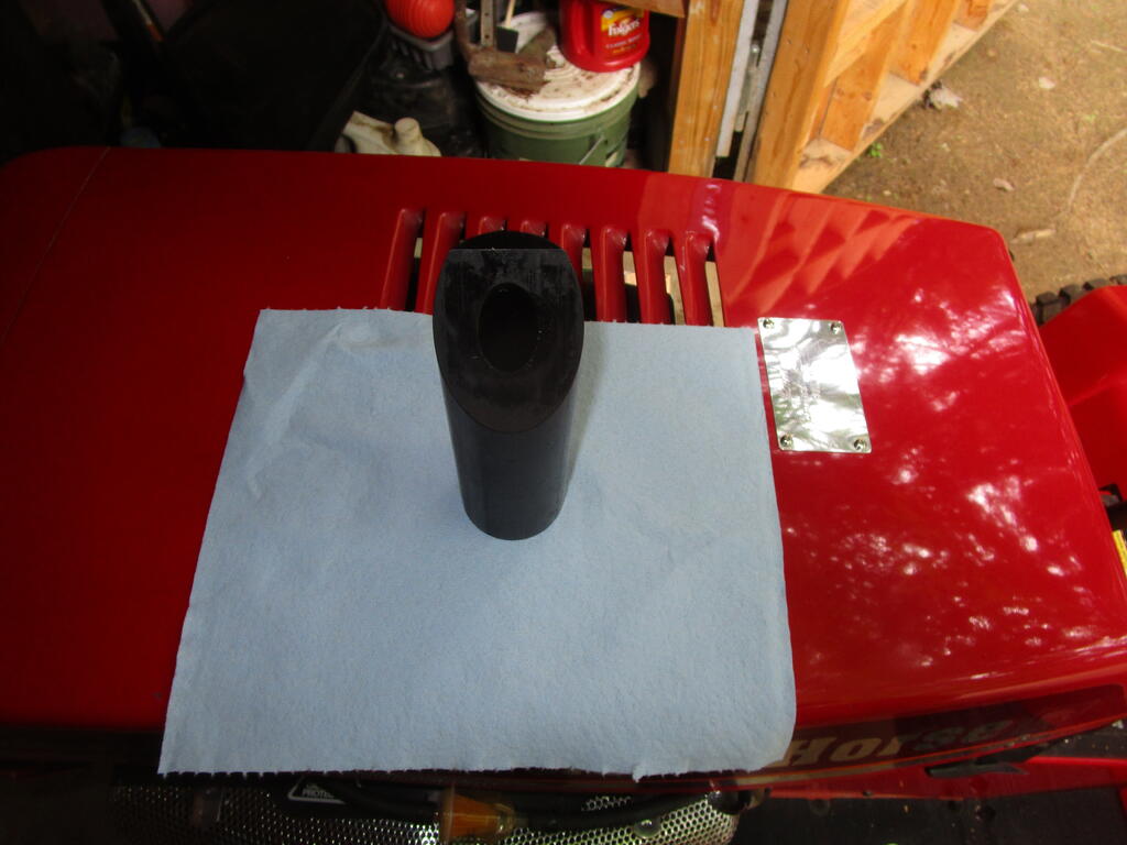

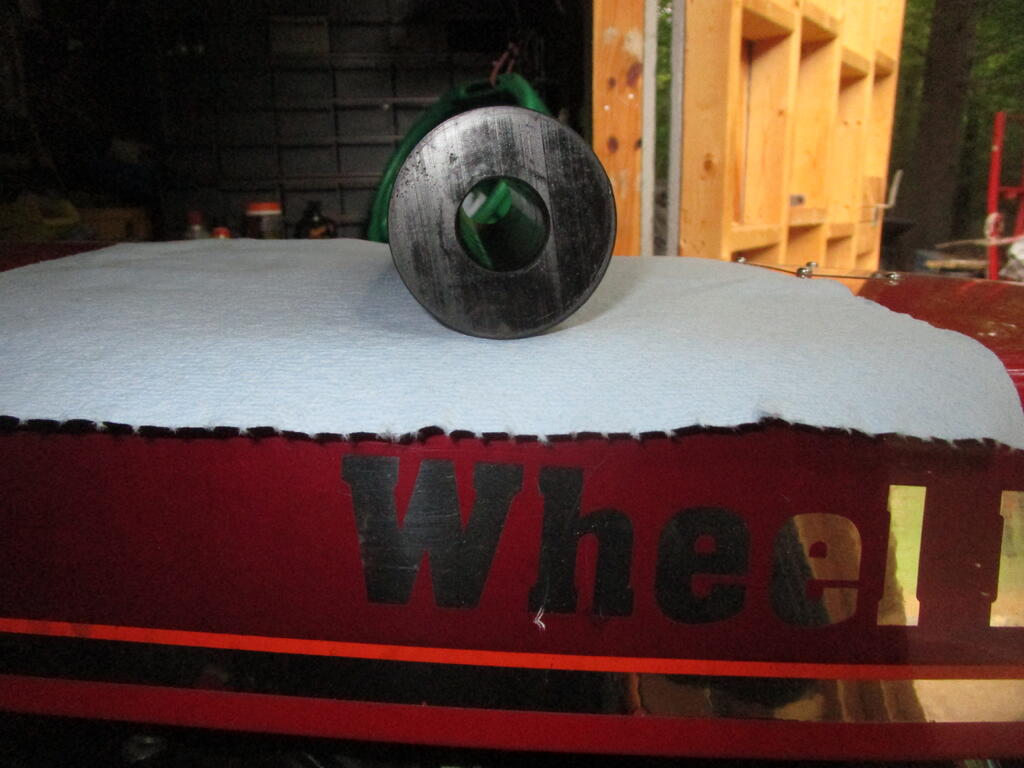

JCM 11,415 #6 Posted July 2, 2023 (edited) The adapter you see on the end of the shaft @ri702bill is held on there by a roll pin. Soaked the pin, made the brace and knocked out the roll pin. I was showing the black cover to everyone so they could see the difference between the 420 solid cover and all other covers that are not solid inside just guides to keep it centered. The cover was not stuck and slid right off. Now the work begins trying to make it look like it did or close to it in 1986. Edited July 2, 2023 by JCM 2 Share this post Link to post Share on other sites
