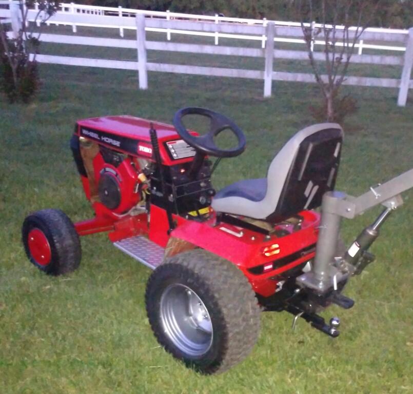

JAinVA 4,638 #2 Posted June 28, 2023 This is my solution. 5 4 Share this post Link to post Share on other sites

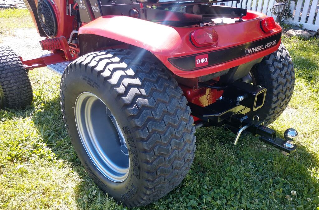

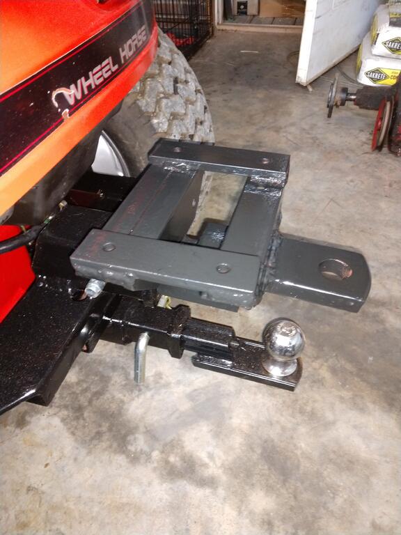

kpinnc 17,297 #4 Posted June 28, 2023 Just put a hitch adapter on both ends, and move the crane as needed... Build a mount plate for the crane onto a receiver, and move as needed. Thank Don (Lee1977) for the idea! And mine was made 100% by a flux core welder BTW. 4 3 Share this post Link to post Share on other sites

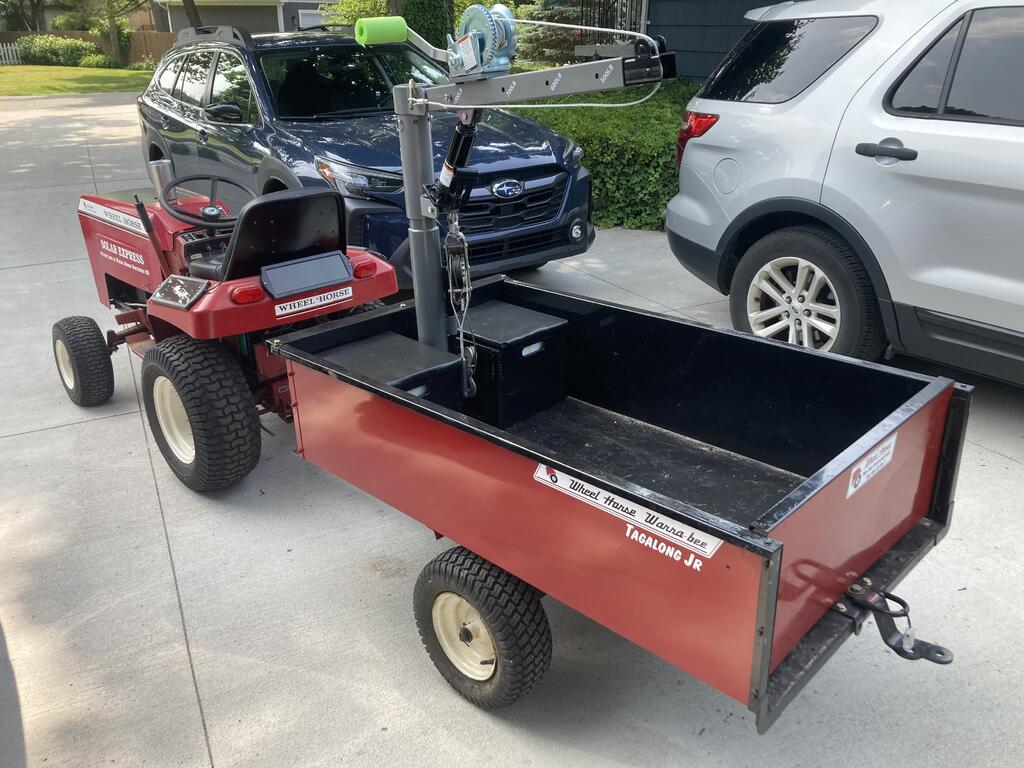

SylvanLakeWH 30,660 #6 Posted June 28, 2023 Just another thought... I just finished this. 1 3 Share this post Link to post Share on other sites

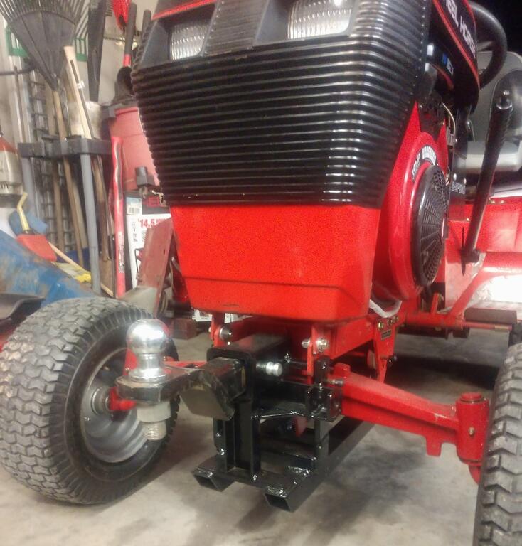

ri702bill 11,418 #9 Posted June 28, 2023 (edited) I like this setup because it is multifunctional and easily removed. Spreads the load out over a longer length than using just the front Tach-a-matic mount. The limiting factor for max lifting weight looks to be the front spindles / bearings / tires. How much is too much - time will tell. Just doing a lift while stationary is easier on everything than lifting and moving.... Bill Edited June 28, 2023 by ri702bill 2 1 Share this post Link to post Share on other sites

ri702bill 11,418 #11 Posted June 28, 2023 12 hours ago, ineedanother said: to reach another attaching point so it could leverage the differential significantly when lifting. I see you have the later style welded hitch - what I call "the Spanker style". It pivots on the hitch pin and puts a lot of upward force on a small patch of the Unidrive casting. There was a thread a while back regarding over loading it and actually breaking the casting. I add a wider plastic pad to the top of the hitch in that area to help spread the load and "level" the tongue of the hitch... 1 1 Share this post Link to post Share on other sites
SylvanLakeWH 30,660 #12 Posted June 28, 2023 2 minutes ago, ri702bill said: I add a wider plastic pad to the top of the hitch in that area to help spread the load and "level" the tongue of the hitch... I do the same, only mine is metal... 2 1 Share this post Link to post Share on other sites

ineedanother 1,908 #17 Posted June 28, 2023 12 hours ago, SylvanLakeWH said: Just another thought... I just finished this. I saw that the other day. Great work. I don't think it will serve the purpose for me right now but I may very well install a plate with reinforcement in my cart so I could bolt it in any time 2 1 Share this post Link to post Share on other sites

ineedanother 1,908 #19 Posted June 28, 2023 17 hours ago, kpinnc said: Build a mount plate for the crane onto a receiver, and move as needed. Thank Don (Lee1977) for the idea! I really think this is what I want to do. I might look at doing something with the spindles too but I'm needing to move stuff well under 500 or so lbs. and no long distances so that might not be necessary. The way work is going this week it might be a month or so before I can even consider this but I really appreciate all of the input. I think this will be a great attachment since stuff seems to get a lot heavier as I get older 3 Share this post Link to post Share on other sites
