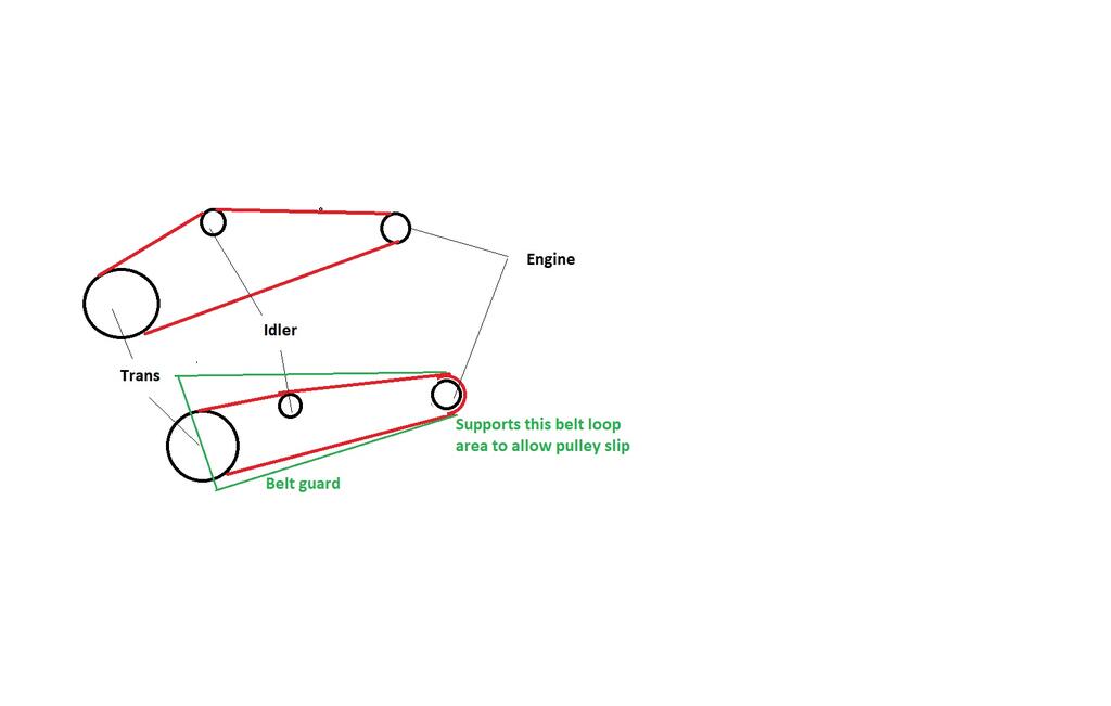

wallfish 18,066 #3 Posted June 26, 2023 (edited) Sounds like the issue is not the transmission. The belt is still spinning/moving after pushing the clutch pedal and therefore it's spinning the transmission pulley. The trans pulley must completely stop turning for shifting. The belt must slip around the engine pulley when the pedal is pushed and that's how the belt stops. The belt guard is what helps support the belt loop around the engine engine pulley so it should be installed. Edited June 26, 2023 by wallfish 2 Share this post Link to post Share on other sites
