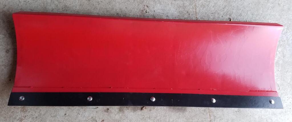

Brockport Bill 2,379 #7 Posted June 24, 2023 consider painting the wear edge bar black just for a "cool " look 1 Share this post Link to post Share on other sites
Brockport Bill 2,379 #8 Posted June 24, 2023 black painted wear bar -- plus new carriage bolts 1 4 Share this post Link to post Share on other sites

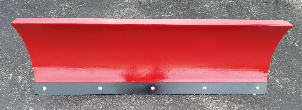

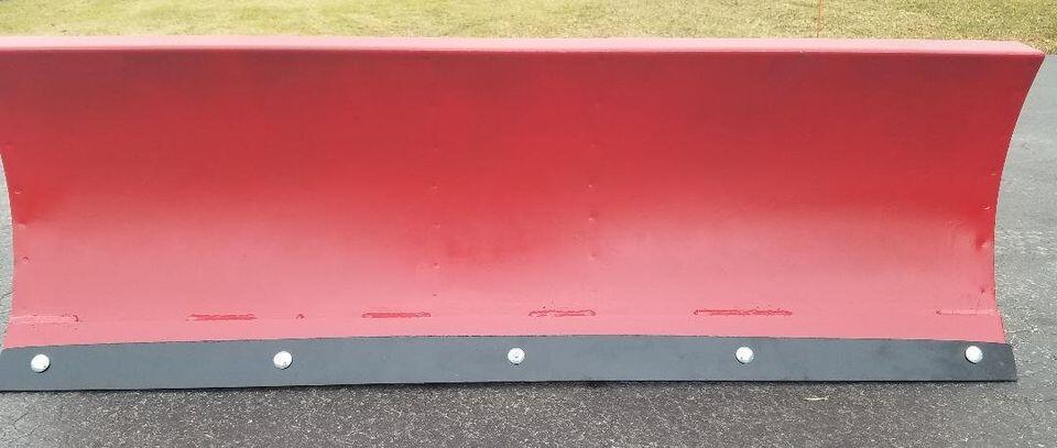

Brockport Bill 2,379 #9 Posted June 24, 2023 heres another plow with black wear bar and new bolt hardware 3 1 Share this post Link to post Share on other sites

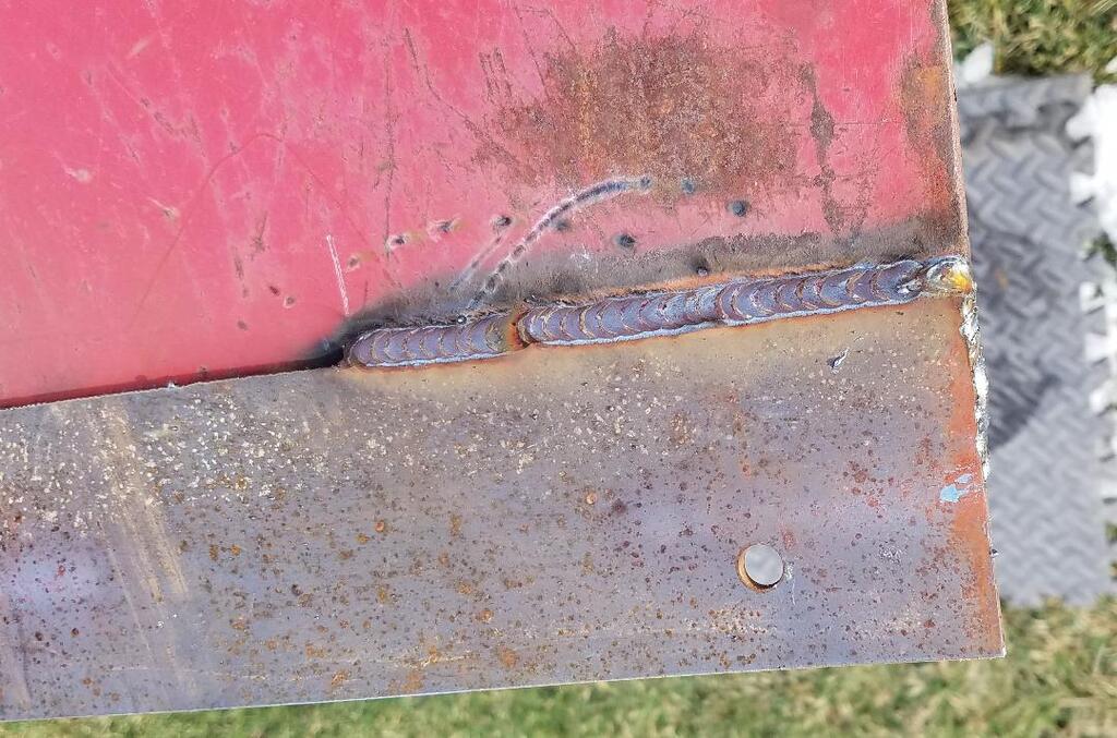

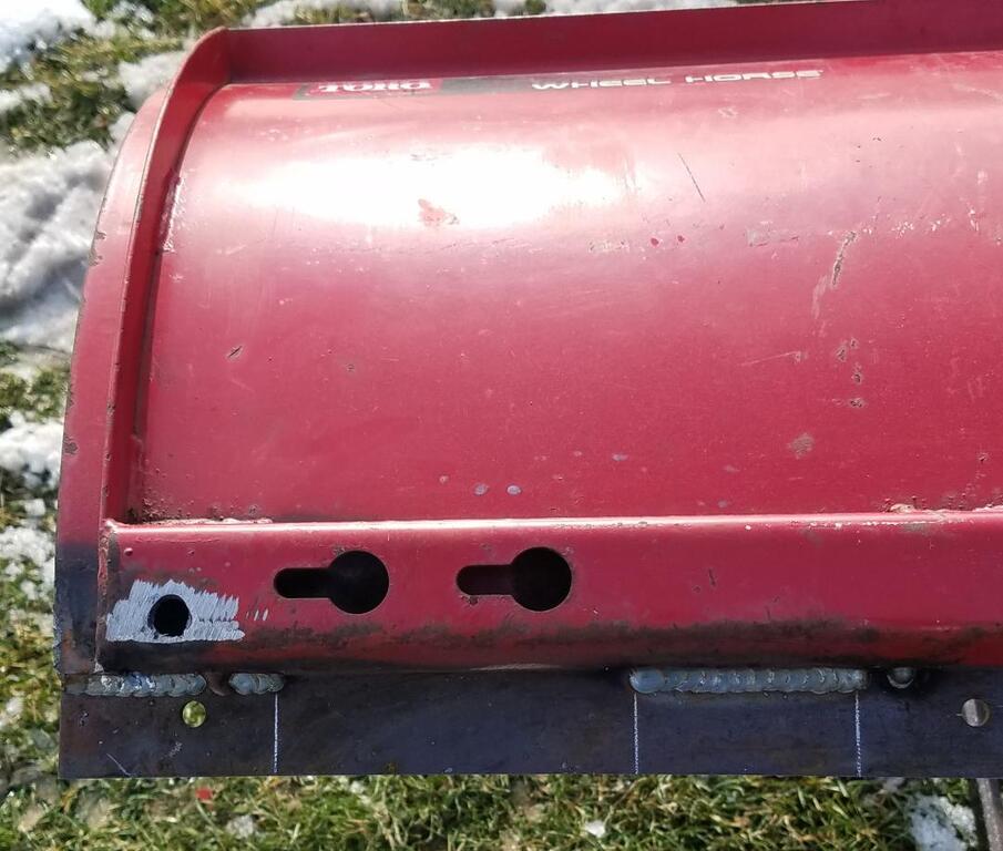

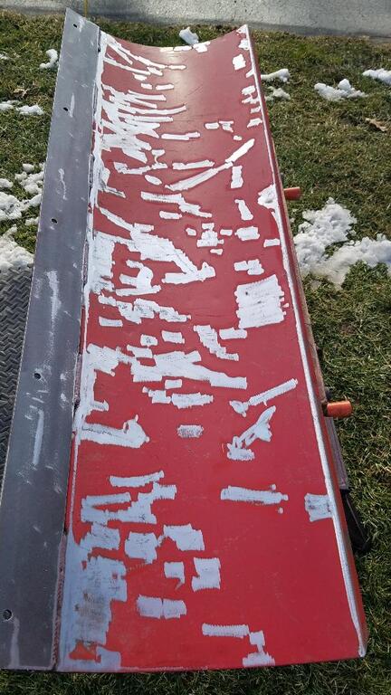

Brockport Bill 2,379 #11 Posted June 25, 2023 5 hours ago, peter lena said: @Brockport Bill as you know its very easy to turn over that wear edge , or replace , seen too many plows destroid down to plow edge , keeping an eye on your stuff . is what its all about . pete yes Pete -- i have also seen plows ruined with neglect of the wear bar - including worn so far that the holes in the blade itself are worn so the holes are gone -- and nothing to hold the carriage bolts -- i recently acquired a plow with wear blade worn so far that a new wear blade had no holes to attach to the plow unit -- so ---- i took plow blade to welder and had him attach new steel plate to extend bottom of plow by couple inches...... plus, he cut new holes in the new plate for the carriage bolts to attach the wear blade -- here are some photos of the plow -- i cleaned up the surface rust on any damaged scars on plow with 90 degree grinder and then primed and painted -- then attached the wear blade with new carriage bolts -- plow now will last for many more years -- with proper care !!!!!!!!!!!! 1 Share this post Link to post Share on other sites
