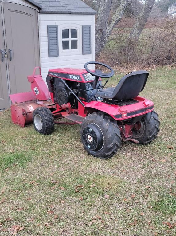

Russ Piper 0 #1 Posted June 23, 2023 I am getting ready to buy a 312-8 for working in my garden. It has turf tires on it now, but I would like to go with a pretty aggressive AG tire. I'm looking the tire size up and it shows 22x9-12, what would you all recommend. I'd also take suggestions and any advice you might have as well. Share this post Link to post Share on other sites
ebinmaine 80,653 #2 Posted June 23, 2023 I use and recommend Carlisle Tru Power AG tires. That said, there are plenty of perfectly good other options. The only one I'd recommend shying away from is the Deestone brand AG. Not because they're inferior in build. They run VERY VERY small by listed size. 3 1 Share this post Link to post Share on other sites
OutdoorEnvy 1,817 #3 Posted June 23, 2023 23x9.5-12 will be more common with more options. I think that or 23x8.5-12 would be a safe bet with rims it most likely has are in the 7-8” range. 312-8 is a great all round rig though. Should be a solid garden worker for you 2 1 Share this post Link to post Share on other sites
