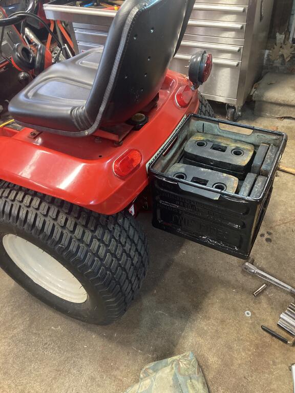

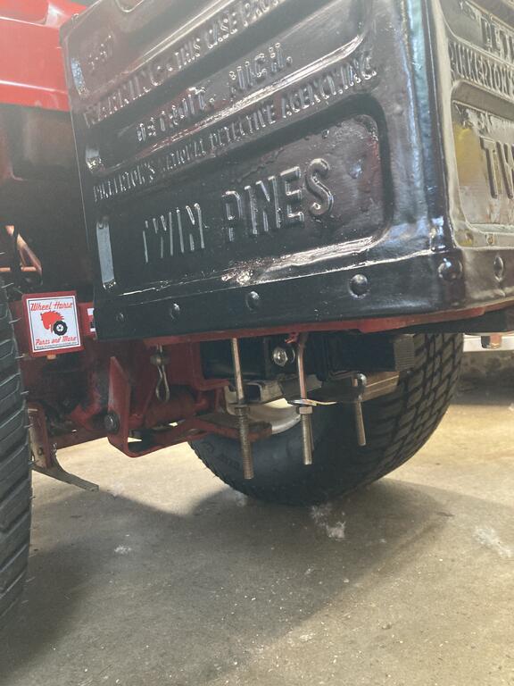

SylvanLakeWH 30,660 #1 Posted June 23, 2023 (edited) So after years of listening to @ebinmaine and @Ed Kennell and others drone on and on and on... and on... about the virtues of added weight for plowing snow. And having tried to gain said weight through beer and cashew consumption, to the point of annoying Mrs. Sylvan ... I have surrendered to the weight lords ... 200 lbs. (Free trash day pick up.) Crate was from my late Dad's garage when we moved him out of the house... Other than paint, all parts came from stock piles, no $$$ spent on this little addition to the C105. I expect traction miracles this coming winter... Edited June 23, 2023 by SylvanLakeWH 2 3 1 Share this post Link to post Share on other sites

ri702bill 11,418 #3 Posted June 23, 2023 Nice!! 200 lbs of rather easy to install / remove and stack weights is good. I use 150 pounds of lead ingots in the toolbox under the seat on the 854. I do prefer the weight to be in / on the tires to give the Unidrive bearings a break. Well done. 1 1 Share this post Link to post Share on other sites
OutdoorEnvy 1,807 #4 Posted June 23, 2023 Looks like a good grab and positioning looks nice. I’ll await the winter verdict on how much more effective it is. 1 1 Share this post Link to post Share on other sites

SylvanLakeWH 30,660 #12 Posted June 24, 2023 I put a small 4" x 4" or so steel plate between the trans case and the back of the draw bar where it hits the case. Spreads the weight and eliminates the single pressure point on the case. 2 Share this post Link to post Share on other sites
