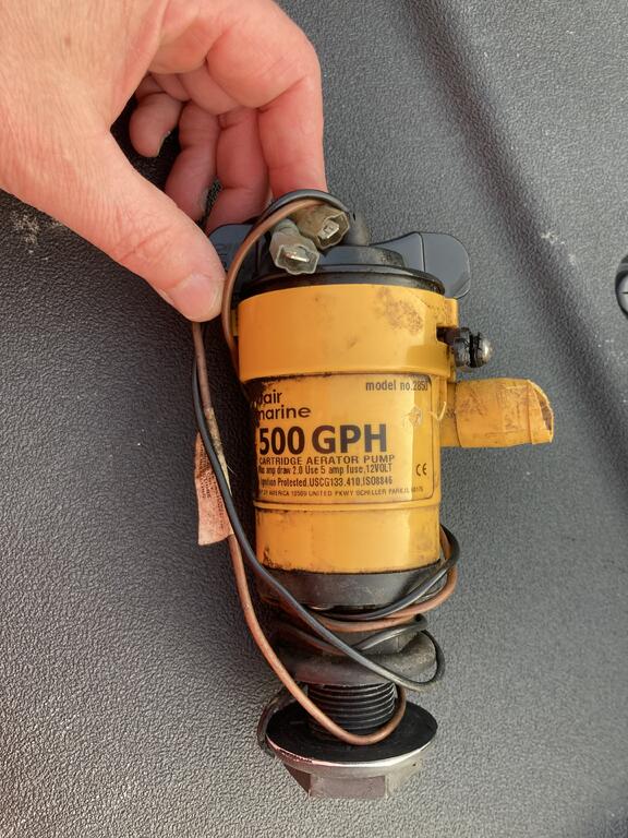

wh500special 2,464 #1 Posted June 18, 2023 (edited) I had a bit of a surprise and scare yesterday. Launched the boat as usual and began fishing immediately at the ramp, working my way out toward the main lake. So I was standing in the front of the boat running the trolling motor and casting the bank, oblivious to what was going on under the deck. After about an hour and a half if this I pulled up the trolling motor and went to the back of the boat to fire up the engine. When I put it in gear and started to accelerate all of a sudden my shoes got soaked with water. It seems that the boat was completely flooded from front to back and when i took off the water all sloshed to the back. It had been hiding under the floor boards so I was blissfully unaware I had been sinking. I turned the bilge pump on and I started scrambling, making sure I’d put the plug in. I had. I felt around in the bilge for the source of the leak but didn’t find it. So I headed back to the ramp quickly and beached the boat instead of using the dock while i retrieved the truck…I figured it was better to have it sink in 2’ of water than at the end of the dock in 15. Thankfully there was no lineup and I hit the trailer perfectly the first time and got pulled out. The boat was heavy on the trailer and tires were rubbing the fenders as I pulled up the hill. After draining what seemed like ten thousand gallons of water out of the boat I found the source of the leak: the barb fitting feeding the live wells from the live well pump had broken off thus leaving a 5/8” diameter hole just freely flowing water into the boat. I’m not sure the bilge pump would keep up with a leak that size. The boat is a 2003 and the pump was original. I guess the combined effects of plastic embrittlement and years of the hose weighing on the plastic barb took its toll. Picture shows the broken barb on the pump. I’ve heard of this happening before. And it also apparently happens on other plastic through-hull fittings as well. So it looks like I have a few hours of replacing fittings and hoses on my hands in the near future. The pump showed no signs of breaking before this happened. I think I’ll add an automatic bilge pump while I’m at it too… Usually I motor away from the ramp and fish my way back through the course of the day. I’m glad I was off-pattern today since it would have been problematic to have been several miles down the lake when this was discovered. I’ve never had this much water in a boat before. The top the transom almost went under when it all sloshed rearward as I accelerated. There is a lot of foam in the boat so I don’t think it would have sunk completely but it was still a puckering moment. Got lucky. Check those through hulls! Steve Edited June 18, 2023 by wh500special 8 1 1 Share this post Link to post Share on other sites

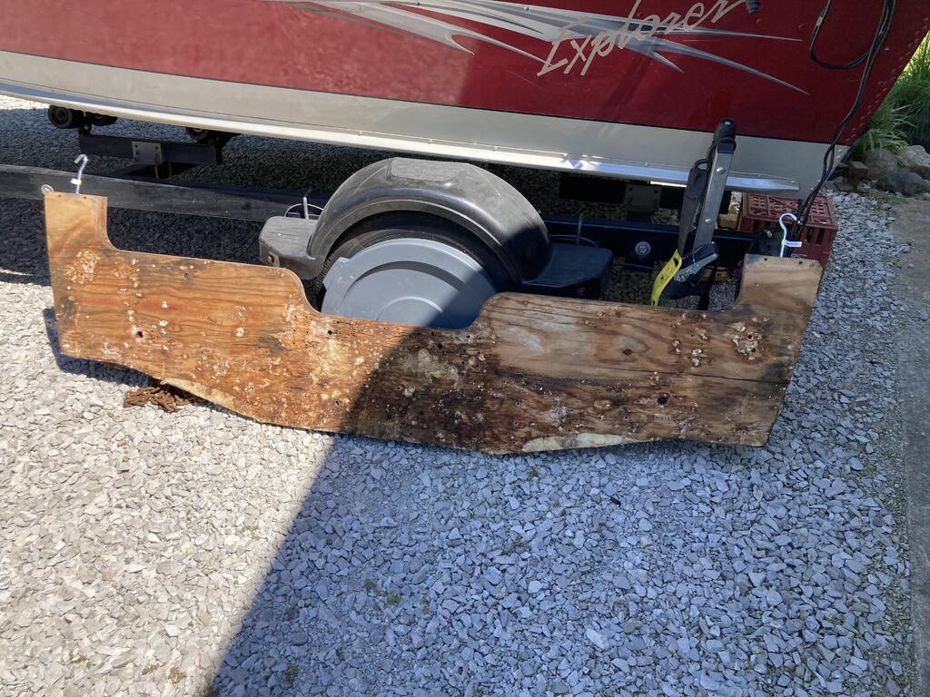

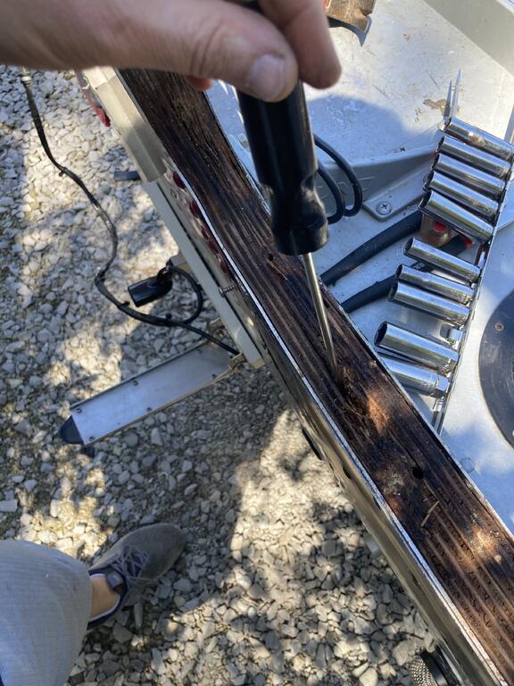

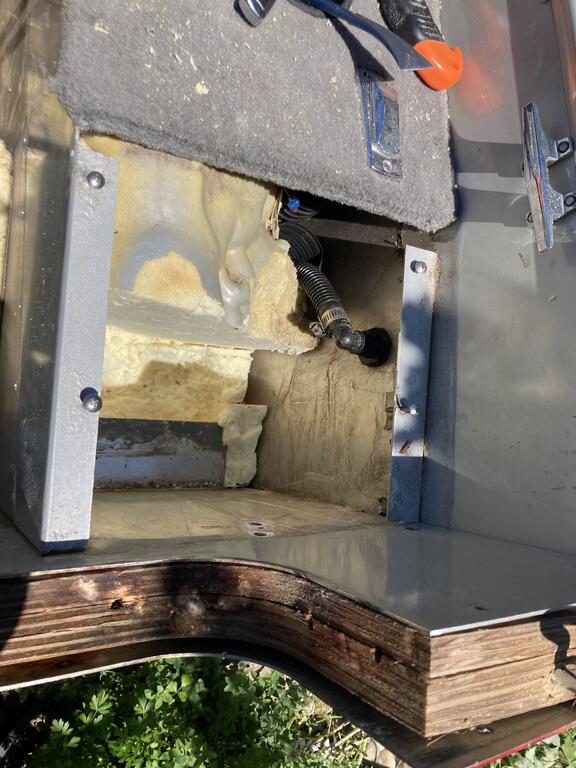

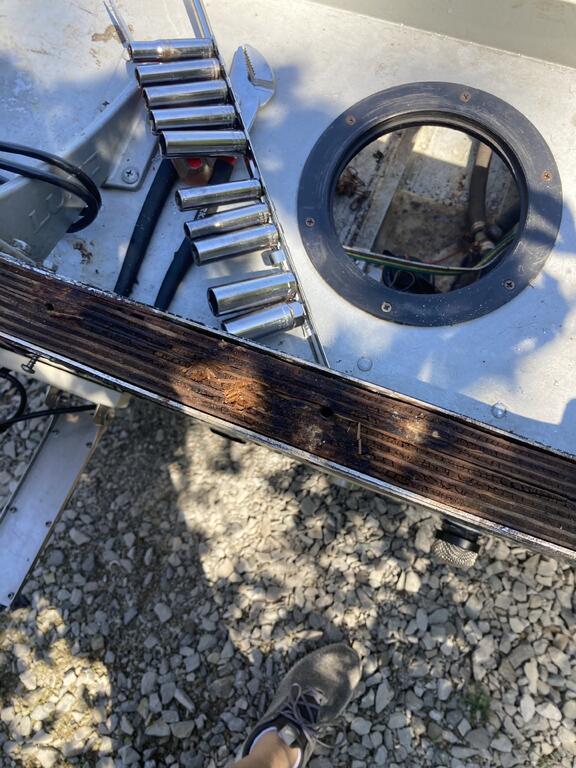

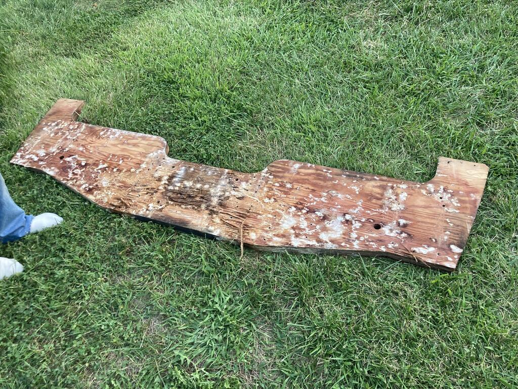

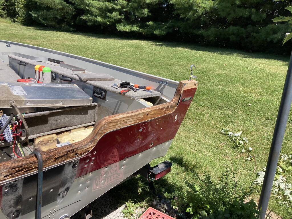

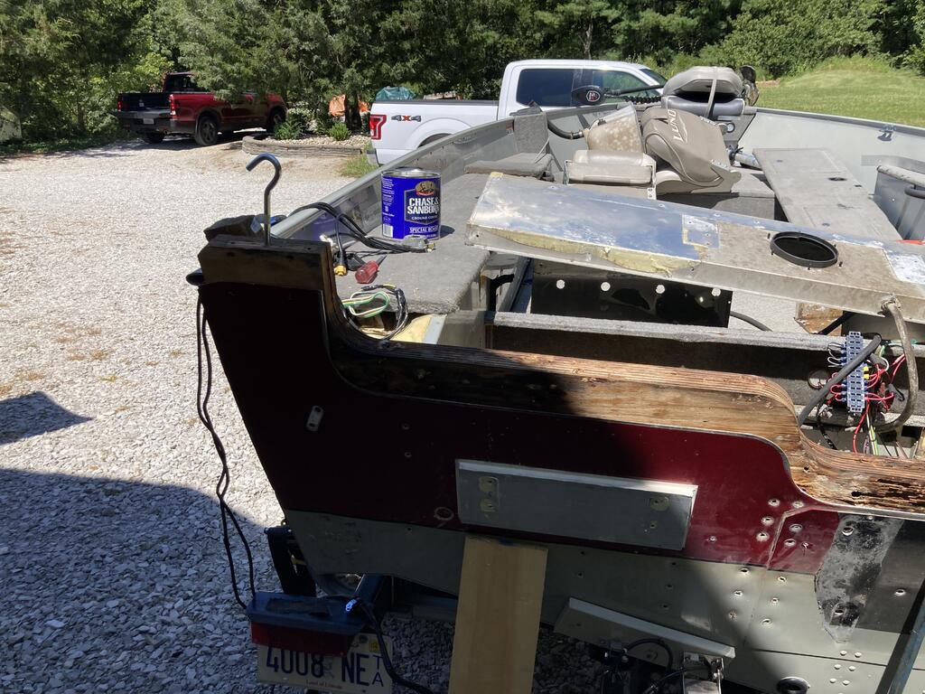

wh500special 2,464 #20 Posted August 30, 2023 (edited) A little update to this…as it turns out, I think the broken livewell pump was a symptom and not the disease. Replacing the pump was fast and easy. The old one came right out and I put the new one in. No issues. On the first test run when i went fishing I ended the day with a little bit of water in the bilge. This boat has never leaked, so I assumed I botched the install. I tinkered with everything a bit and resealed the nut holding the thing in place. Took the family swimming. Looked in the bilge and saw a little water again. Darn it. Looked the best i could and it seemed like the water was coming in above the pump. That’s odd. Couldn’t do anything about it on the water and it wasn’t leaking bad, so we swam and messed around a bit longer. When i was climbing back in the boat over the transom (I have a transom mounted ladder on the back) I saw some separation between the aluminum transom skin and the trim piece that caps the transom. Immediately I knew the problem… it seems I have rotten transom board. This is somewhat of an endemic problem to Lunds of this vintage. Any leaks in the 45713 bolts and rivets that go through the transom lets the plywood core get wet. Since the plywood is mostly encased in aluminum it takes forever to dry out, so it rots. I didn’t notice prior, but the rotten board let the transom flex quite a bit and i suspect it’s what stressed the pump and snapped it off. It’s not a hard job, but it is apparently tedious due to all the disassembly required. So I have the plywood in the garage, sealant on order, and will be working on it this weekend. Took the motor off the boat this evening after work and stuck it on a stand I knocked together. The boat looks really goofy - and super wide- without it adorning the stern. And the tongue weight increased immensely without that 390 pound anchor cantilevered off the back. a few pix follow of the motor being liberated from where it was bolted 20 years ago. My plan is more or less to mimic what Lund did with some minimal improvements. The plywood is marine grade, but that doesn’t mean it’s treated. It’s just that it has a lot of plies, waterproof glue, and no voids. I’ll laminate it to 1.5” thick and soak it with epoxy. Take care to seal all holes, etc. There are composite products available and I could make something better than plywood (I’m a composites engineer), but this lasted 20 years and the stiffness of plywood is a known and is better than some of the available surrogates. And plywood is light and very well suited to this application. Boats are so much fun. Steve Edited September 3, 2023 by wh500special 1 Share this post Link to post Share on other sites
Sailman 1,307 #21 Posted August 30, 2023 The rot in the transom is a common problem on older boats. Use fiberglass to scarf it onto the healthy parts and lots of epoxy and she will last another 20 years.... or more. 1 Share this post Link to post Share on other sites

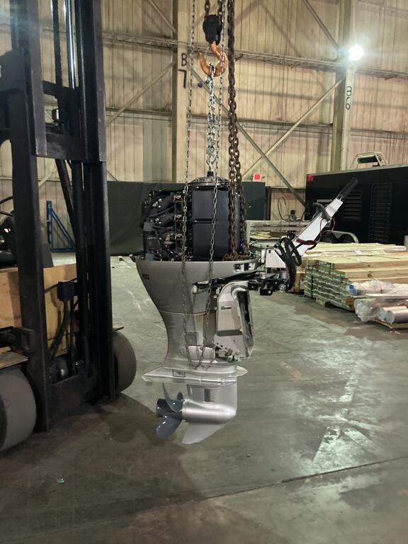

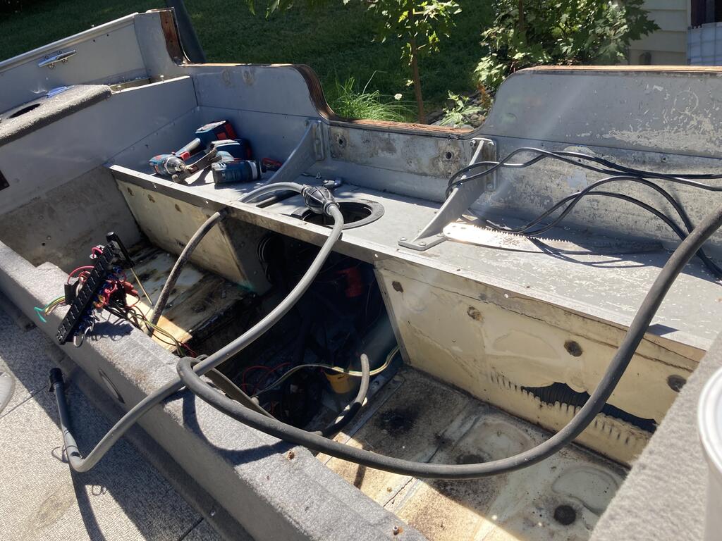

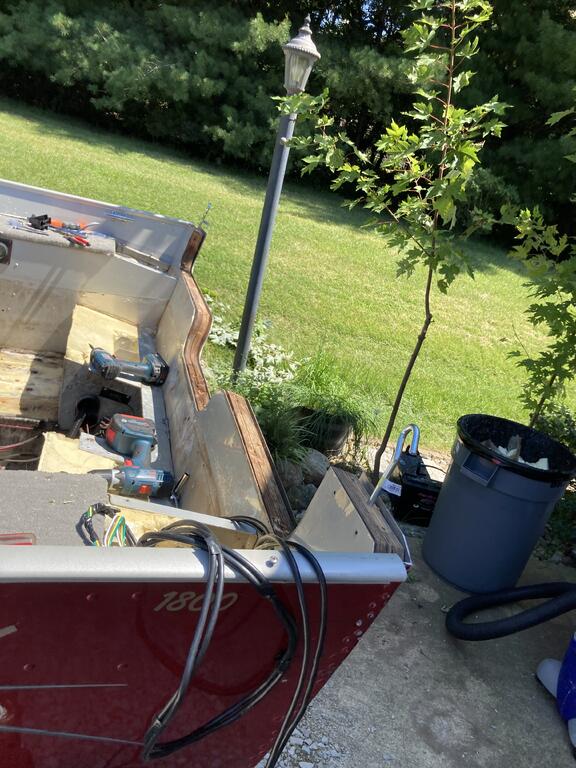

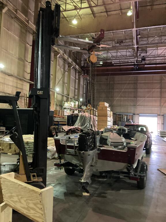

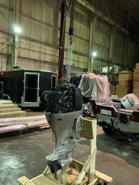

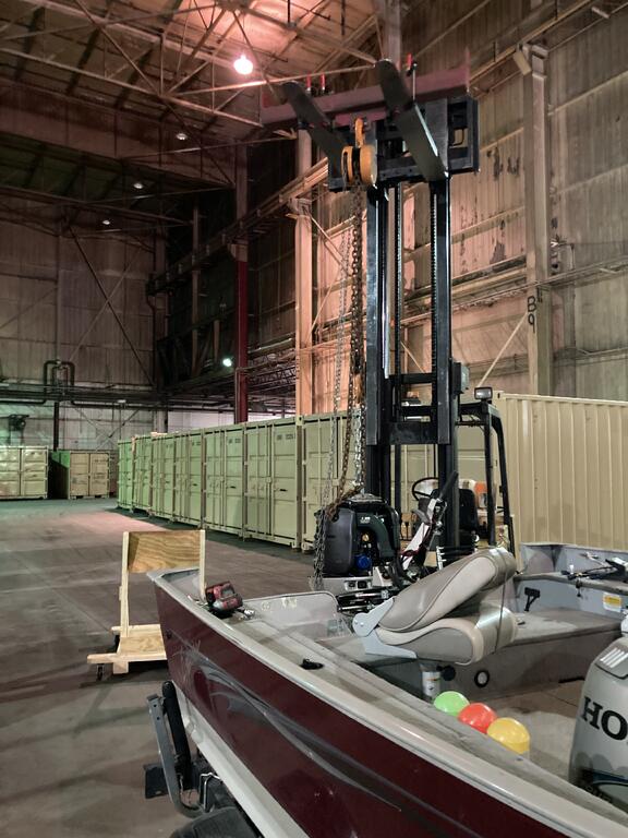

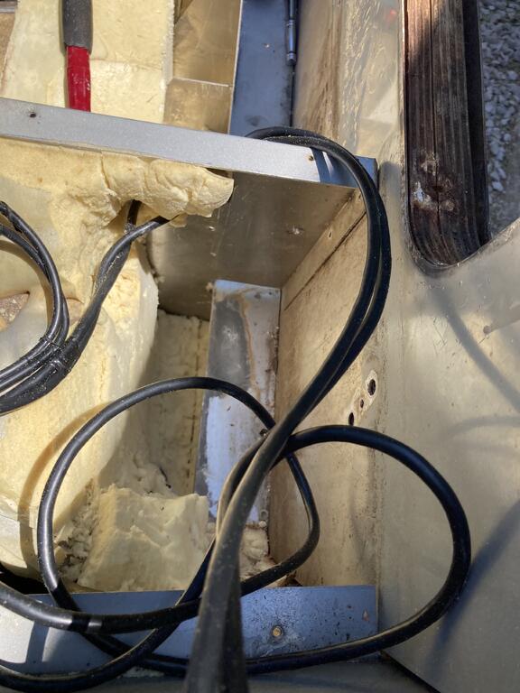

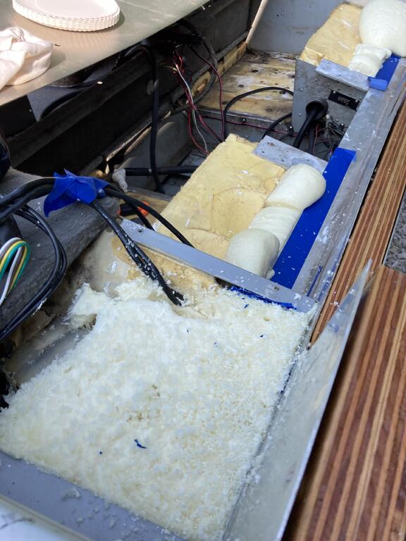

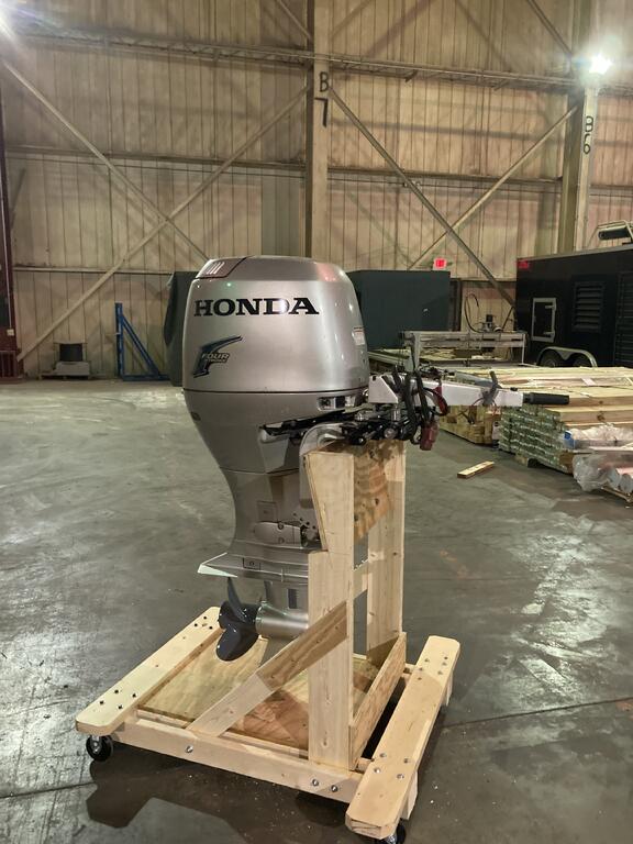

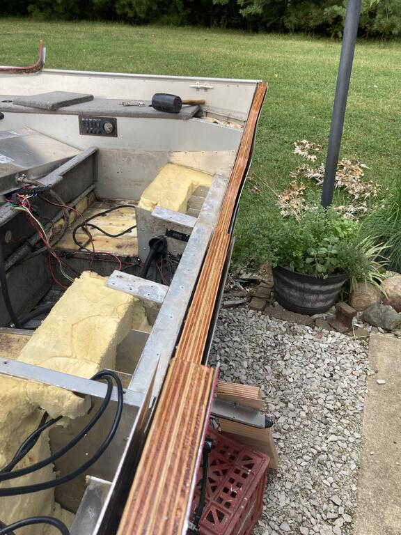

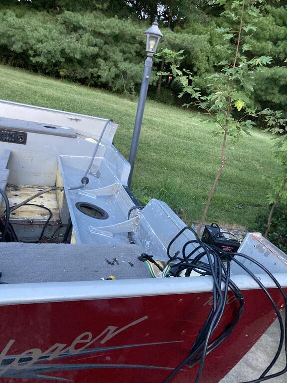

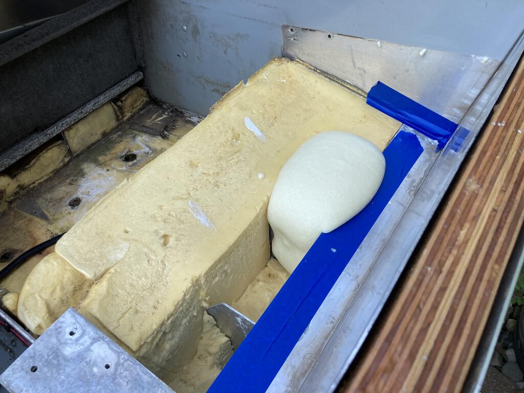

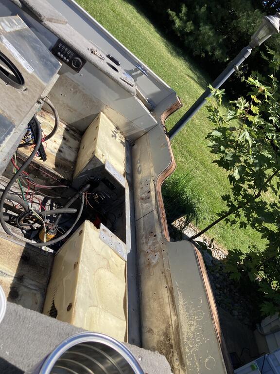

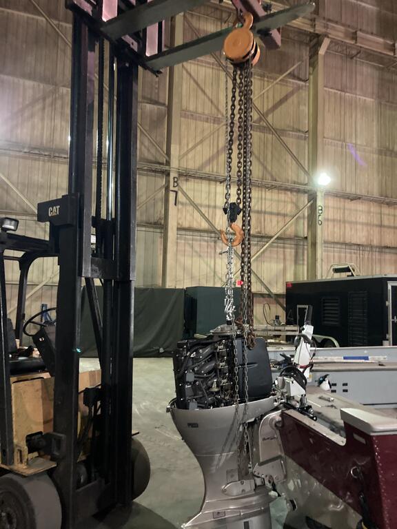

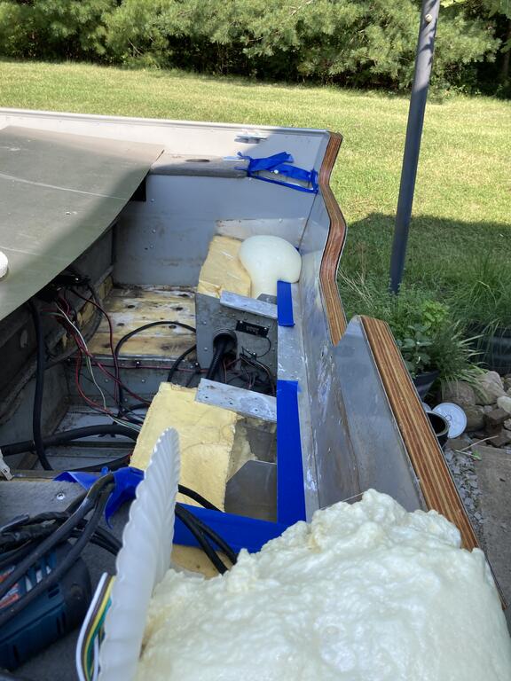

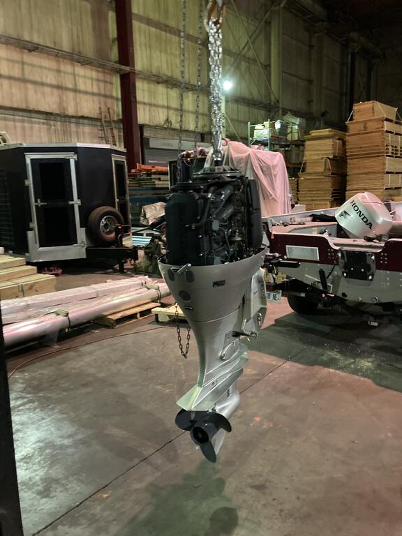

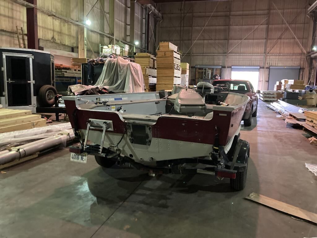

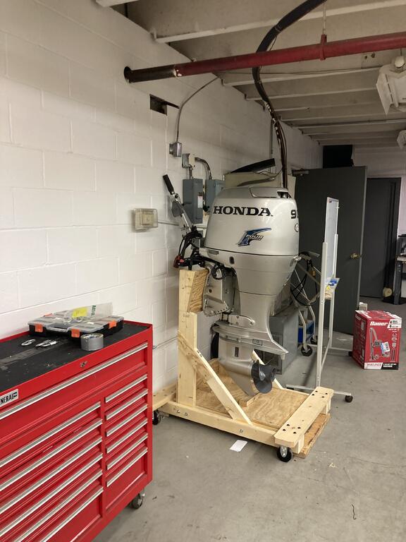

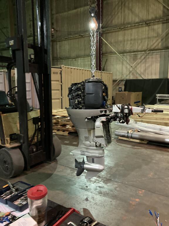

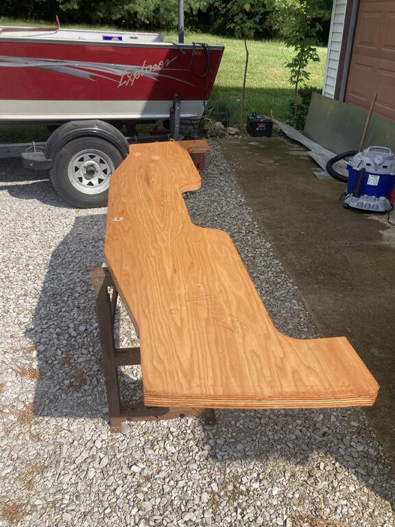

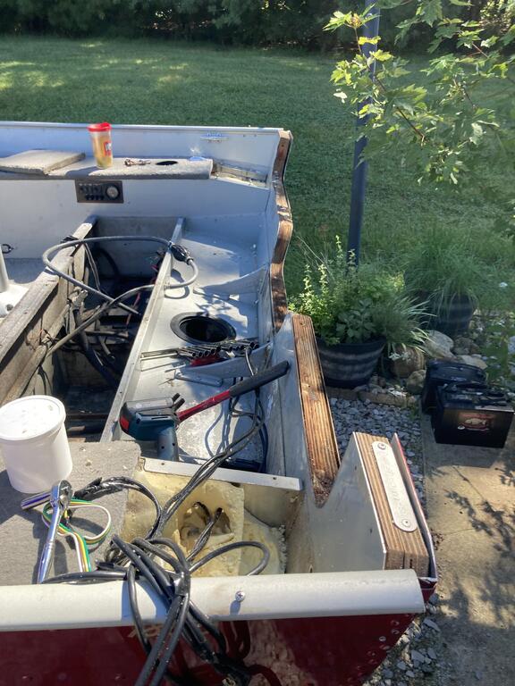

wh500special 2,464 #22 Posted September 3, 2023 (edited) I figure I might as well keep this thread going. Made a little progress the last two days. I figure i have about 10 hours into this so far, not including building the stand for the motor and taking it off the other day. I didn’t take any pix before I started ripping the boat apart as it didn’t cross my mind until I’d started, but did take some progress pictures once the thing started to look like it was being sacrificed for salvage. First step after the motor came off was to remove the rear platform. It houses a livewell and a battery storage compartment. Just a bunch of screws, some #10 bolts, and a handful of stainless steel pop rivets. took the transom cap off to expose the plywood which had some soft spots but didn’t seem too bad. Corner caps came off. Then had to remove some aluminum panels and the splashwell to expose the floatation foam that was injected after these panels were riveted in place during assembly. That foam covered access to the majority of the bolts and nuts that went through the transom and connected it to the longitudinal stringers of the boat. I got pretty good at drilling out the solid rivets Lund used everywhere appearance matters. They use pop rivets in places where they don’t have access to both sides or where they are out of sight. Unfortunately, several of these pop rivets that were installed into the transom skin itself are not sealing type rivets and there was a paucity of sealant on them, so they are a bit suspect as contributing to the rotting of the plywood core. With the metal parts out of the way I began removing flotation foam where needed to access hardware. I found a pruning saw and a drill with a spade bit was a good combo to extricate the stuff. It was quite tedious as there are conduits encapsulated in the foam that I didn’t want to damage and there are a lot of spots where I couldn’t get tools. So there I had to shove my hands in and use just my fingertips to peel it out in small chunks. in case anyone is worried I’ll leave these big cavities open, we use this sort of foam at work so I will be able to replace whatever I remove. As is characteristic of poured flotation foam, there are a lot of areas where the foam is holding water inside it. When this stuff is new the cells are mostly closed and the water absorption is minimal. But over time it takes up more water than anyone would ever want to admit. The wet foam was actually in direct contact with the lowest edges of the plywood board. I’m not sure which got the other wet or if it’s a synergistic thing. I have to say i am greatly disappointed by Lund’s workmanship. Several of the 48 bolts (I counted them) that hold the boat together were cross threaded. A bunch were drilled through the transom at random angles instead of straight, so apparently they don’t use jigs or machines for this and instead eyeball it. eventually, we (dad is helping) got the board out in one piece so I fortunately have a template to cut the new one. This was a combination of a couple of big screw hooks, prybars, and the loader on dad’s Kubota. Getting it in one piece is a bit of a relief because fitting it in there blindly would probably be quite the process of trial and error. The plywood that only seemed rotten in a few spots is actually rotten across the entire width, height, and thickness with only a few solid spots. It’s worse than I thought but it was amazingly still doing its job pretty well considering. the original board is 1.625” thick. Of course my 3/4 plywood replacement will be doubled to 1.5” so I need to find a scrap of aluminum or fiberglass to make up the difference. I went ahead and dropped by work to take advantage of our laminate press to bond the two pieces of plywood together under pressure. So that should come out tomorrow perfectly flat. Next will be laminating whatever piece I find to make up that 1/8” thickness and then transfer the shape to the new core. I am figuring I’ll rough it out with a track saw and jigsaw and then trim it the rest of the way with a router using a template following bit on the old core. Then to seal with epoxy and install. This is gonna take another couple days I think before i even start putting the boat back together. Something I noticed is that there is probably no way to keep water out of this thing. Water in the bilge of the boat can soak the foam and then the board. Or, if deep enough can soak the board directly. Rainwater can run down the sides of the boat into the cavity where the board lives. Leaks through the hardware can get it wet inside. But it lasted 20 years like this so another 20 puts me at an age where I’ll probably not have this boat anymore…hopefully I’m still around then. I do plan to seal the new wood, but I’m a little torn. Sealing it theoretically can help keep water out of it, but if any does get inside there is a good chance it will never get out. It would be nice if this was able to breathe a little bit. Anyway, it’s not been a hard task but it does take a while. I worked until the mosquitos found me and I had to abort. I see reports online of guys paying $4000 or more to have this done. Hmmm…maybe i should consider a side hustle through the winter. 😜 Anyway, pix follow. Hopefully in the right order. Steve Edited September 3, 2023 by wh500special 1 Share this post Link to post Share on other sites

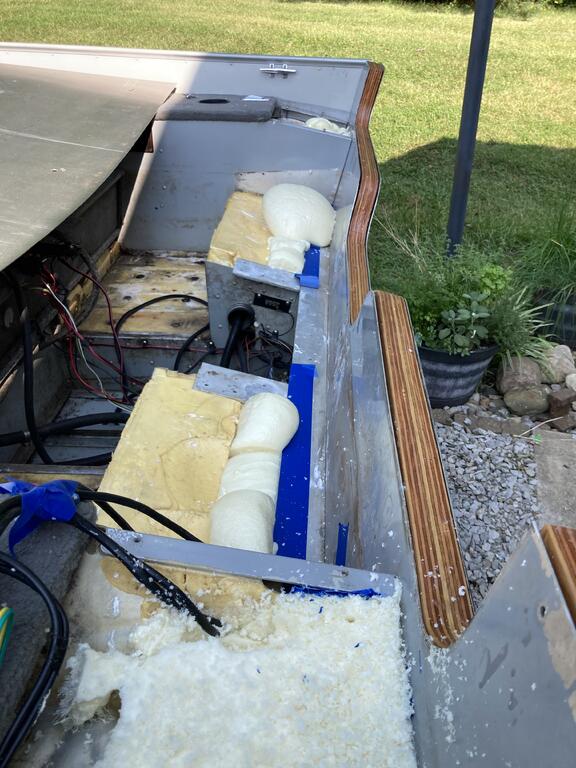

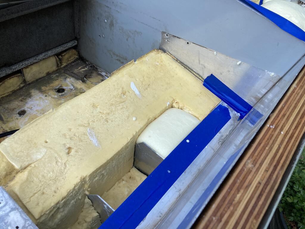

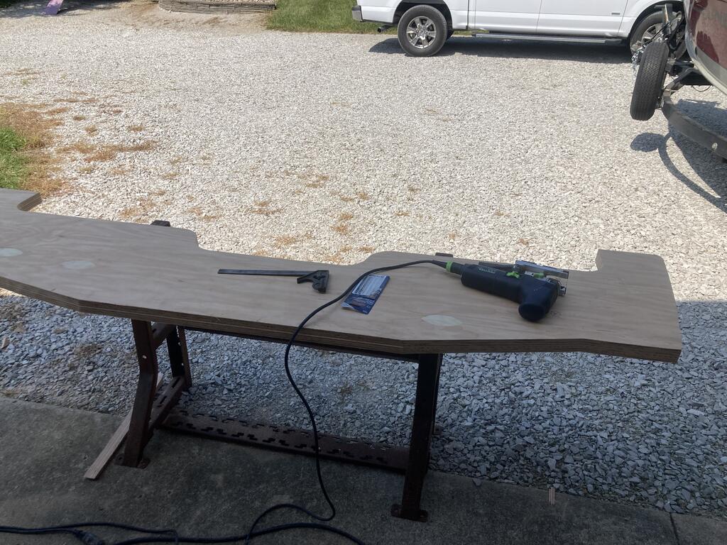

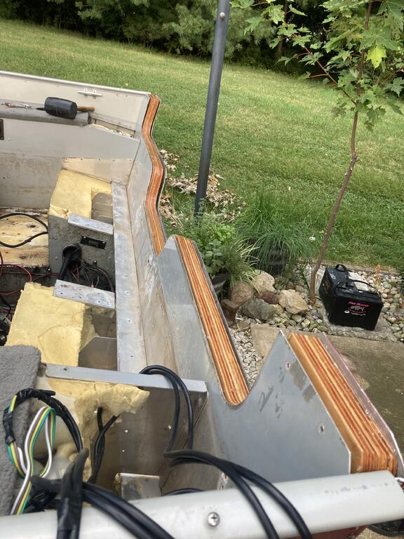

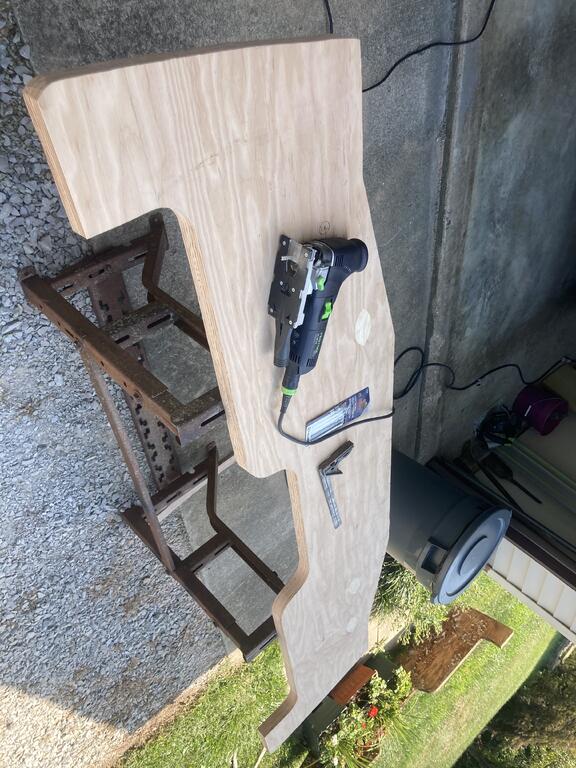

wh500special 2,464 #23 Posted September 5, 2023 Got the board laminated, cut to shape, and sealed with resin. It slipped right into place and I got a couple bolts installed to hold it in place before the humidity-driven torrents came today. Hopefully will be able to work on it some this week. A few pictures follow. Steve 1 2 Share this post Link to post Share on other sites

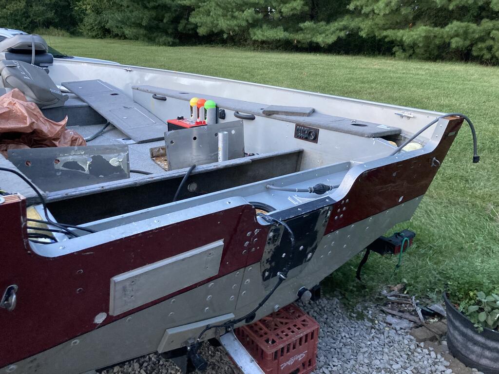

wh500special 2,464 #24 Posted September 11, 2023 I’m getting closer. With work and kids’ stuff it’s hard to find big enough blocks of time to make progress, but I did spend part of today and some of Friday night working. As shown previously, the new board went right in. A lot of my time after that was spent drilling the holes through for the various bolts and installing them. Each one gets slathered in 3M marine sealant before installation so it’s a bit of a messy process. Then need to clean off everything that squishes out before it sets. Using a lot of acetone and old rags. Drilling was done with one of those drill press things that mounts to a hand drill. Works nice to keep them pretty straight. There were a handful where my drill press thing wouldn’t fit properly so I milled a hole straight through an aluminum block to make a pseudo drill bushing jig and it worked beautifully. I poured a bunch of polyisocyanurate floatation foam to replace what I’d hacked away during the demolition. I had forgotten how much it expands so it got away from me on a couple of pours as you can see, but it’s ready to trim with a pruning saw after a few minutes of cure time. Splash well Is in. It took a bunch of rivets. Transom cap is on. About a dozen sheetmetal screws for that. Only things left are to drill the 1” holes for the splash well drains, swage in the drain tubes, mount the ladder, put the rear deck on, install the two rear corner caps, and hang the motor. I figure maybe another 6 hours all in. That will put this at about 20 hours of work. I bet now that I’ve been through it I could shave several hours from the project if I had to do it again. Wasn’t too bad, but i would have rather been fishin’. The end is in sight. Steve 1 2 Share this post Link to post Share on other sites

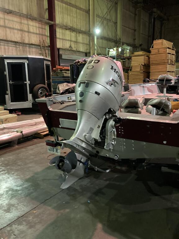

wh500special 2,464 #25 Posted September 16, 2023 Well, got the motor back on. Only things remaining are to mount the ladder and the splash well drain tubes. Either I was super prepared or I got exceptionally lucky because this was about as effortless as could be. Despite having to drill new holes, everything lined up perfectly and I managed to push the boat on its trailer exactly into the right position for the bolts to slip through on the first attempt. I’m thankful that we have so many tools and pieces of equipment at work that I can appropriate when needed for these extracurricular activities. I’ve had this boat for about 5-years or so. Since I’ve had it I’ve been frustrated that it always had a tendency for the transom tie down straps to loosen up when being trailered. With the new transom in place I towed it 30 miles back to work and the straps were both still as tight as they were when I attached them. Apparently I had enough flex before to cause them to loosen. Lesson learned. Almost done. Just in time for fall Crappie. Steve 1 3 Share this post Link to post Share on other sites
