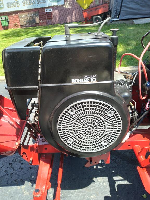

D_Mac 9,330 #26 Posted June 21, 2023 Ahhh this FREE machine came with a 48 inch deck. I have yet to put it on. It's all there and soils as a rock 23 minutes ago, Rick3478 said: The 6" wheels are necessary for the 37" two blade mower deck, with 8" you can't turn left. AFAIK none of the other implements care. Share this post Link to post Share on other sites

tunahead72 2,581 #28 Posted June 21, 2023 48 minutes ago, D_Mac said: Ahhh this FREE machine came with a 48 inch deck. I have yet to put it on. It's all there and soils as a rock ... Be aware, that 48" deck might be too much for your 10HP engine to handle. I'm sure it depends on your grass and the terrain and a whole lot of other factors, but Wheel Horse didn't generally recommend anything less than 12 HP for that deck. But for free, I would certainly give it a shot and see how it works. 1 1 Share this post Link to post Share on other sites

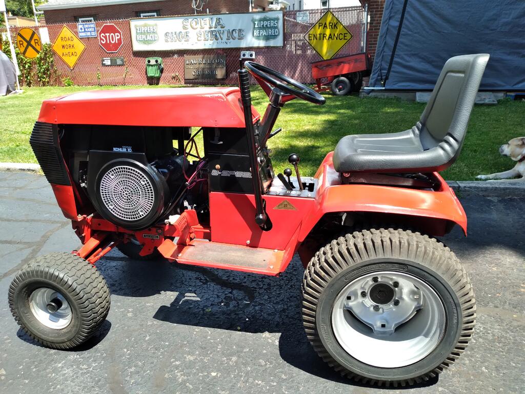

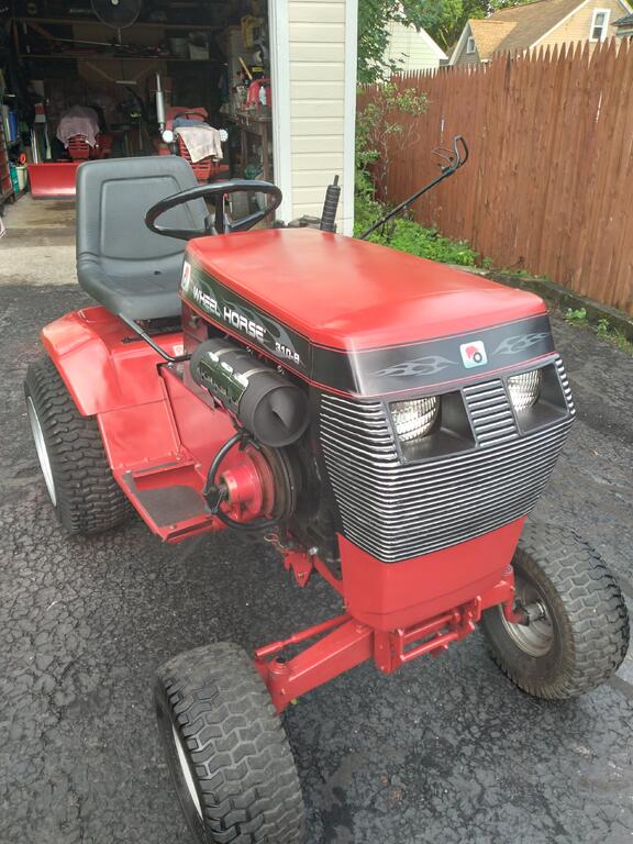

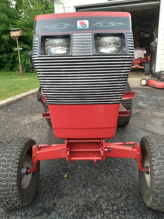

D_Mac 9,330 #30 Posted June 24, 2023 (edited) Messed with the front grill. Did some more cleaning and detailing. My custom decals should arrive today or Monday and it will be finished. Edited June 24, 2023 by D_Mac 2 1 Share this post Link to post Share on other sites
Jon Paulsen 291 #31 Posted June 24, 2023 Looking great @D_Mac 1 Share this post Link to post Share on other sites

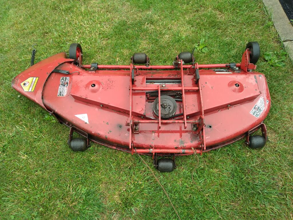

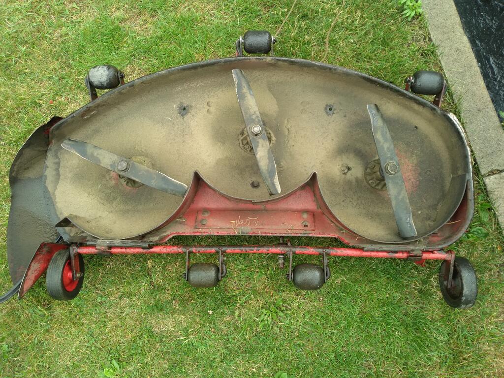

D_Mac 9,330 #32 Posted June 24, 2023 So I dragged the 48 out of the shed. Looked at it. Flipped it over. I started huffing and puffing. Sat down a minute and dragged that big S.O.B right back in the shed. At least now I can say I looked it over. Seemed pretty clean and soild. Everything spun freely. That's all I need to know for now. 3 Share this post Link to post Share on other sites
peter lena 9,498 #33 Posted June 24, 2023 @ D-MAC looking at it a couple of ways ,that deck looks like a little would get you another deck / swap , new blades, clean it up , no apparent rot , damage . find a smaller deck , in a swap . or personally would do an engine swap 12/14 hp , that would be easy and let you use that deck with no issues . think the overall conditition , showes interest , maintiance . the irony is that it was free, so you decide , we all have a different say on this . good luck with your decision . pete 1 1 Share this post Link to post Share on other sites
lynnmor 8,145 #34 Posted June 24, 2023 1 hour ago, D_Mac said: So I dragged the 48 out of the shed. Looked at it. Flipped it over. I started huffing and puffing. Sat down a minute and dragged that big S.O.B right back in the shed. Grab a 60” deck and you will think the 48” is a featherweight. 1 1 Share this post Link to post Share on other sites

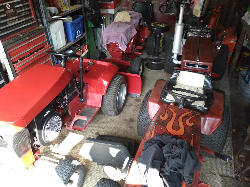

D_Mac 9,330 #35 Posted June 24, 2023 1 hour ago, peter lena said: @ D-MAC looking at it a couple of ways ,that deck looks like a little would get you another deck / swap , new blades, clean it up , no apparent rot , damage . find a smaller deck , in a swap . or personally would do an engine swap 12/14 hp , that would be easy and let you use that deck with no issues . think the overall conditition , showes interest , maintiance . the irony is that it was free, so you decide , we all have a different say on this . good luck with your decision . pete Thanks Pete. Not sure what I'm going to do with it. Love to swap it for a smaller one. I personally wouldn't have any use for any size deck. I am a city dweller and cut my lawn with a push mower in about 15 mins. If I decide to sell it a deck makes it easier to sell. I also have 3 other tractors in the garage. A 1075 an 875 and a 856. So space is an issue as well. 1 Share this post Link to post Share on other sites
Jon Paulsen 291 #36 Posted June 24, 2023 Same here @D_Mac I need to buy or build a super-shed. And I'm to look at a horse this evening... assuming I survive yard work in this heat and get approval from accounting. "I were the pants when SHE's not around!" --J. Foxworthy. Share this post Link to post Share on other sites
D_Mac 9,330 #37 Posted June 24, 2023 I also have a 10x10x10 Shelter Logic. Portable Shed in the backyard that's packed full as well. Also have 3 trailers along side of the shed. Yes I need 3 of everything. 1 Share this post Link to post Share on other sites

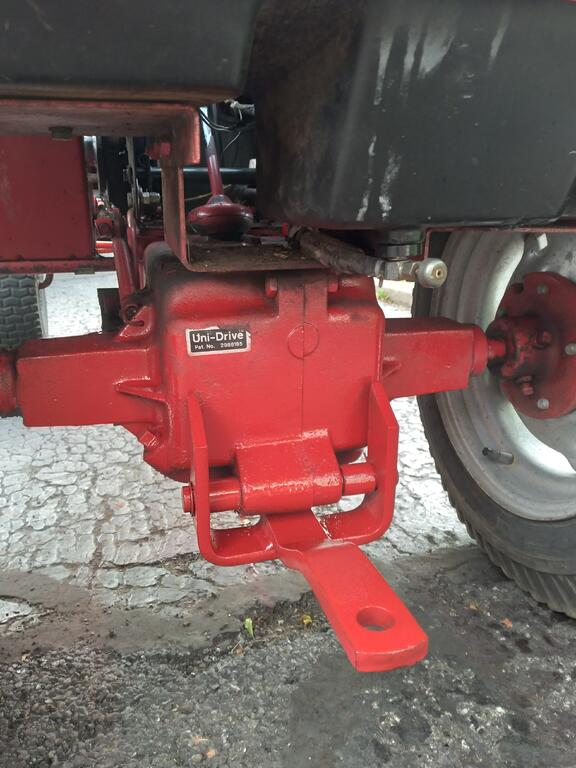

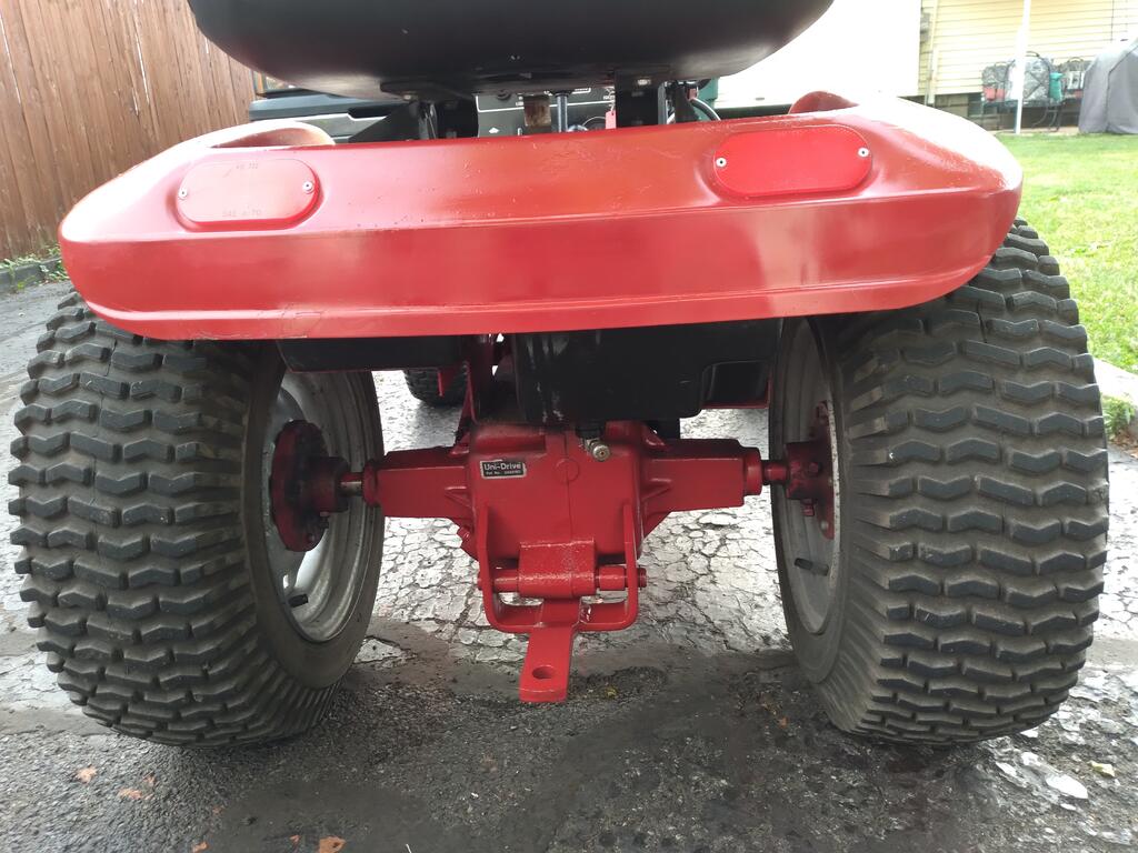

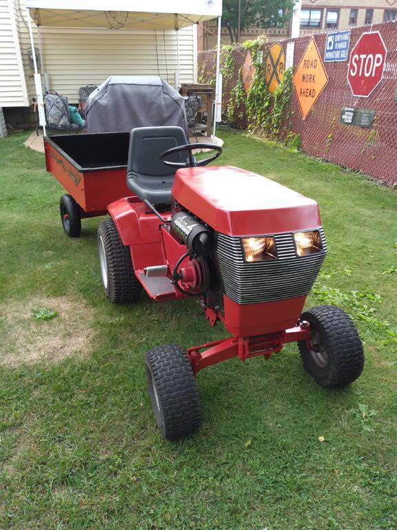

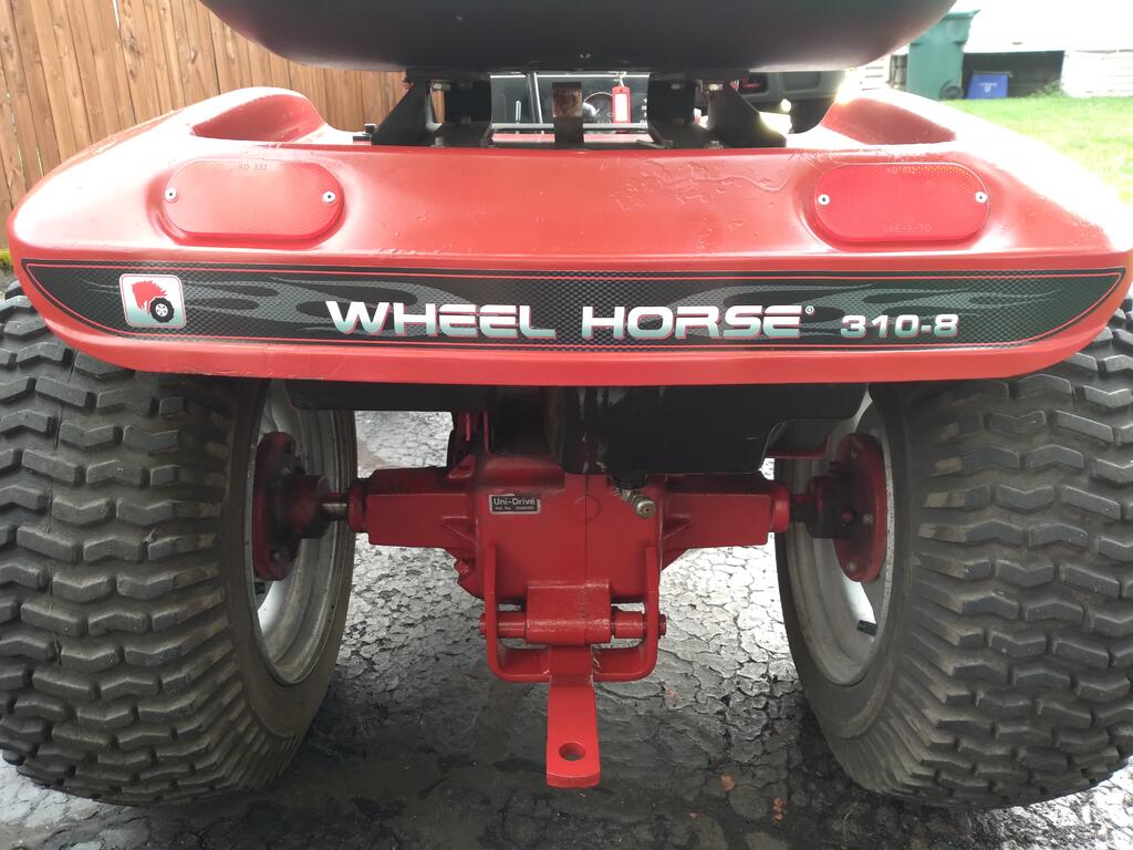

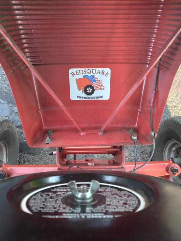

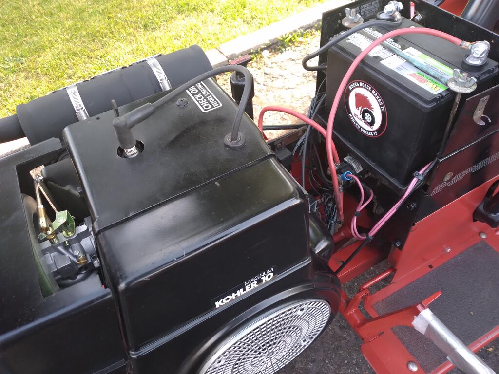

D_Mac 9,330 #38 Posted June 24, 2023 (edited) Well my custom decals didn't show up in the mail today. Most likely get them on Monday. I did apply 2 under the hood today. I also switched out the trailer hitch. The other one sank to low. Looks like it's missing a spacer. So after that I had to hook up a trailer and try it out. Edited June 25, 2023 by D_Mac 2 3 Share this post Link to post Share on other sites

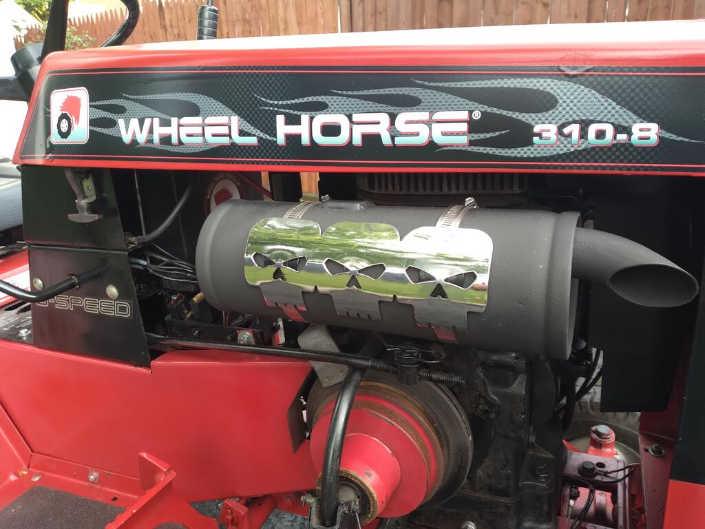

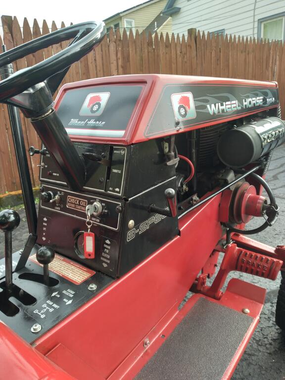

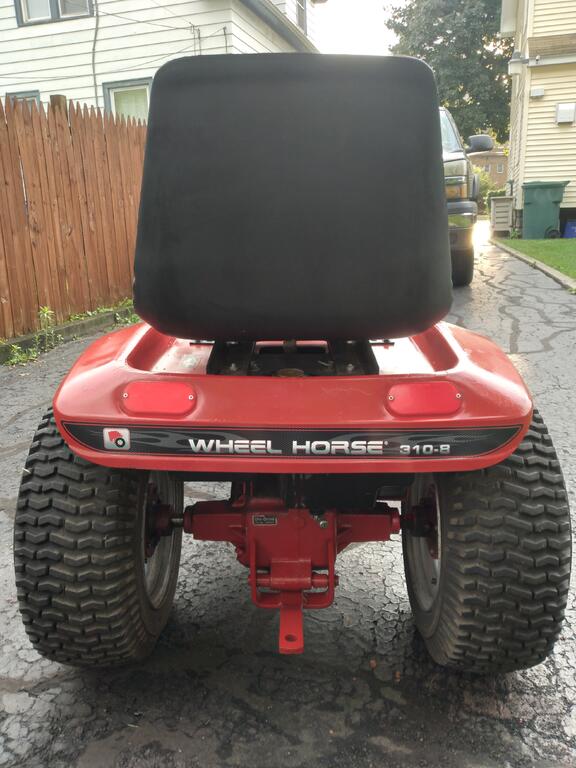

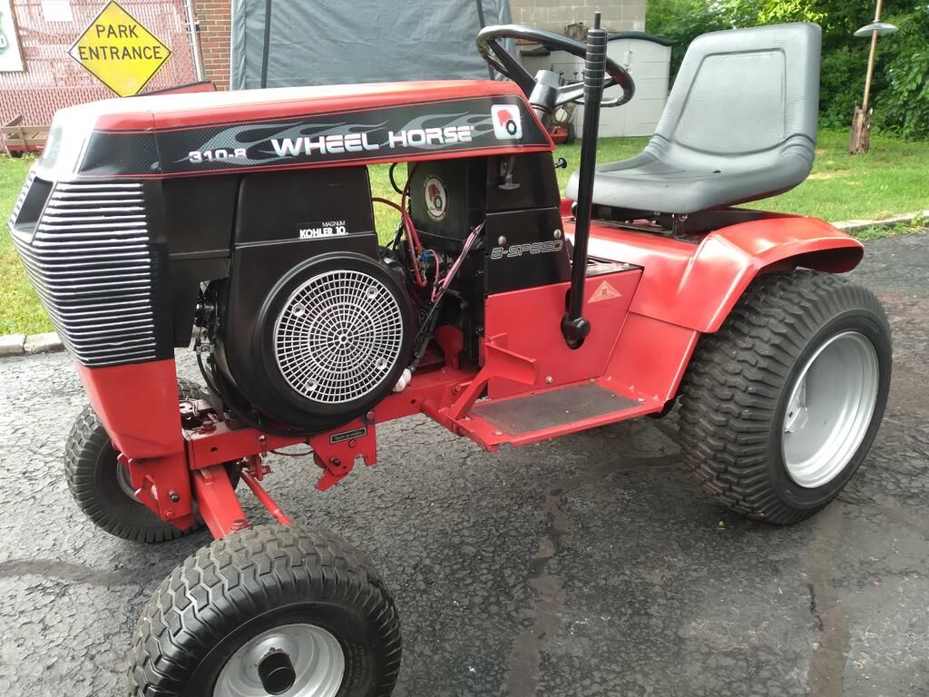

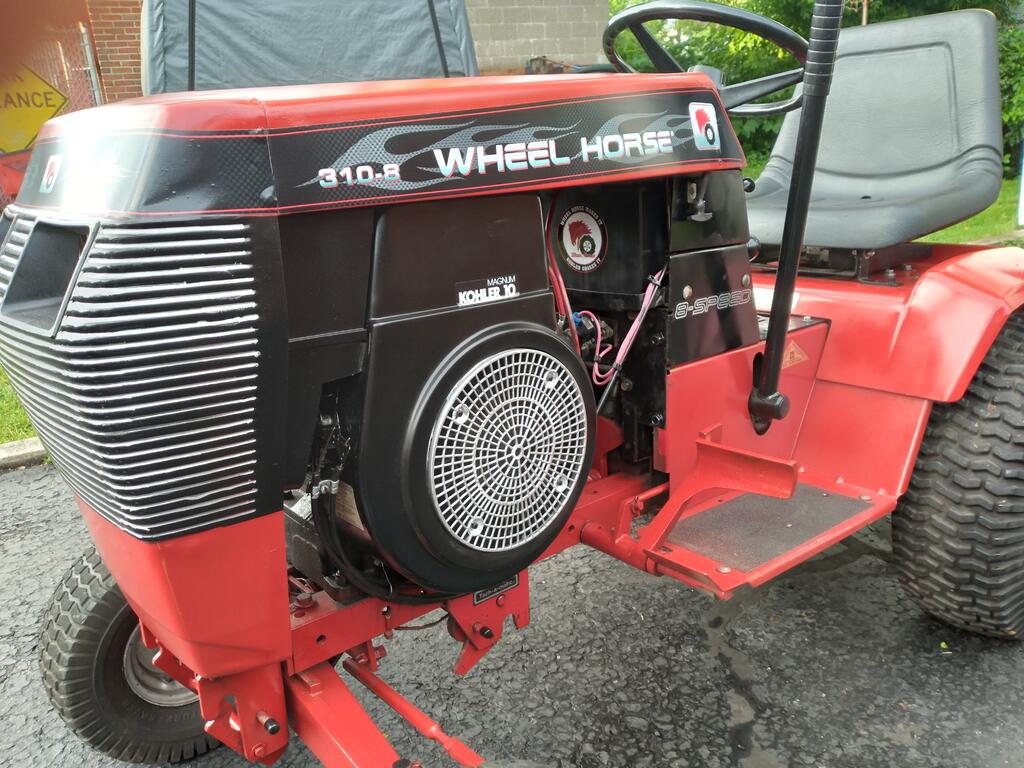

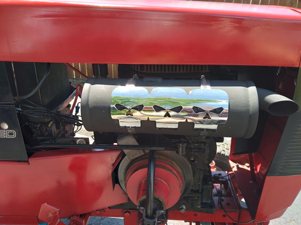

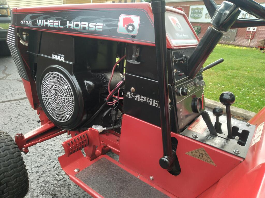

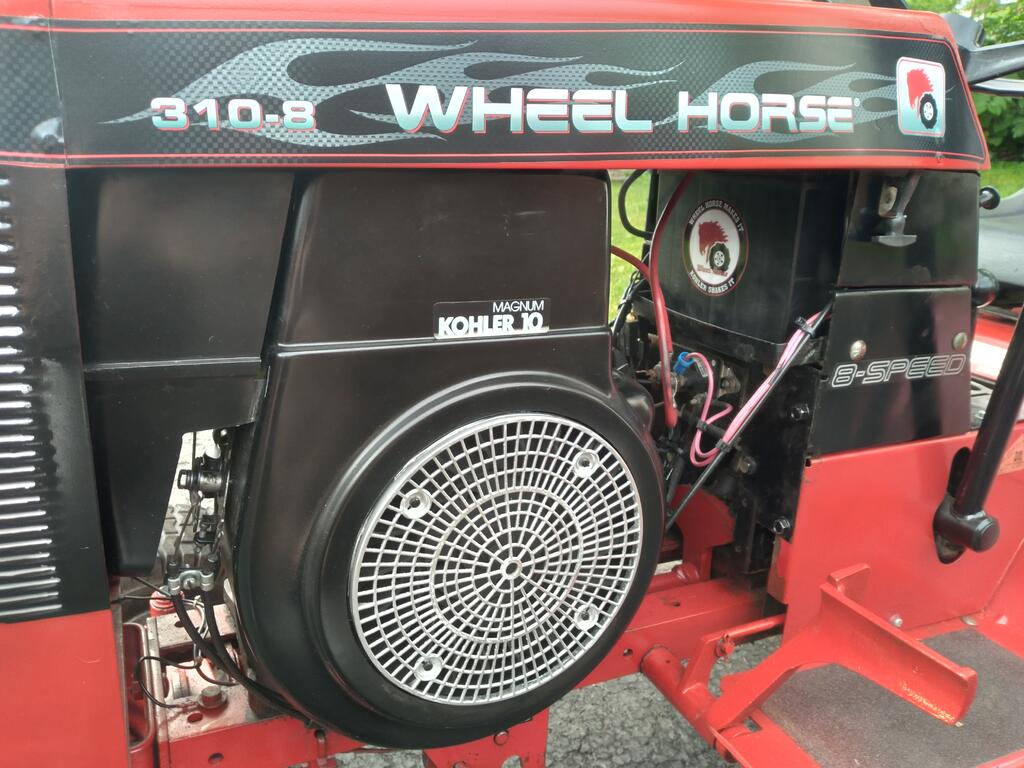

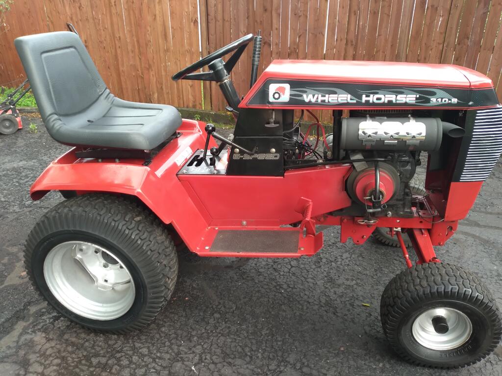

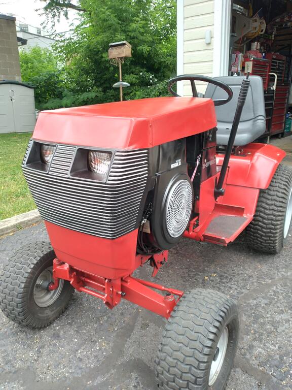

D_Mac 9,330 #39 Posted June 26, 2023 (edited) Decal Day !!! So I got my package from @Vinylguytoday. As usual he knocked it out of the park. I didn't want original decals because I'm not a fan of the burgundy background color. So I want with black with ghost flames and a carbon fiber look. I think they look great. I'm very pleased. Thanks again Terry. So it's just about done now. Still have to hook up the deck. I'm in no hurry to do that. If ever, as i wont use it. So what do you guys think ? Runs as good as it looks too. Not bad for FREE !!! Did i mention it was free? Do you guys know it was given to me for free? Might be a keeper. Edited June 27, 2023 by D_Mac 1 3 Share this post Link to post Share on other sites

Lee1977 7,419 #41 Posted June 27, 2023 On 6/20/2023 at 8:49 PM, Rick3478 said: The 6" wheels are necessary for the 37" two blade mower deck, with 8" you can't turn left. AFAIK none of the other implements care. The front spindles are also longer with the 6" wheels. Most of us just change to new gas line on a 30 some year old tractor as it's most likely never been changed. Those two 1/4" screws on the switch panel is the only ground you have for anything mounted on that panel. 1 Share this post Link to post Share on other sites

Jon Paulsen 291 #43 Posted June 27, 2023 Looking nice, @D_Mac BTW: How much did you pay for this tractor? Share this post Link to post Share on other sites
D_Mac 9,330 #44 Posted June 27, 2023 38 minutes ago, Jon Paulsen said: Looking nice, @D_Mac BTW: How much did you pay for this tractor? I might have over paid $0.00 1 Share this post Link to post Share on other sites
