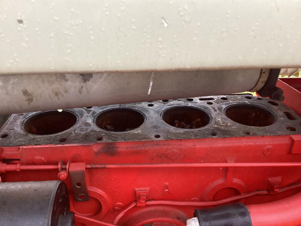

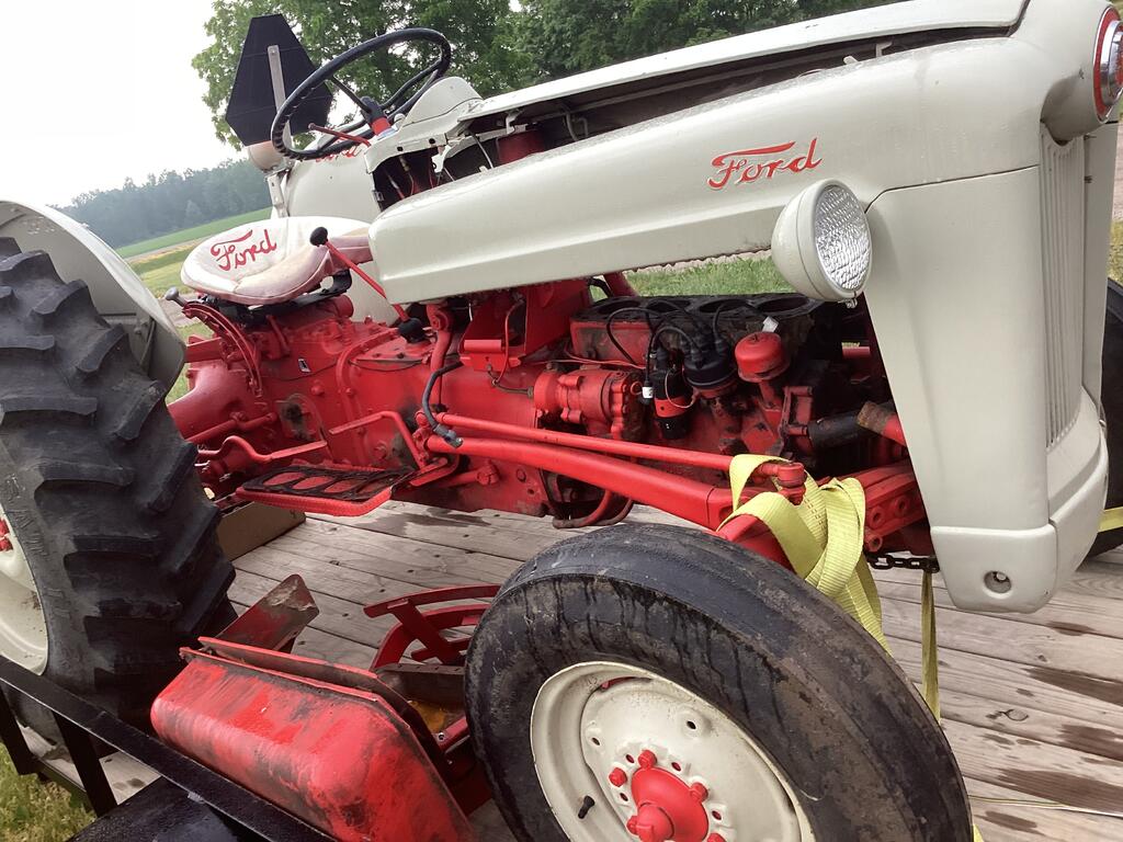

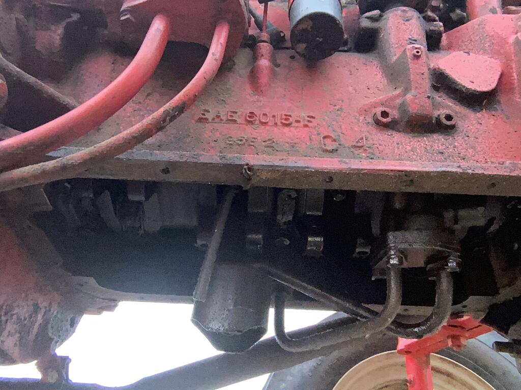

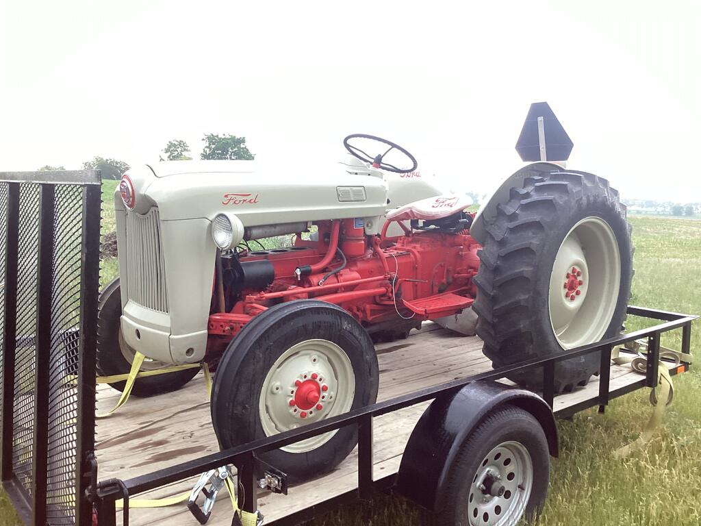

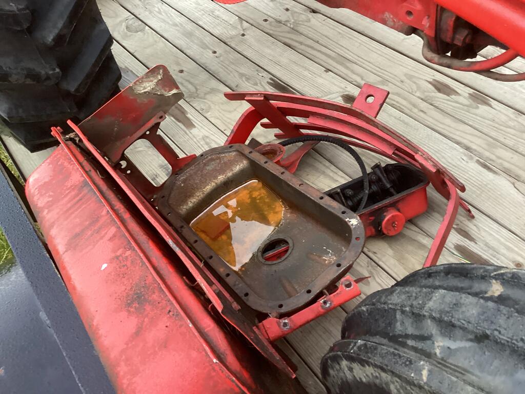

Pullstart 71,014 #1 Posted June 15, 2023 I have a buddy who owns this Jubilee. He is looking to do light farm chores with it. His “farmhand” tore it down to the short deck and decided it’s too big a job for him. I don’t know how long it’s been sitting without a head or oil pan, or if it’ll roll over. I have no idea what it really needs, and plan to pull the rod caps and pistons if possible and do some micrometer work. Considering that there won’t be any huge chores for this, and they have a newer JD loader tractor for brush hogging, would a 2N, 8N, 9N, NAA, etc… engine fit if I were to find one? The only thing I’ve found so far is that the newer “hundreds” tractors had a 172 that bolts in place of the 153. We’re not looking for a puller, just a runner and not a sitter. 6 Share this post Link to post Share on other sites

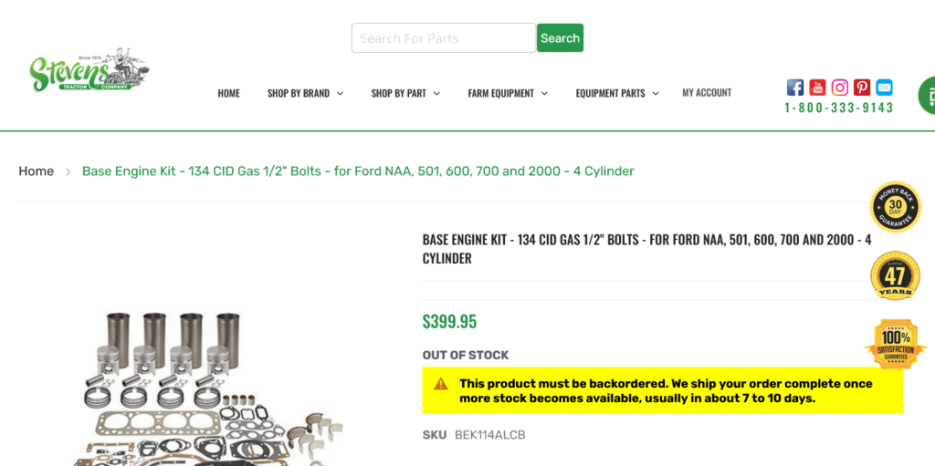

T-Mo-(Moderator) 4,912 #2 Posted June 15, 2023 The Jubilee is a NAA and has a different engine than the 9N, 2N and 8N. You will need an engine from another NAA, and it's possible an engine from a 600 or 601 series might fit, with some minor modifications. The NAAs had an overhead valve engine, more displacement and horsepower than the flat head engines in the 9N, 2N and 8N. Check my response, post #4 in this thread for further information, and parts sources: BTW, that is a nice looking tractor. 1 Share this post Link to post Share on other sites

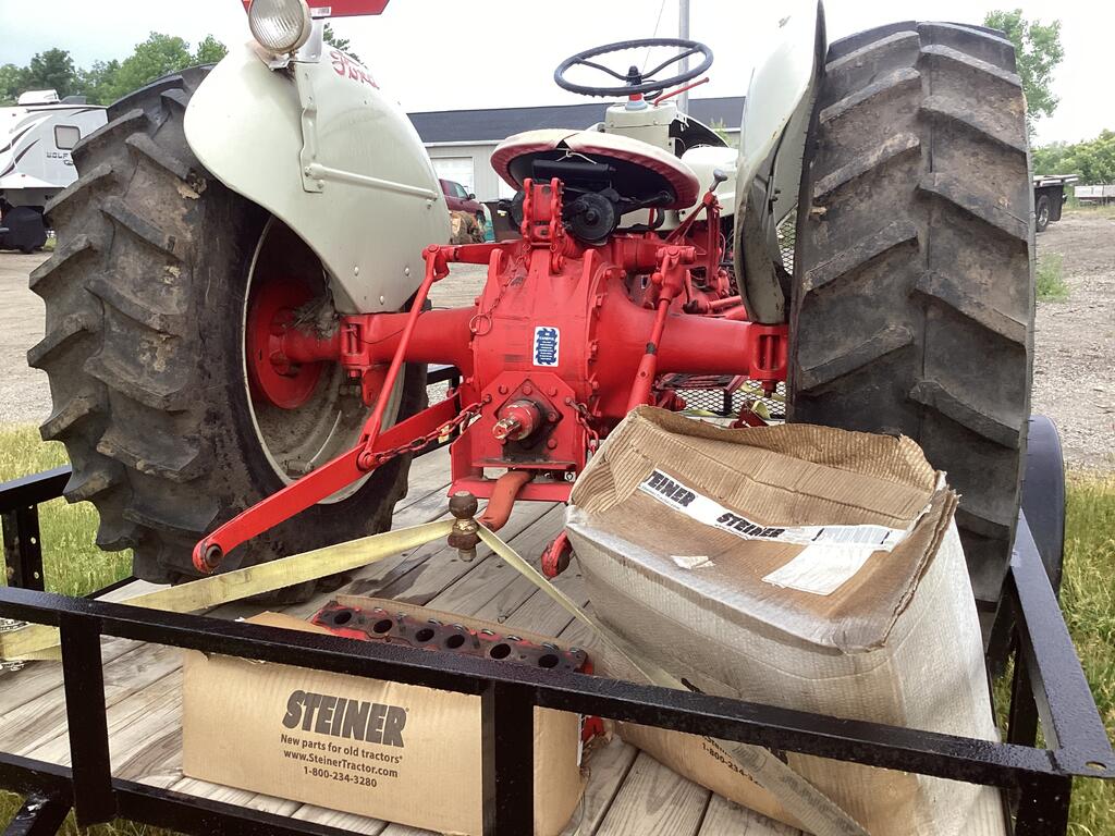

Pullstart 71,014 #3 Posted June 15, 2023 Thanks @T-Mo! I did just read that post and will note the suppliers. They have a new manifold from Steiner ready to go, I thought that’ all this machine needed! 1 Share this post Link to post Share on other sites
T-Mo-(Moderator) 4,912 #4 Posted June 15, 2023 BTW, the 172 cc engines were in the 800, 801, 900 and 901 series. The NAA, 600, 601 series had the 134 cc engines. 1 1 Share this post Link to post Share on other sites
Pullstart 71,014 #5 Posted June 15, 2023 8 minutes ago, T-Mo said: BTW, the 172 cc engines were in the 800, 801, 900 and 901 series. The NAA, 600, 601 series had the 134 cc engines. Do you know what minor mods that 600/601 engines need to fit? Share this post Link to post Share on other sites
ri702bill 12,699 #6 Posted June 15, 2023 Kevin - it is too nice to not finish it right! Always burns my butt to see rust in the cylinder walls and water in the oilpan just from improper "storage". Makes more work later... It may be time to yank it before you try to crank it.. How does the head and valves look - may need a little or a lot of work there.... 1 1 Share this post Link to post Share on other sites

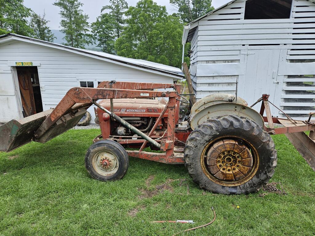

Mike'sHorseBarn 3,652 #20 Posted August 21, 2023 I'm glad I'm not the only Ford tractor nut around! I bought 2 in the last month lol! A 58 601 and a 52 8n. 2 Share this post Link to post Share on other sites
T-Mo-(Moderator) 4,912 #21 Posted August 22, 2023 Your Workmaster has the pie weights, I see. What model is your 601? 621, 641, 651, 661, etc? 601 was just the series, not the model number. The model number can be found on the flat part of the transmission housing, just behind the starter. Share this post Link to post Share on other sites
Mike'sHorseBarn 3,652 #22 Posted August 22, 2023 4 hours ago, T-Mo said: Your Workmaster has the pie weights, I see. What model is your 601? 621, 641, 651, 661, etc? 601 was just the series, not the model number. The model number can be found on the flat part of the transmission housing, just behind the starter. It's a 641. Share this post Link to post Share on other sites

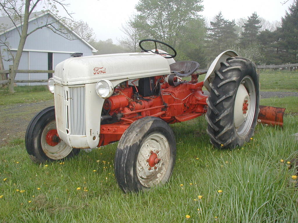

davem1111 2,314 #23 Posted August 22, 2023 I would agree that the most gratifying thing would be to restore it as original, but sometimes ya do what ya gotta do. Non-original re-powers are cool, but extra challenging with machines like these where the engine is actually the "frame" also that connects the front end. Here is the 8n that I had for many years when back in PA. Hated to let it go but needed the money at the time, after buying a JD 1070 diesel.... I see these old Fords all over and I want to rescue them all, but reality says "no". Share this post Link to post Share on other sites
