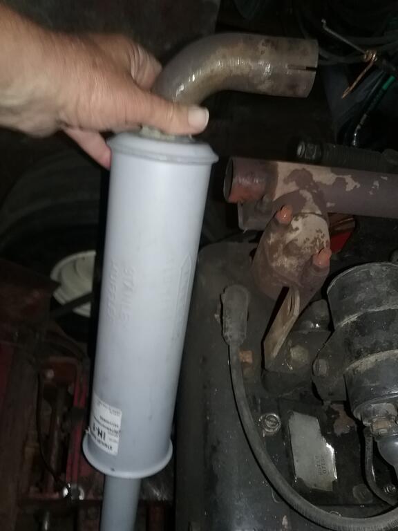

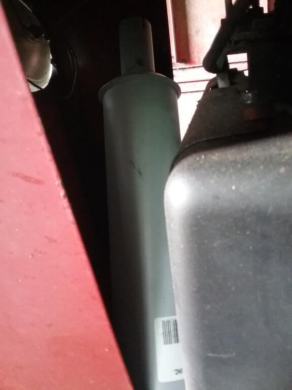

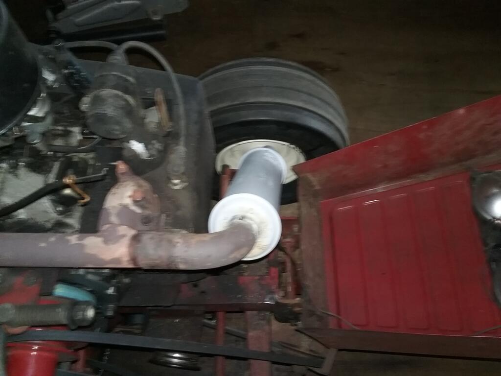

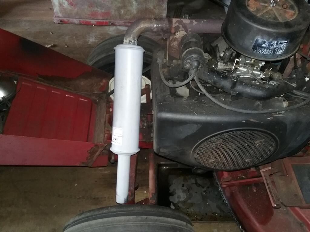

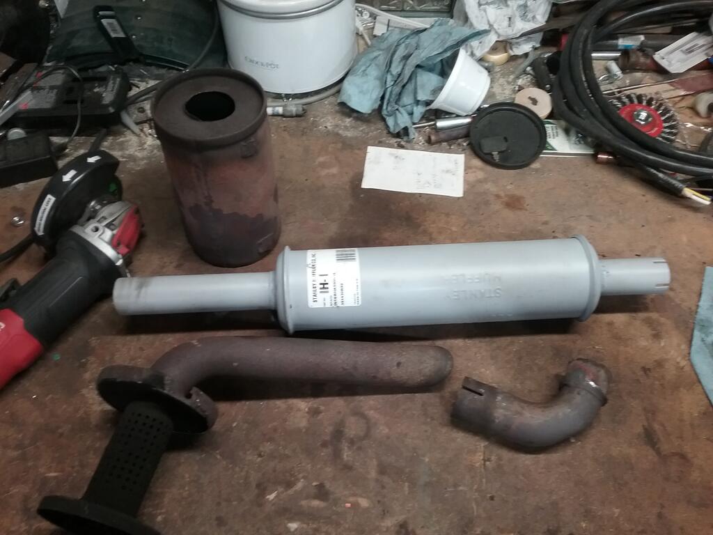

8ntruck 8,254 #1 Posted June 15, 2023 Clyde, the C-195 has a muffler that is kaput. The inlet pipe has separated from the end of the can, leaving the can and exit pipe to rattle around. Direct replacement mufflers do not exist. If they do, I have not been able to find them. So, I stopped by the TSC store the other day and bought a Stanly IH-1 muffler for $33. This is intended for an IH Cub. The pipe size is right, but the can section is too long, as you can see in the following pictures: The general plan is to try to shorten the muffler to fit in the same space as the original. Here is what I have to start with. The new muffler and the pieces parts of the original muffler: Step 1. Adapt the original inlet elbow to the new muffler (grinding sounds, sparks): Dang. Sorry. Moved the camera. Well, you get the idea. Step 2. Tack the old elbow onto the new muffler (more grinding sounds, sparks, and wire feed welding sizzle), then a trial fit on Clyde: Obvious hood interference. No way I am going to chop up the hood. How much shorter does the muffler need to be? Not enough hands to run the camera, hold the muffler and the tape measure, but the muffler needs to be about 3 1/2" shorter. At this point, my wife walks into the shed and asks what'cha doing? So I explain the plan. She gives me a quizzical look, then says 'why don't you hang it outside of the hood? I think it would look funny (amusing is what she meant).' So I close the hood and place the muffler in the classic stack position. She says 'Yup. Like that.' I explain that I don't really want a stack. I get the 'are you crazy?' look, and she walks off. Well, I get to thinking that making a stack would be a whole bunch less work than sectioning 3 1/2" out of the muffler. So, I says to myself 'self, why not give a stack a try? I can always hacky chop to fit it under the hood later'. Tomorrow, I'm going to visit the local muffler shop or NAPA store and pick up a couple of clamps and a 1 1/2" elbow. Stay tuned. 9 Share this post Link to post Share on other sites

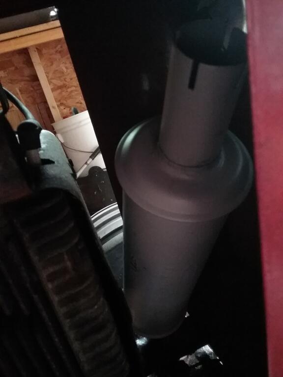

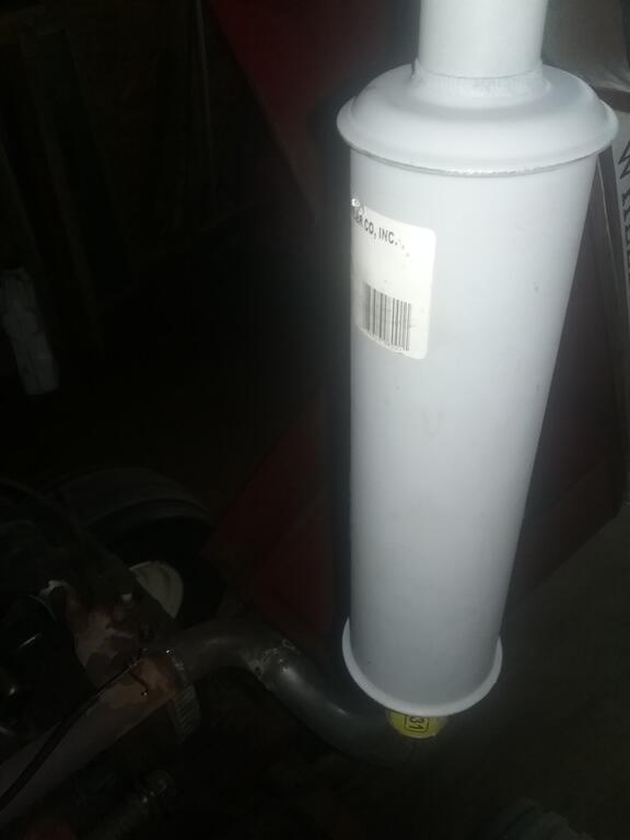

8ntruck 8,254 #6 Posted June 15, 2023 Picked up a 1 1/2" 90 elbow from NAPA this afternoon. One end flared, the other not. The flared end fit on the exhaust manifold, the flared end of the old muffler tacked to the new muffler fit the plain end of the new elbow. Great! This is going to be a price of cake. Mocked the pieces up on Clyde. Looked good with the hood open. The new elbow held the hood open by about 4" at the dash tower when I tried to close the hood.. OK, untack the old short elbow from the muffler, put it on the manifold, then the new elbow out from under the hood to the muffler. An improvement, but still held the hood open. So much for the piece of cake. The short elbow needed to be shortened another 1 1/4". That removed about 90% of the flared end. The closest muffler shop with an expander is about 10 miles away. When I called, the guy didn't know if it would work on 1 1/2" tubing. Guess I'll find out tomorrow. I'm not really sure that their expander will work on my piece, so I need to come up with a plan C. Harbor Freight maybe? Nearest one is about 25 miles away. Share this post Link to post Share on other sites
ebinmaine 74,971 #7 Posted June 16, 2023 10 hours ago, 8ntruck said: plan C Online? Plumbing supply? Hardware stores? Good old school auto parts place? Share this post Link to post Share on other sites
8ntruck 8,254 #8 Posted June 16, 2023 Plan C - muffler shop 10 miles away. Plan D - 1 1/2" to something else adapter pipe from auto parts store, then hack and weld some more. Plan E - a box fill of header blends from Summet Racing. Future project preparation - pick up a set of cheap headers at the next swap meet I go to. 2 Share this post Link to post Share on other sites

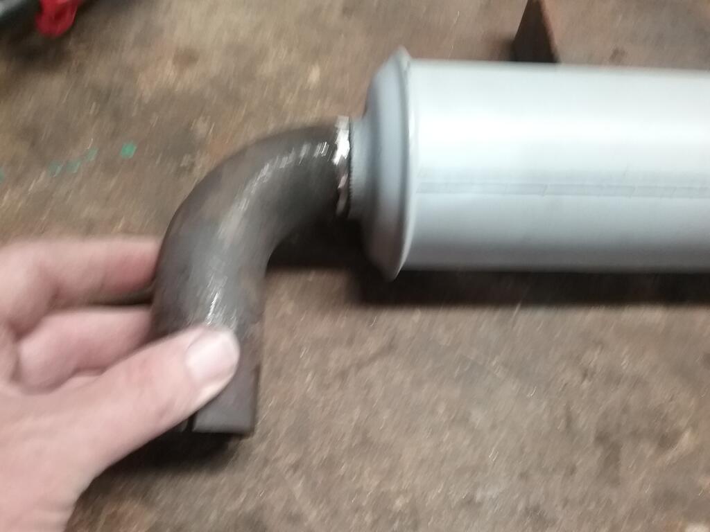

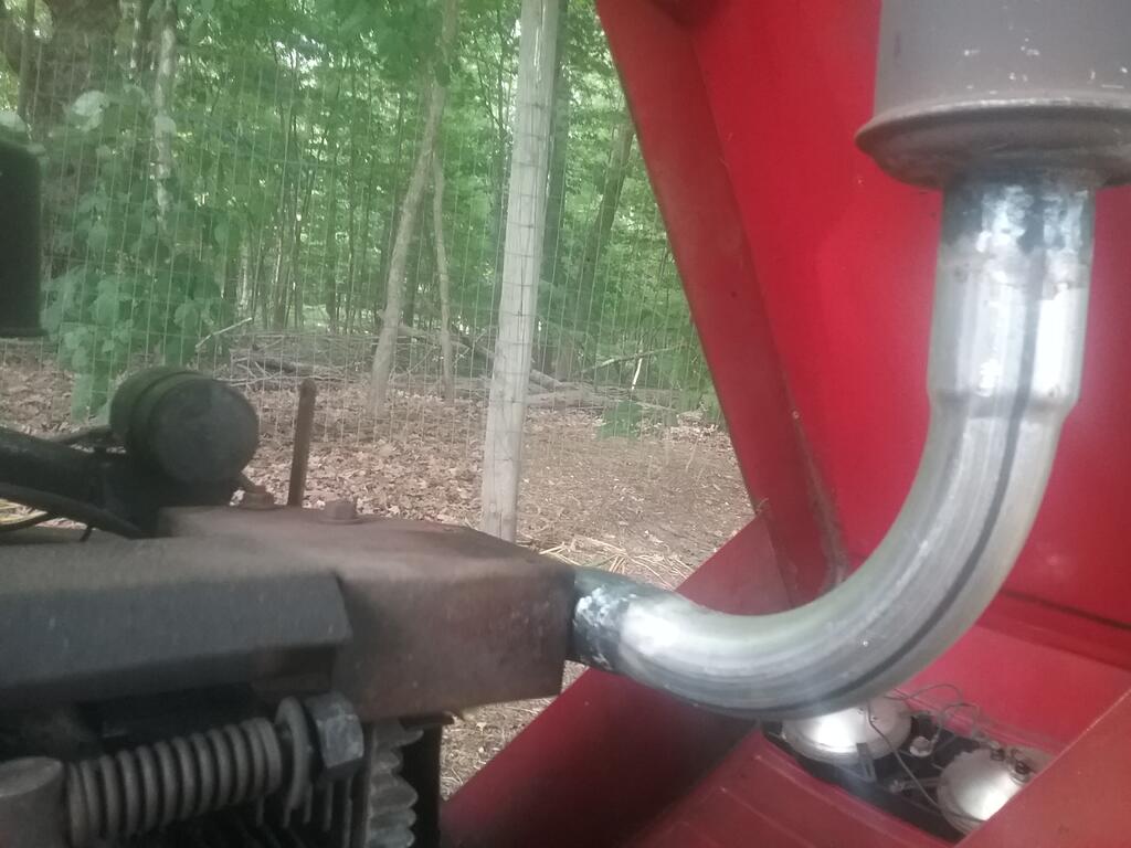

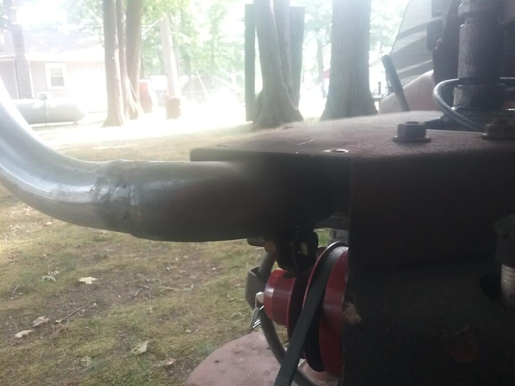

8ntruck 8,254 #11 Posted June 17, 2023 (edited) I forgot about @Pullstart tubing bender. Kevin, do you by any chance have a tube expander as well? Got to the muffler shop today. In and out in less than 5 minutes. No charge. got home and tacked everything together: Was around dusk when I took that second picture. I'll edit a better one in tomorrow. Anyhow, I managed to get 'welds' around both joints that are plenty ugly and need lots of finishing. Blew as many holes through the tubing as I did welds. I did seem to get better as I dialed the voltage and wire feed speed down. Need to work out the manifold clamp details tomorrow, then take Clyde out for a test run. I have not yet gotten a handle on welding lighter gage stock. I'll have to get some 1/16" thick stock and mess around with the welder to find a happy setting for the lighter stock. Edited June 17, 2023 by 8ntruck 3 Share this post Link to post Share on other sites
ebinmaine 74,971 #12 Posted June 17, 2023 Is there a need or plan to run a brace for the muffler? Thinner metals can definitely be a challenge to weld. That's the reason I decided to get a light duty HF Flux Core wire feed welder. I'm hoping to have that set up in a workable space today, along with a few other metal tools. 1 Share this post Link to post Share on other sites

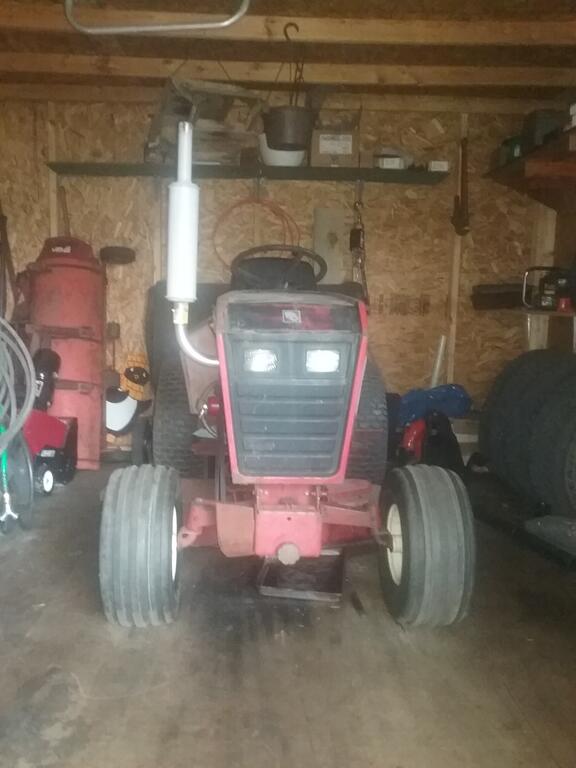

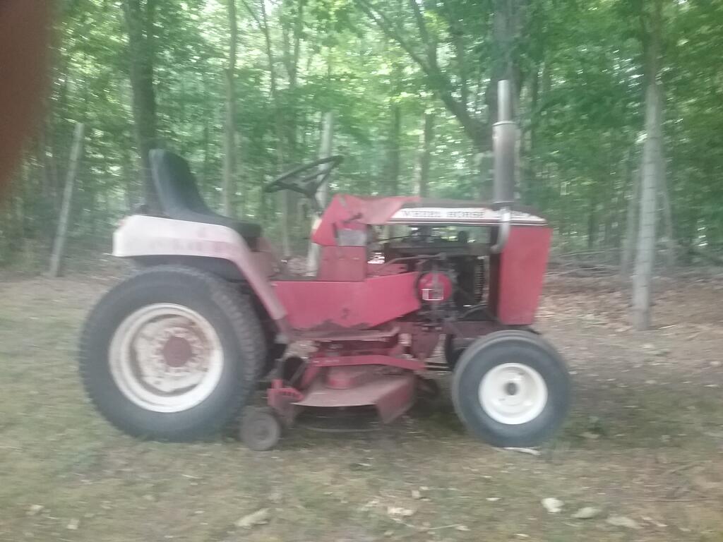

8ntruck 8,254 #16 Posted June 19, 2023 @ebinmaine Is there a brace in the plans? Maybe. That is what the seat time yesterday and today is going to help determine. The stack is being held on by the same clamp used on the original muffler. After today's 20 minutes of use or so, I am able to grab the end of the stack and rotate it slightly on the manifold. Will have to try tightening the clamp a bit more. If this does not work, a brace of some sort will be in order. As mentioned in my previous post, here are some better pictures: 2 Share this post Link to post Share on other sites
Handy Don 14,885 #17 Posted June 19, 2023 It looks good. I’d love to hear what the sound level is. My 2¢? Don’t take any chances--put a brace on it. At that height, it has a lot of leverage to force movement at the clamp and if that breaks, well...it won’t be good. 2 Share this post Link to post Share on other sites
8ntruck 8,254 #18 Posted June 19, 2023 (edited) I'd describe the sound as deep and mellow. No sharp high frequency impulses. For the sake of being bullet proof, a brace shoud be a good addition. Got to figure out a good place. Will probably need to weld a tab on the bottom of the elbow for an attachment point. Edited June 19, 2023 by 8ntruck 3 Share this post Link to post Share on other sites
