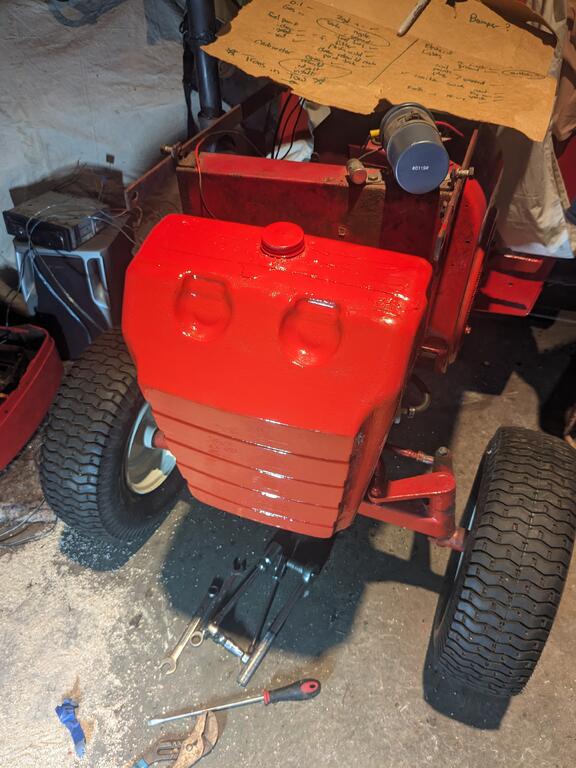

Treepep 1,061 #9 Posted June 29, 2023 Well... I have the front end apart. I was looking at my records and it is coming up on 3 years since performed the "park for a while service" and put it on a trickle charger to sit. There are multiple problems...as anticipated. I love this rig and want it running but I have other workers that need to be on point. Fuel and air intake leaks everywhere. Not enough to drip on the fuel side however enough to stall the healthy flow. Fuel pump is cleaned and in excellent working order. All lines and fuel filter are replaced. Tank nipple was cracked halfway through. Not leaking, sucking air for certain. I have elbows and grommets coming. I have trepidation about drilling the tank. If I am unsuccessful there is a gentleman here that can make one. I just do not want to afford that right now. Carburetor was not getting sufficient fuel and was chock full of crud. Cleaned and waiting for a rebuild kit. Points and plug are gapped. Seem to be in working order. More to come.... I hope Thanks guys I appreciate it, Sorry about the "dear diary". I said I would report and hadn't yet Share this post Link to post Share on other sites

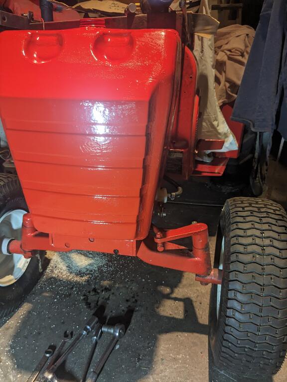

Treepep 1,061 #10 Posted July 1, 2023 Tank is plastic welded and painted. I cut the broken nipple off and ground that smooth. Just waiting for parts... 3 Share this post Link to post Share on other sites
