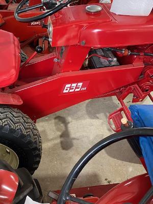

Pogo 57 10 #1 Posted June 9, 2023 Would really like to pin point what model I have. Engine says it is a K161S, 28626E, which makes it a 1963 753. The tractor S/N is 87029 and I can't find what that refers to as of year. It has a 633 Sticker on it, which could be from a doner tractor. Thanks in advance. Share this post Link to post Share on other sites
ri702bill 13,399 #2 Posted June 9, 2023 POGO - we really like - and need pictures - both sides, the dash, and the hood on & off to get a better feel for just which Round Hood model you have. A LOT can happen over 60 years - parts get damaged, worn out, or lost and replaced with a suitable replacement that is not original - aka a "FrankenHorse".... Bill 1 Share this post Link to post Share on other sites

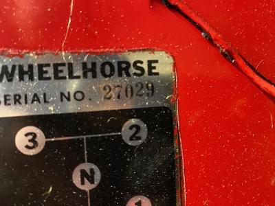

J854D 145 #3 Posted June 9, 2023 @Pogo 57, I’m wondering if the first digit in the serial number that you posted could be a 3. If so, serial number 37029 falls in line with those listed for a 753 in the Red Square manuals section. Your engine numbers match up with a 753 also. The numbers 3 & 8 could easily look similar on an old & weathered serial number tag. -JD- 1 Share this post Link to post Share on other sites

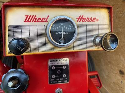

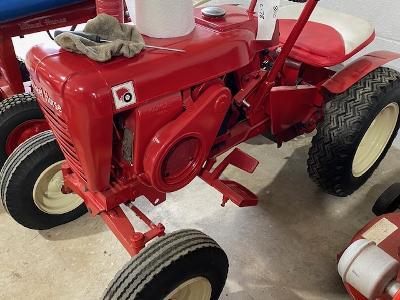

Pogo 57 10 #8 Posted June 9, 2023 (edited) Here are few pictures. Th S/N is 27029. I took another look at it. Hop This helps. Edited June 9, 2023 by Pogo 57 1 Share this post Link to post Share on other sites
J854D 145 #9 Posted June 10, 2023 (edited) With the K161 Kohler engine, a starter/generator and the tractor equipped with an ammeter, makes me say you have a 753. The serial number is consistent with those listed in the manual section for both the 633 and 753 however. -JD- Edited June 10, 2023 by J854D Share this post Link to post Share on other sites
