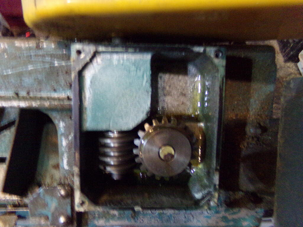

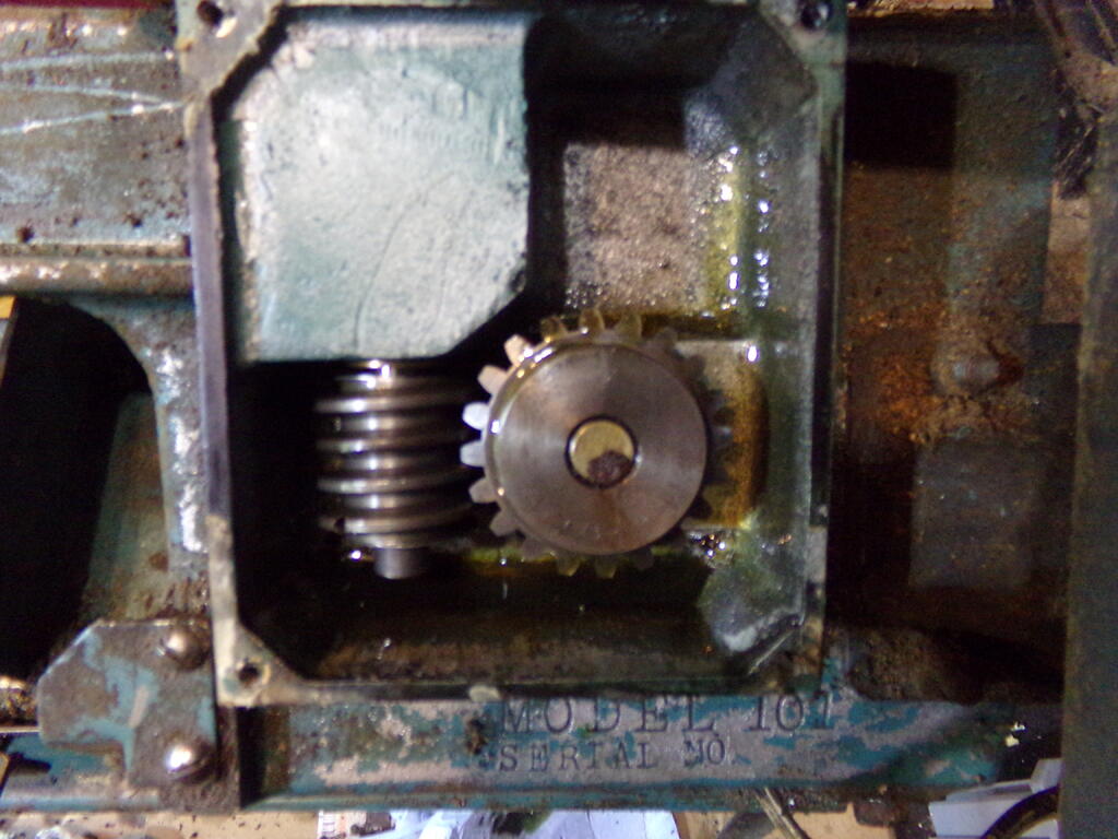

elcamino/wheelhorse 9,363 #6 Posted June 6, 2023 Took the cover off the gear box and it has steel gears and oil in it. The oil is heavier than 90wt . Used the tried and true method . Put some oil on your finger and see how long it takes to drip off . The stuff in the gear box is thick . Suggestion on what weigh oil.Took 2 pictures ,I cleaned most of the oil out so pictures would come out. need a suggestion on how much oil to put in it. The gear box is tilted , so do I tilt the whole saw so the gear box is level front to back and side to side and fill to cover both gears? I never will finish the Waldomobile. Share this post Link to post Share on other sites
squonk 47,785 #7 Posted June 6, 2023 (edited) Not knowing what was in it and being heavier than 90 wt. I'd opt for 00 grease (which is liquid) like Ariens uses in it's snowblowers. You can't spoil a rotten egg! Edited June 6, 2023 by squonk Share this post Link to post Share on other sites
elcamino/wheelhorse 9,363 #8 Posted June 6, 2023 @squonk Okay , should I cover the gears to the tippy top? Where can I get the oo grease? Share this post Link to post Share on other sites
squonk 47,785 #9 Posted June 6, 2023 (edited) 19 minutes ago, elcamino/wheelhorse said: @squonk Okay , should I cover the gears to the tippy top? Where can I get the oo grease? How much was in there when you took off the cover?. I'd say at least half way. Google 00 grease Tractor Supply carries it if there is one near you. Edited June 6, 2023 by squonk Share this post Link to post Share on other sites
elcamino/wheelhorse 9,363 #10 Posted June 6, 2023 It was very very low. Should I tilt the saw so the gear box is near level and fill the entire box is about 1/2 full. Share this post Link to post Share on other sites
