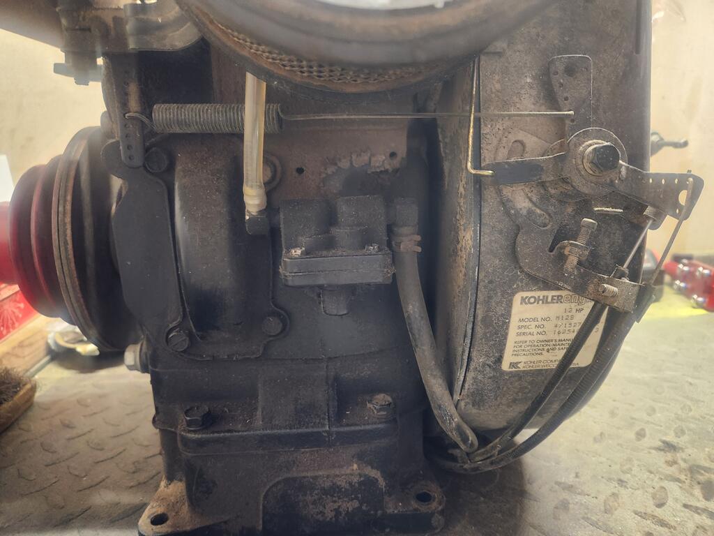

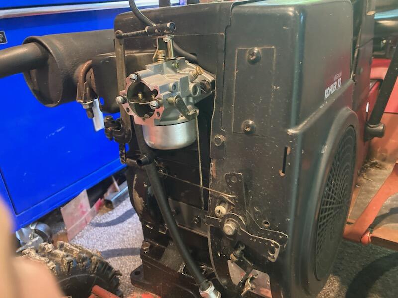

D_Mac 9,333 #1 Posted June 2, 2023 Can anyone send me a few photos of the choke and throttle linkage off the carb? Was taken apart and can't figure it out. 1 Share this post Link to post Share on other sites

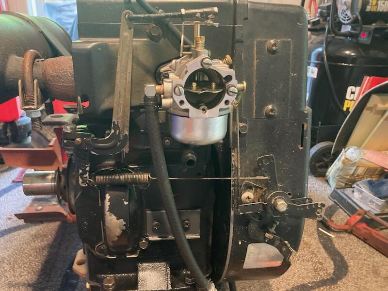

ineedanother 1,871 #2 Posted June 2, 2023 (edited) @D_Mac The cables aren't attached but the linkages are still where they need to be. Edited June 2, 2023 by ineedanother 2 Share this post Link to post Share on other sites

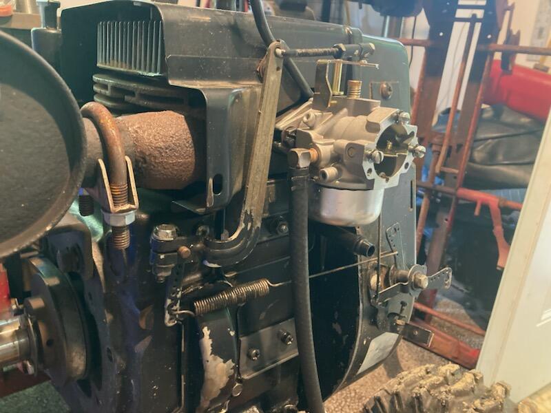

JoeM 9,619 #3 Posted June 2, 2023 cables attached. 2 2 Share this post Link to post Share on other sites
D_Mac 9,333 #4 Posted June 2, 2023 Think I got it figured out. Thanks for the help !! 1 Share this post Link to post Share on other sites

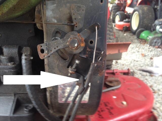

wallfish 19,287 #10 Posted August 21, 2024 8 hours ago, Jim Sheaffer said: Does anyone have an adjustment procedure for this or a Youtube link to one? I noticed today the engine RPMs on my '86 310-8 seemed low. I checked it with a tach and found it was only 3100 RPM. The long spring on mine also seems to be way too long, so I'm assuming something slipped and is not pulling on the gov. arm properly. Many thinks. With throttle lever on full and engine running, loosen the throttle cable clamp. Pull/slide the cable back out of the clamp until the RPMs are achieved and then tighten the clamp. Adjustments can also be made by changing the connection holes for the linkage. 1 Share this post Link to post Share on other sites

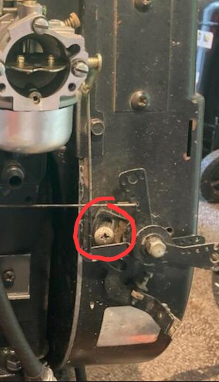

Goldnboy 1,081 #11 Posted August 21, 2024 What adjustment is the slot used for ? Share this post Link to post Share on other sites
Goldnboy 1,081 #12 Posted August 21, 2024 Would this way be considered backwards? Share this post Link to post Share on other sites

peter lena 9,764 #14 Posted August 21, 2024 @dmac note very light extension springs , on choke / throttle assist , also perforated go to spring pull point , very easy to add to any related screw point , also any movement point is PENETRATING OIL LUBRICATED , like 3-1 penetrating oil , verify its enhancement , that spring on throttle plate , first photo , is critical for fast starts , almost delicate in its function , yet makes a big improvement in starts .LOOK AT A FAILURE AS AN OPPORTUNITY , TO INCREMENTIALLY ELIMINATE IT , not a one and done , start / stop , easier / same ? make a change , all my cables , linkage points , slide with total ease . pete Share this post Link to post Share on other sites

Rick3478 445 #17 Posted August 22, 2024 On 8/21/2024 at 8:32 AM, Goldnboy said: Would this way be considered backwards? Choke rod is upside down. The right angle offset lets it tuck in behind the air filter without hitting. Share this post Link to post Share on other sites
peter lena 9,764 #18 Posted August 23, 2024 @Rick3478 might get some , super lube on those movement areas , also noting the holes in the cable mount pull point ? added light extension springs from there to rectifier mount screws , perforated mounting point , lets the springs always assist to close cable movement , very simple add on to cable movement ease . also like 3/1 penetrating oil inside cable movement . lubrication and spring assisted movement , have that on my 3 kohler engines , just an idea, pete Share this post Link to post Share on other sites
