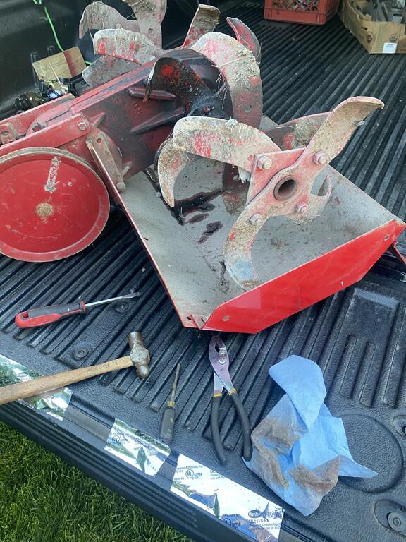

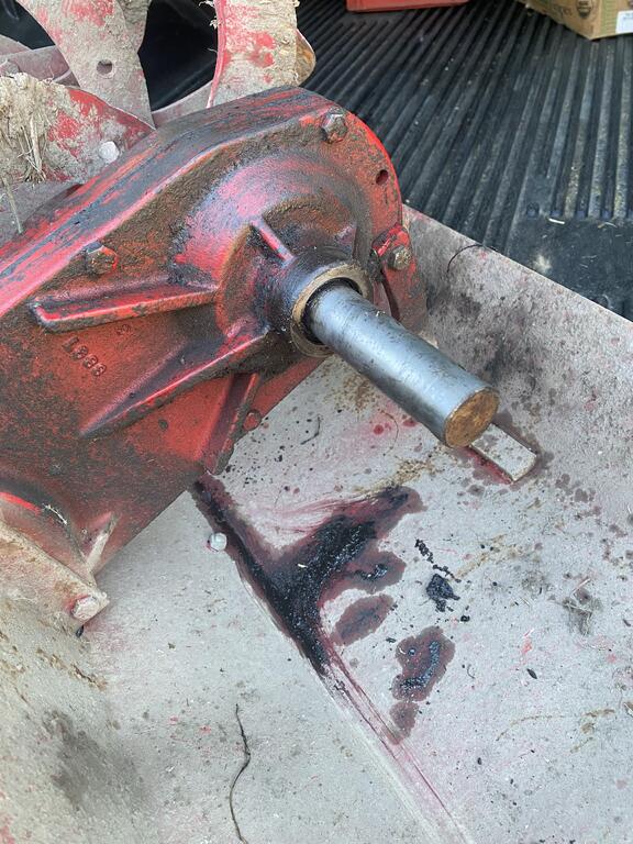

Lane Ranger 12,133 #1 Posted June 1, 2023 I am replacing two oil seals on this 36 inch Wheel Horse tiller. Been a while since I worked on one of these. What type gear oil goes in the tiller? Share this post Link to post Share on other sites

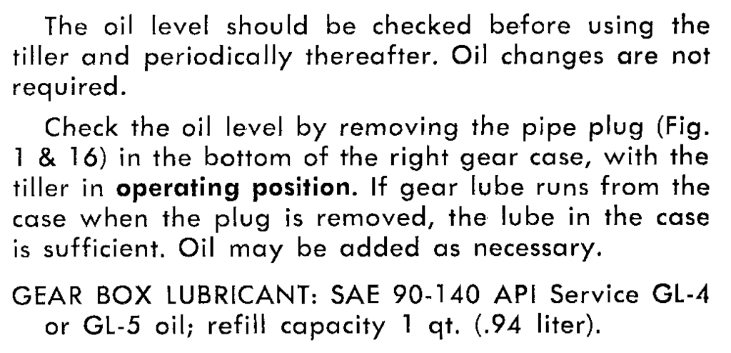

lynnmor 9,050 #3 Posted June 1, 2023 From the manual: 1 1 Share this post Link to post Share on other sites

rick 319 #5 Posted June 1, 2023 They leak badly sometimes because the grease leaking from the seal combines with the dust from tilling and grinds a groove in the tine shaft. Once the tiller shaft seals start seeping, get right on the repair or you will be buying a shaft along with the seals. Outside seal goes in backwards, to keep the dirt out. 2 Share this post Link to post Share on other sites
mrc 1,119 #6 Posted June 2, 2023 i'm with squonk and lynnmor on this one. i think the heavy 00 semi-grease with a little 90-140 gear oil should work nicely. always amazed me that folks would till a garden with a very leaky tiller. they are going to eat from the garden right? hmmm Share this post Link to post Share on other sites

lynnmor 9,050 #14 Posted April 17, 2024 58 minutes ago, mike avad said: Where can you get that 90-140 at haven't seen any? Any auto parts store, TSC and other farm supply places have 85-140 that is close enough. Share this post Link to post Share on other sites
