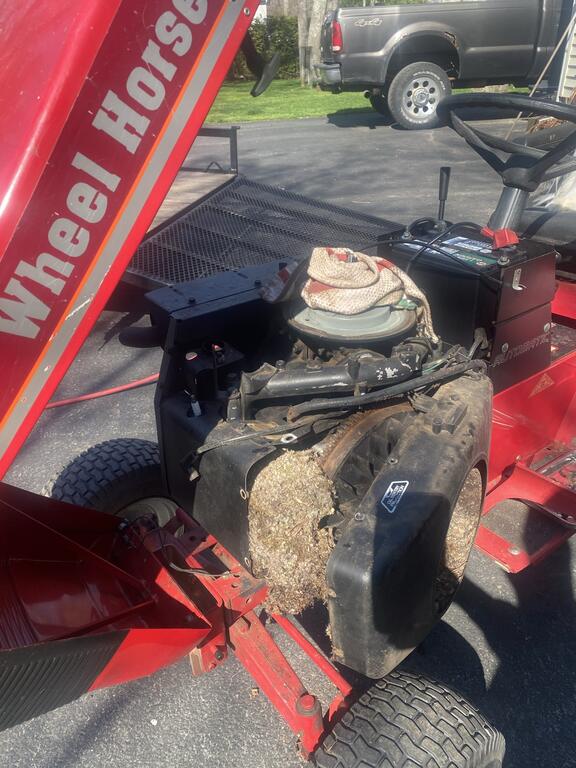

c-series don 12,656 #6 Posted May 22, 2023 I have an 18HP Kohler that I thought might be seized. I was getting ready to do the whole Marvel Mystery Oil thing and then my son in law took the tins off and found this mouse nest. It was so packed that the flywheel wouldn’t even budge. After a thorough cleaning we got it spinning over and running perfectly. The tractor had been sitting for a few years and the acid in the mouse urine actually ate into the block. Not enough to do any damage but enough to pit it. 1 12 Share this post Link to post Share on other sites
