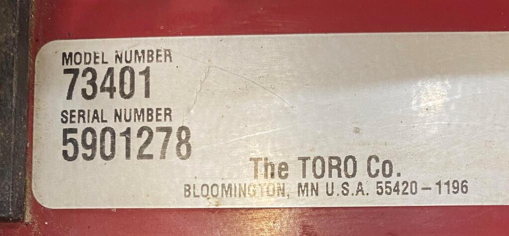

Charlie Drannbauer 0 #1 Posted May 20, 2023 (edited) I've got a 314 Hydro that goes forward seemingly fine, but reverse is very sluggish. The guy I bought it from indicated that there is a "slide valve" that probably has worn or defective "O" rings allowing leakage" when shifting into reverse. Is there bar kit that contains the necessary parts to repair this issue? Also whatever instructions that may be available. All the other Horses I've had were 8 speed models, so this Hydro is new to me, any help would be appreciated. Thanks, Charlie Edited May 20, 2023 by Charlie Drannbauer Add Picture Share this post Link to post Share on other sites
