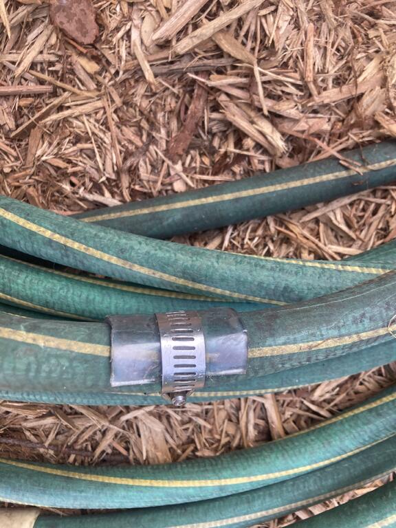

hotajax 284 #1 Posted May 15, 2023 Small hole in the middle of the hose. Bot some tape from Super Glue that was supposed to fix it. Didn't do squat. I want something smooth and flexible. Any suggestions? Flex Seal? What do you guys like? I don't want that clunky coupling Thanks in advance 1 Share this post Link to post Share on other sites

SylvanLakeWH 32,594 #3 Posted May 15, 2023 I have several hoses with bicycle inner tube wrapped with a hose clamp. Also have used clear tube from my kids old fish tank. Several years no leaks... 1 Share this post Link to post Share on other sites

ZXT 2,402 #5 Posted May 16, 2023 Nothing will be "smooth" that will hold for any length of time. They make splice kits that are basically a double barb that you fasten with hose clamps, but definitely not smooth. Go to Harbor Freight. They have pretty good deals on new hoses. 1 Share this post Link to post Share on other sites

peter lena 10,075 #7 Posted May 16, 2023 @hotajax have a TRUE VALUE OR ACE HARDWARE near you , ? , hose area , there is a male / male , to female hose coupling , that has a screw down cover cap , thats simple / easy to install, have mine on years now , no problems at all , worth a look , pete 2 Share this post Link to post Share on other sites
CasualObserver 3,416 #8 Posted May 16, 2023 You could try to clean it good with like acetone or thinner, coat it in bead sealer and wrap it in duct tape. If you don't want a hose repair coupler, your only options are short term at best, any flexible repair will fail because it doesn't reinforce original tubing. The hole will eventually flex and continue to tear into a larger hole. 2 Share this post Link to post Share on other sites

hotajax 284 #10 Posted May 16, 2023 4 hours ago, CasualObserver said: You could try to clean it good with like acetone or thinner, coat it in bead sealer and wrap it in duct tape. If you don't want a hose repair coupler, your only options are short term at best, any flexible repair will fail because it doesn't reinforce original tubing. The hole will eventually flex and continue to tear into a larger hole. I was afraid that would happen. I got this black goo from 3M, it is very tacky, waterproof, and flexible. Its purpose is to glue a windshield to the car. Very strong stuff. I'll give that a whack. A standard size caulk tube of this goo is $25 so it better work. 1 Share this post Link to post Share on other sites
peter lena 10,075 #11 Posted May 16, 2023 @hotajax just there , its called a HOSE MENDER KIT , comes in various sizes , all plastic or all metal .used mine for a longer hose reach on lawn , the metal one , bombproof . pete 1 Share this post Link to post Share on other sites

peter lena 10,075 #14 Posted May 16, 2023 @hotajaxhttps://www.bing.com/images/search?q=Gilmour+Hose+Mender&form=IRIBIP&first=1 the all metal version is the deal . hope you find what you want , get hosed , pete 1 Share this post Link to post Share on other sites
