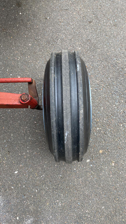

Sparky-(Admin) 26,326 #4 Posted May 14, 2023 For improved steering with the loader on your 16 Auto try a set of tri-ribs up front. I also agree with Eric that the Carlisle Tru-Powers are great rear tires. 3 1 1 Share this post Link to post Share on other sites

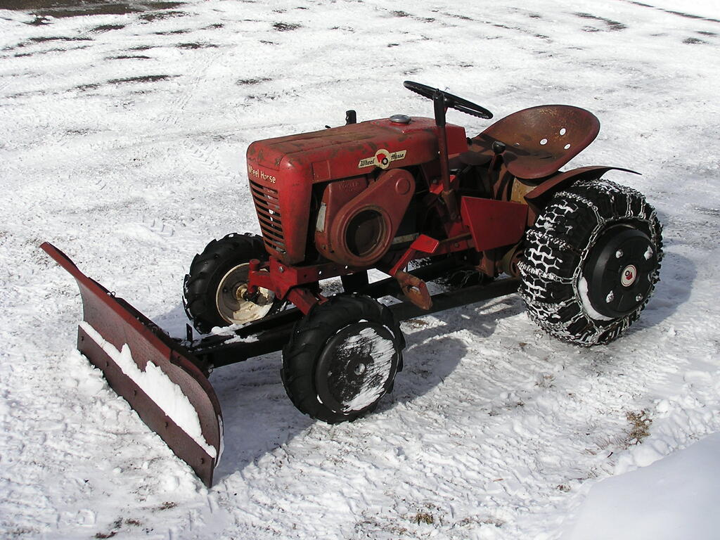

ebinmaine 80,656 #15 Posted July 8, 2023 23 hours ago, Pete D said: Re-reading the for sale post, those were ag tires. I bought it with turf tires. Back to plan A. Pete is there a Rimguard dealer in your area? Also, do you have any ground surface like concrete or asphalt that would keep you from using chains all the time? For overall usage it would be tough to beat chains on turf tires. Share this post Link to post Share on other sites
HyperPete 939 #16 Posted July 8, 2023 @ebinmaine there is a Rimguard dealer nearby, and I do have a long asphalt driveway that bisects my driveway. I put about 150 pounds of weight in the box in back that has helped traction immensely. 1 Share this post Link to post Share on other sites
