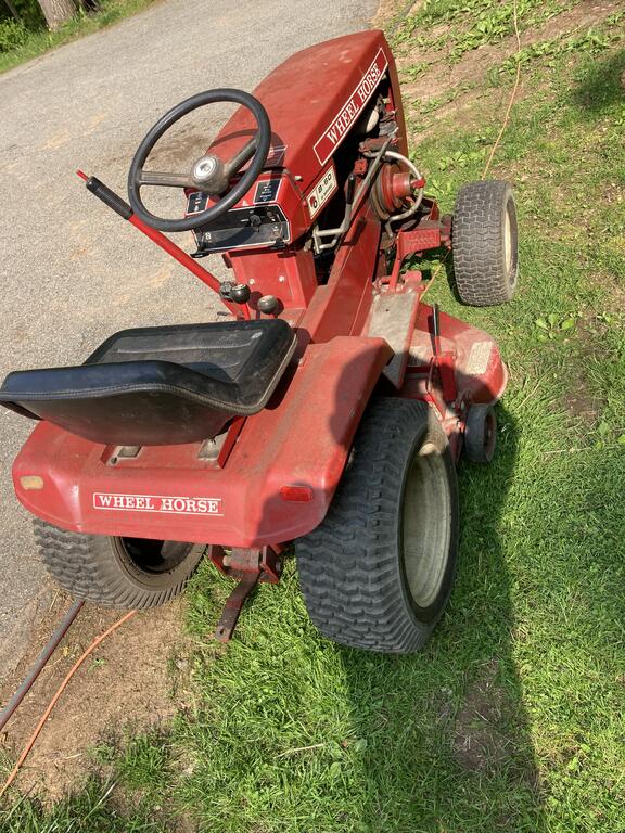

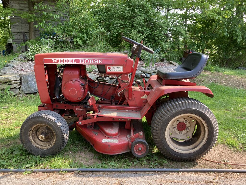

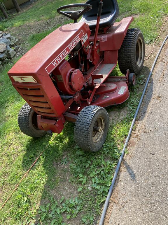

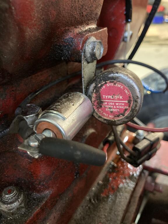

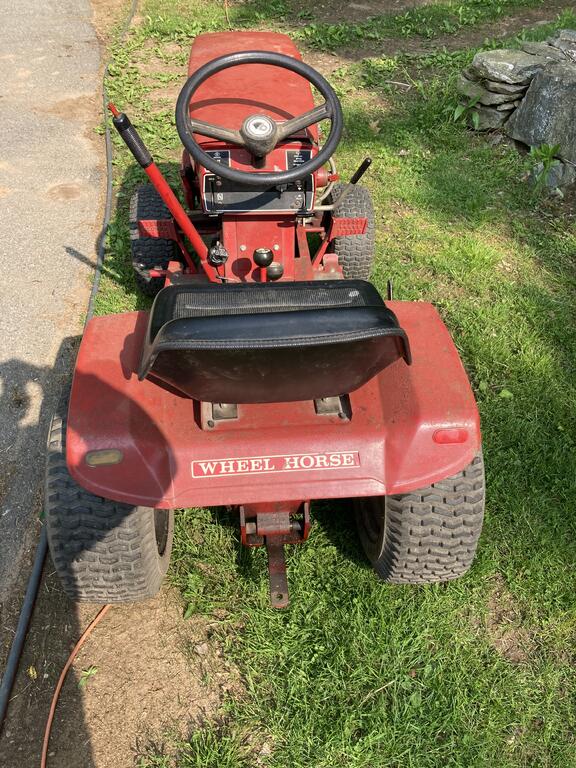

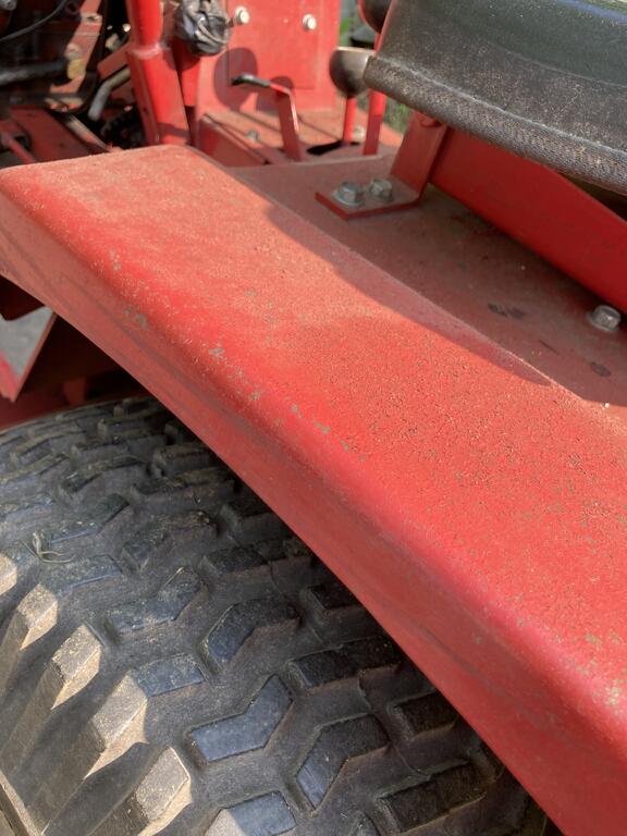

TonyToro Jr. 2,536 #35 Posted May 10, 2023 We just picked up!! It’s in very nice condition and even better once we clean it up. While we’re talking about that is there any way to restore this old paint since it’s started to like flake off. Any help to restore the paint?? But anyway we are trying to get it started and has no spark but in the pictures there’s a piece next to the condenser does anyone know about it? Or if it’s still available? 5 Share this post Link to post Share on other sites

ebinmaine 80,653 #40 Posted May 11, 2023 9 hours ago, TonyToro Jr. said: we are trying to get it started and has no spark but in the pictures there’s a piece next to the condenser does anyone know about it? Or if it’s still available? I'm gonna hazard a guess that it's an aftermarket ignition module of some sort. There are several brands available nowadays. One is Pertronix. @formariz Caz did some experimenting with them a bit ago. You'll want to clean it up and get the numbers off of it then so some internet searching. Likely its directions are online somewhere. Don't make any assumptions about what's causing your no-spark condition. Could be something simple like a broken wire or bad ground. Get a NEW spark plug in there. Find the instructions for your exact model of ignition. Do some careful testing with a test light or volt meter. As to the paint restoration there are a few great ideas here on Redsquare. @peter lena could really help you folks there. The overall condition of that tractor looks excellent!! Great save there! 3 1 Share this post Link to post Share on other sites
953 nut 69,164 #41 Posted May 11, 2023 12 hours ago, TonyToro Jr. said: there’s a piece next to the condenser does anyone know about it? Like EB said, looks like an aftermarket ignition module. Clean the grime off the face of it and do a search for the name and any model number on it. 1 1 Share this post Link to post Share on other sites
peter lena 10,047 #42 Posted May 11, 2023 @TonyToro Jr. nice pick up , that seat , 303 BRAND vinyl boat cleaner in spray bottle , that paint , MMO , or similar paint feeding start , most important is the initial soak time , don't rush it , clean soft cloth rub down , do it again , agree with @formariz on the ignition , issue . take advantage of anything that works / functions , and enhance that area. that seat is amazing ! would take that off and do some lubrication , cleaning detail on that . doing the drool just looking that over , sending you good juju , on that . pete 2 Share this post Link to post Share on other sites
formariz 12,381 #43 Posted May 11, 2023 It’s a pretty old ignition module. There is one now selling on eBay https://www.ebay.com/itm/204039414258 2 Share this post Link to post Share on other sites
formariz 12,381 #44 Posted May 11, 2023 Correct me if I am wrong but it looks like that engine is a K161. If so it may have had a coil which is an oddball and extremely hard and expensive to get. Very possibly it went bad and they resorted to that ignition. 2 Share this post Link to post Share on other sites
ebinmaine 80,653 #45 Posted May 11, 2023 22 minutes ago, formariz said: Correct me if I am wrong but it looks like that engine is a K161. If so it may have had a coil which is an oddball and extremely hard and expensive to get. Very possibly it went bad and they resorted to that ignition. I'd second that as a reasonable assumption 1 Share this post Link to post Share on other sites
