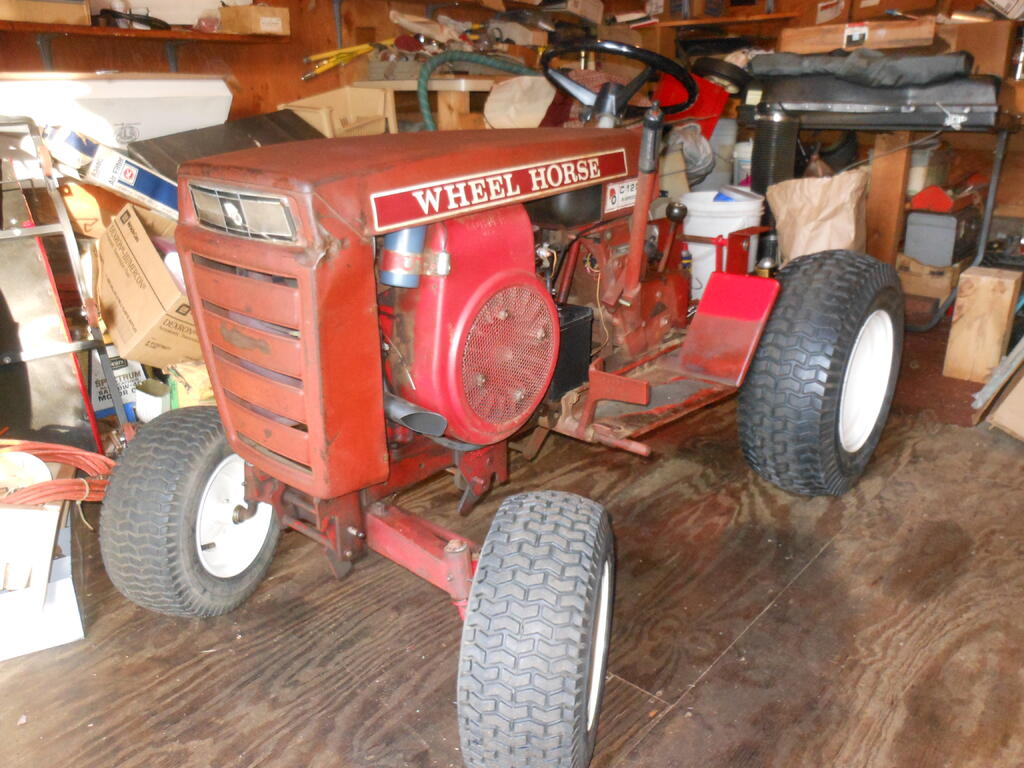

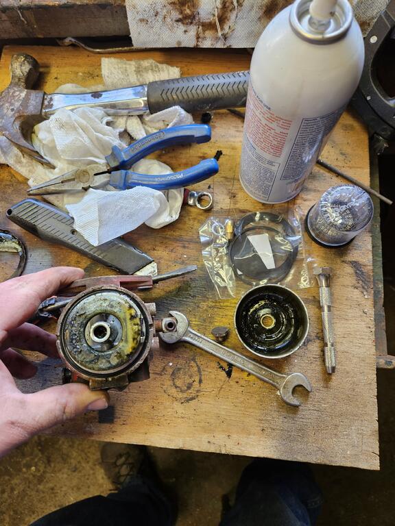

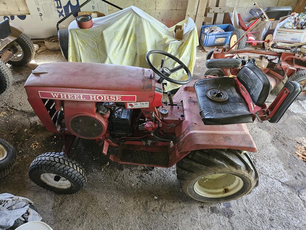

Mike'sHorseBarn 3,704 #1 Posted May 8, 2023 Finally got this c-160 hydro going this weekend. It's been sitting since the late 90's if the battery date is a correct indicator. Needed a new transmission, but the engine is good and strong. Needed a good carb cleaning too! Anyway, I don't want to restore this right away, but I may in the future. What is a good patina preserver that won't ruin my chances of a future restoration? I've been looking at shine juice from vice grip garage, but I wanted to see what you all were using. 4 1 Share this post Link to post Share on other sites

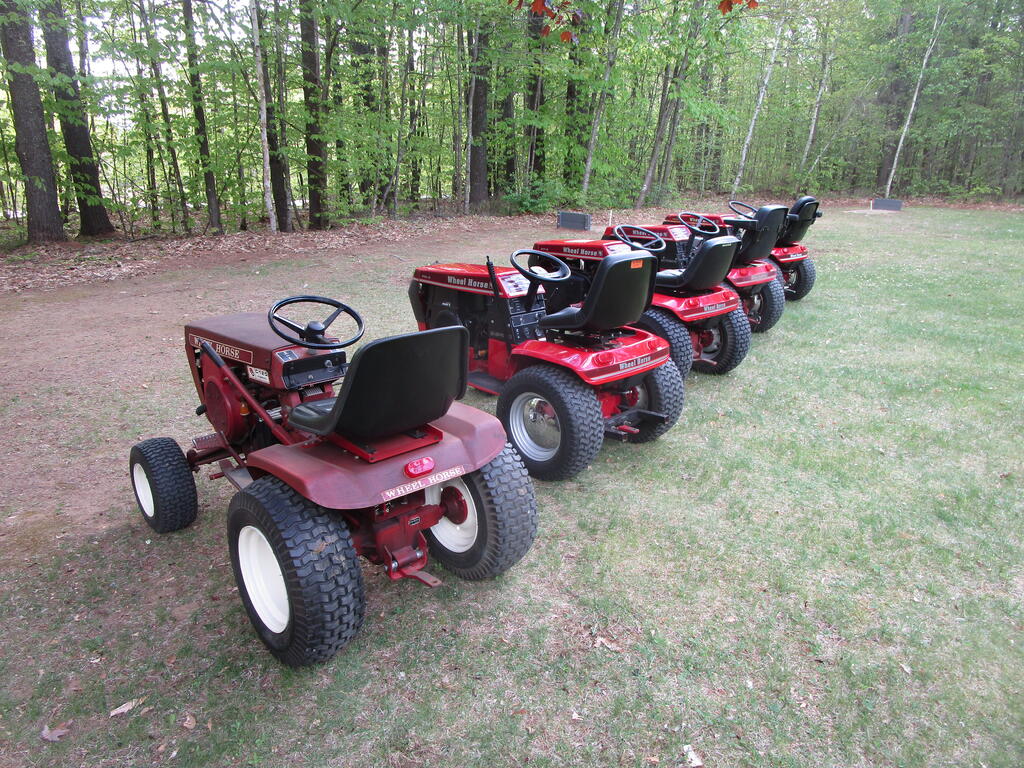

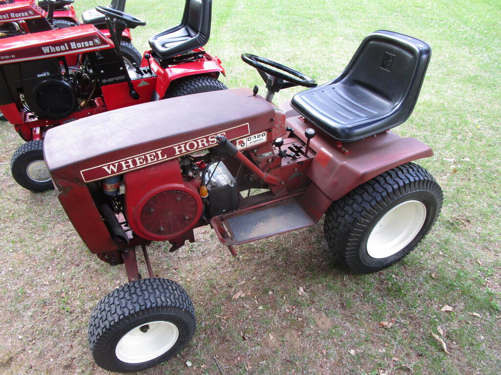

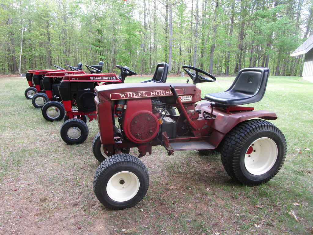

JCM 11,420 #4 Posted May 9, 2023 Some before and after pics from a 1977 C-120 8 speed from the original owner delivering it with the original paint. Used simple green cleaner, wiped it down with clean hot water with a grout sponge, let it dry. then did a light scrub with scotch bright pad. Wiped off dust and used 2 or 3 coats of WD-40 on a clean cotton rag. Some guys don't like the WD because later on if they decide to repaint they say it is a pain to get it all off. I prefer original paint and this C Series was a prime candidate for leaving it original. Apply additional WD when ever you feel the need to feed the paint, it works. JMO Peter Lena also has some great ideas on the topic too. Good luck 4 2 Share this post Link to post Share on other sites

peter lena 10,103 #10 Posted May 9, 2023 @JCM looks good to me , as you know , when you pick up a used horse , the neglect , and just about everything , just trying to get it clean along the way , a paint soak is one of the things I do first , the oil soak is working without any time or effort , while i am doing something else . recent savage / sale I did , was a wreck everywhere, guy that bought it , thought it looked " clean " . it also started right up and had a total lubrication / refresh . and wiring update . your fleet tells me you know what is needed , nice work , pete 2 Share this post Link to post Share on other sites
953 nut 70,058 #11 Posted May 9, 2023 The seat on your C-160 looks amazing. Don't know what product to recommend off the shelf at retail stores but Eastwood has a product that I have used on Vinyl Dashboard covers in the past with good results. https://www.eastwood.com/griot-s-garage-vinyl-rubber-dressing-22oz-10981.html Share this post Link to post Share on other sites
