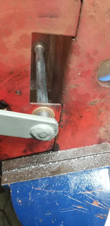

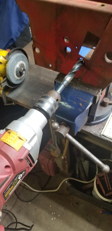

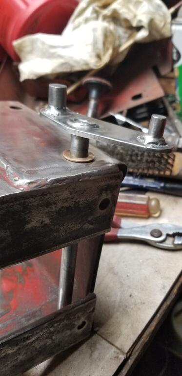

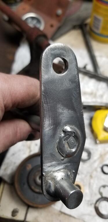

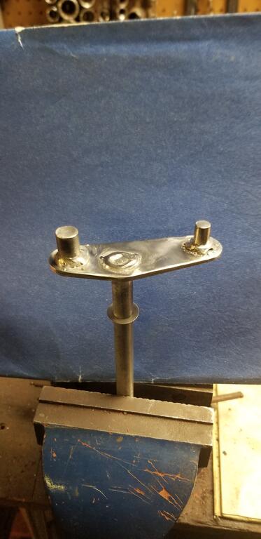

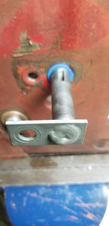

gt14rider 1,051 #22 Posted May 3, 2023 (edited) Here are some mods that I did on my auto 12. Welded new pivot pins, brass bushings and nylon bushing Edited May 3, 2023 by gt14rider Pics 2 Share this post Link to post Share on other sites
ebinmaine 77,507 #24 Posted May 3, 2023 14 minutes ago, gt14rider said: Here are some mods that I did on my auto 12. Welded new pivot pins, brass bushings and nylon bushing VERY nice work! I'm picking up a smaller welder this weekend so we can do repairs like that. 1 Share this post Link to post Share on other sites
