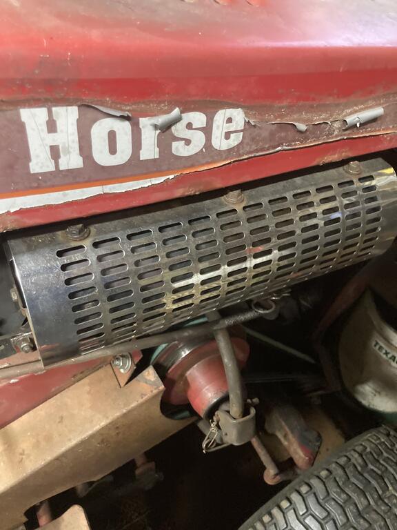

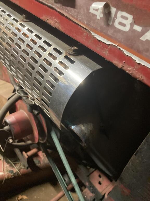

EMS937 10 #10 Posted April 28, 2024 I realized I never uploaded pics, hard to see but to lazy to remove the silver guard lol 1 1 Share this post Link to post Share on other sites

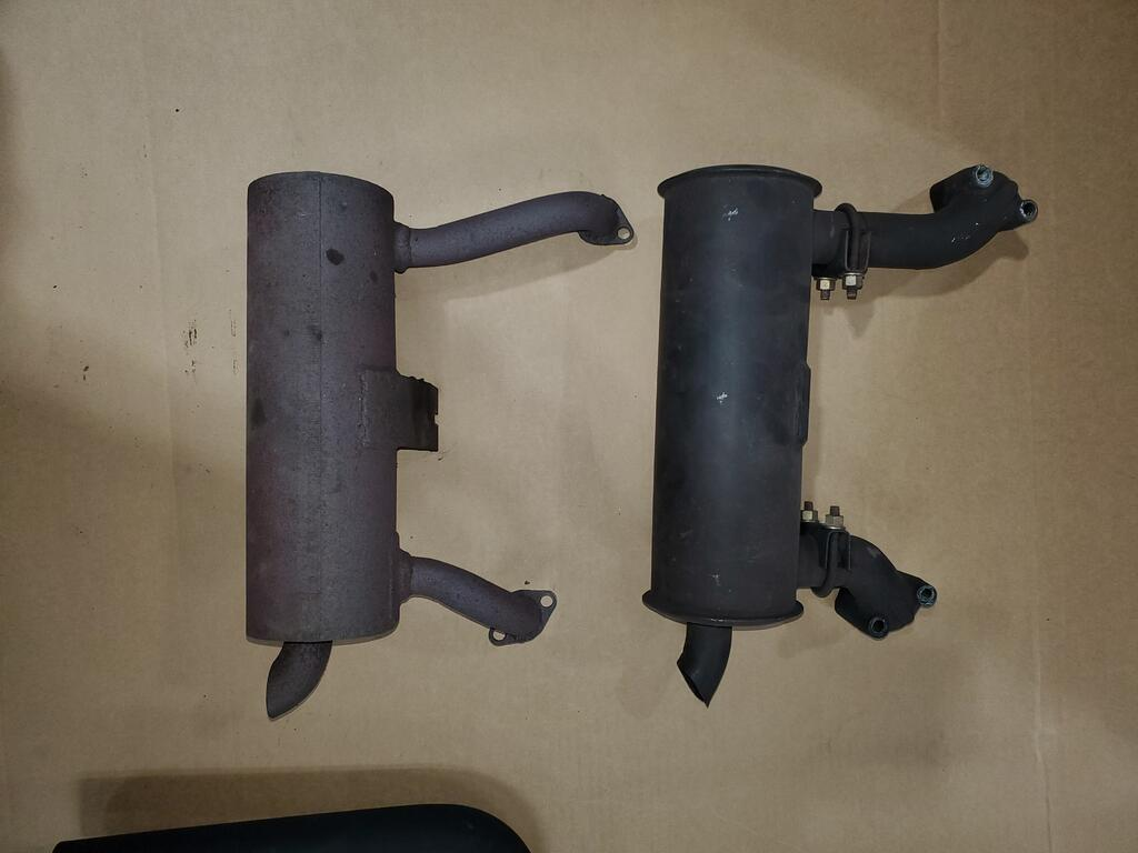

Thor27 892 #13 Posted August 2, 2024 8 hours ago, Tom Sienk said: I am looking to replace the exact same one on my Wheelhorse 520H which has been retro-fitted with a Kohler M18qs. Were you able to find a replacement ? I cant seem locate a actual OEM PN to search for. Thanks ! A deere 317 muffler is more common and will fit under the stock heat shields. Just make sure it comes with the iron manifolds. The turn out at the exit isn't quite as pronounced so it may soot up the hood on a blackhood, but 3,4,5 series are pre-soot colored there... Share this post Link to post Share on other sites

Thor27 892 #15 Posted August 7, 2024 The left is from a 418, right is from 317 Share this post Link to post Share on other sites
