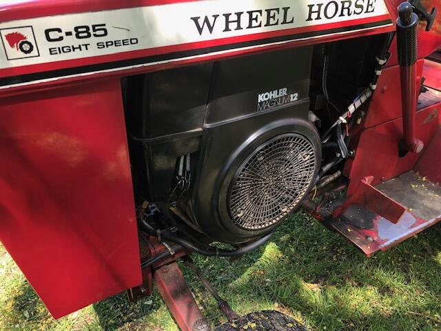

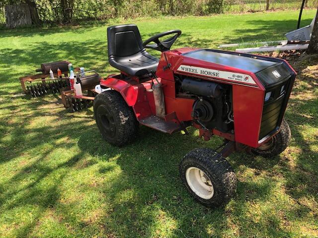

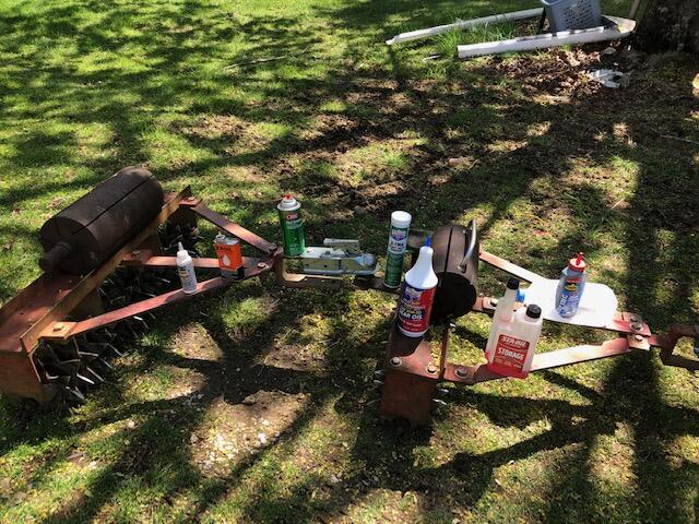

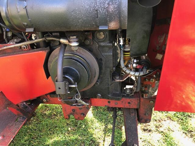

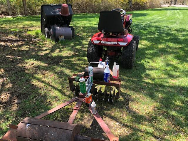

peter lena 10,089 #1 Posted April 25, 2023 tractor and double spiker tow , 200 / 100 lbs added to each unit , insures penetration , soil separation . lubricants regularly used on tractor and spikers . front electric fuel pump , fuel check valve , pto lever heim end joint , spring to control pto slide pin , buzzing / noise, battery tender plug in, spring assist to choke and throttle cables . lubricants , lucas xtra hd grease, sta-bil fuel additive , synthetic super lube , lucas 80-90- high performance gear oil , climbing oil additives . rislone zinc additive , for oil . have tractor over 40 years , bought it new in 82 , still my favorite horse . 3 of them very similar to same set up , no issues , lots of mods , pete 3 Share this post Link to post Share on other sites
