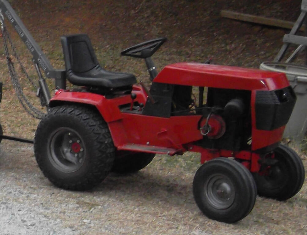

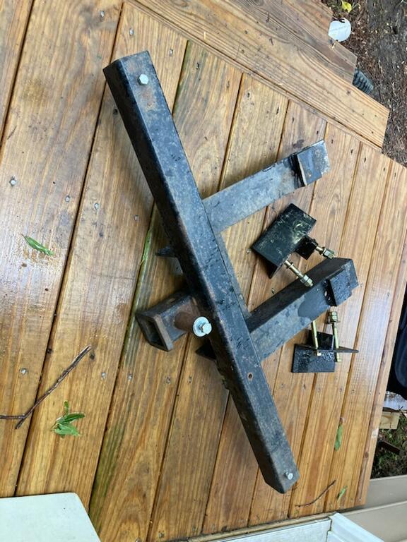

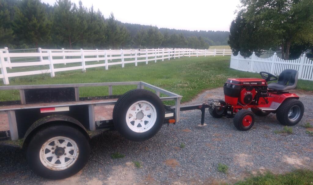

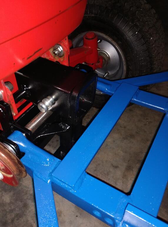

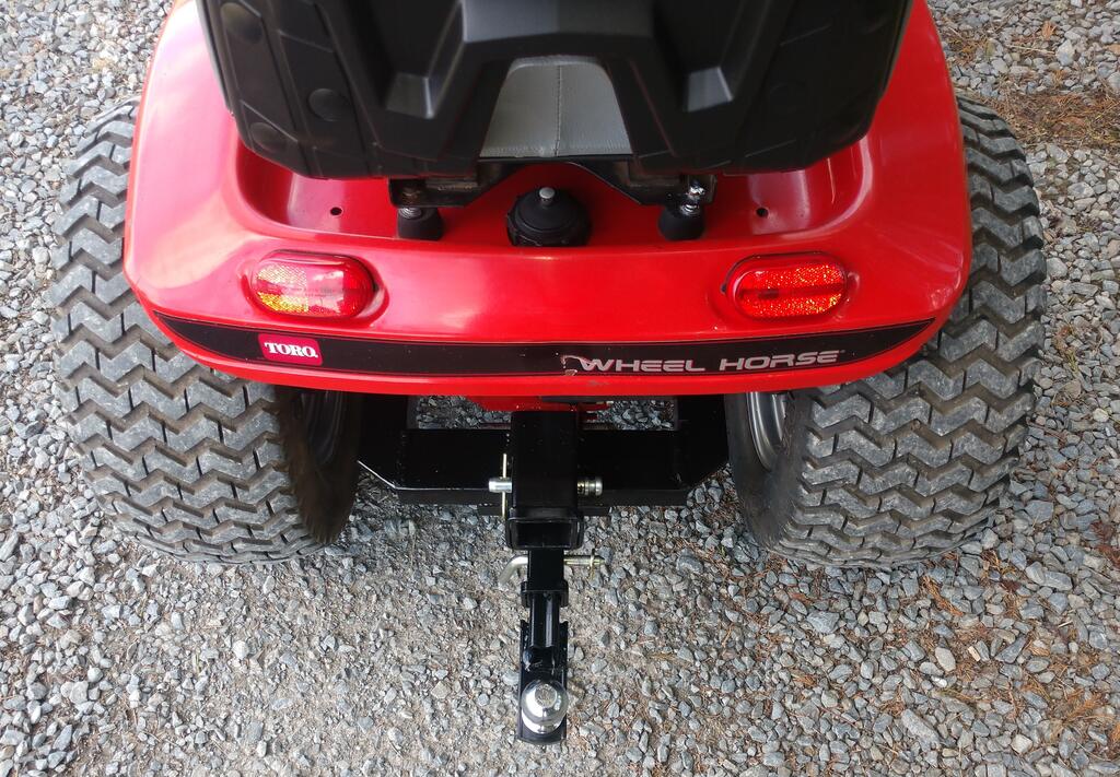

kpinnc 18,970 #1 Posted April 23, 2023 (edited) Got this idea from Don (Lee1977), and I pretty much copied his work. I see all these heavy hitches, so I waited to build one until I found the one I liked best. Don's hitch has two recievers so he can use the truck bed lift and still pull a trailer. His tractor is in the first pic. My hitch wasn't dry enough to handle yet, so I'll mount it tomorrow. Then I'll mount the lift. Mine is the second pic. Edited April 23, 2023 by kpinnc 6 6 Share this post Link to post Share on other sites
ebinmaine 80,756 #2 Posted April 23, 2023 NIIIIICE work Share this post Link to post Share on other sites

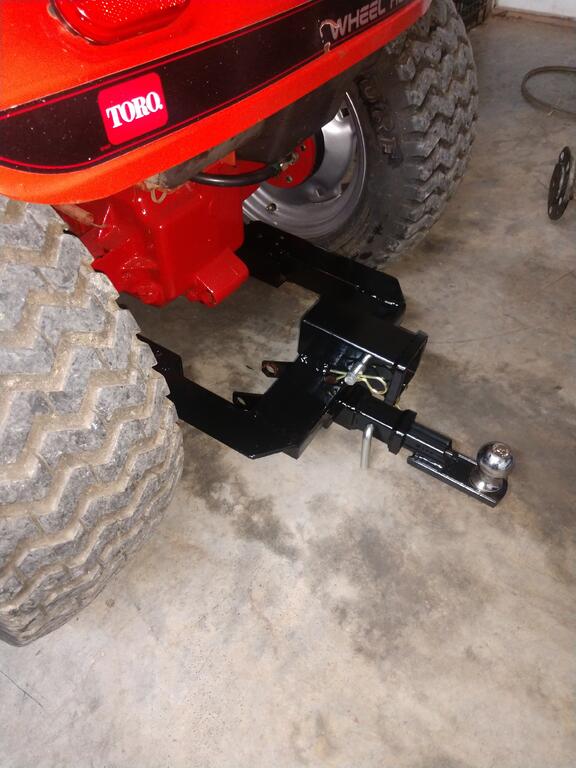

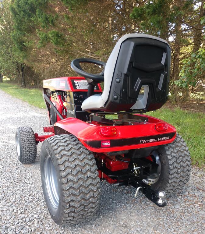

Bill D 3,156 #3 Posted April 23, 2023 Very nice. Please post some additional pictures from different angles? Share this post Link to post Share on other sites
kpinnc 18,970 #4 Posted April 23, 2023 4 hours ago, Bill D said: Very nice. Please post some additional pictures from different angles? Thanks Bill. I still have to make the brace up front for the tranny mount plate. But the hitch is mounted up now. 6 Share this post Link to post Share on other sites

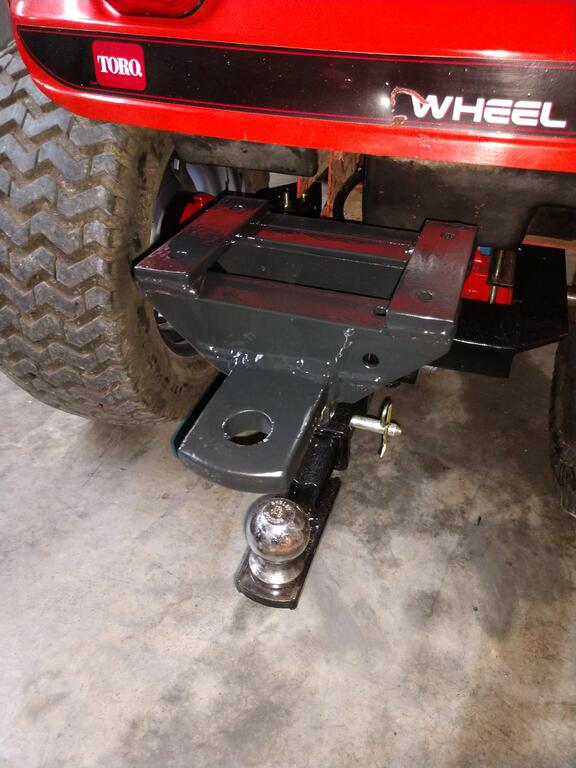

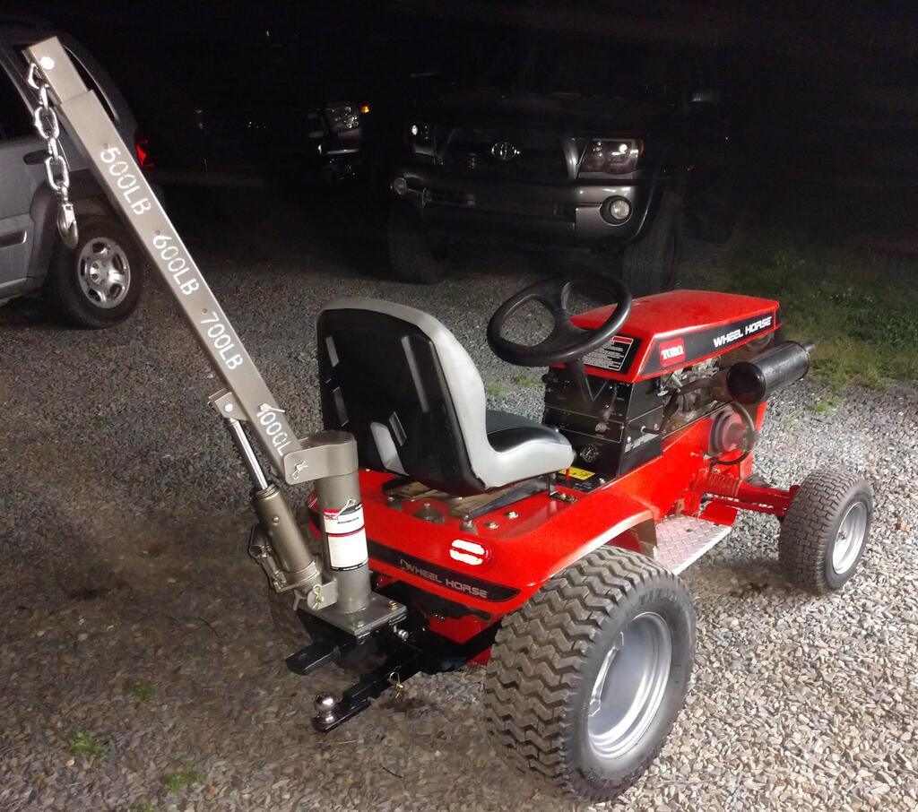

kpinnc 18,970 #5 Posted April 24, 2023 Added the new adapter for the bed crane. Drilled the stupid holes 3/8 instead of 1/2, but I'll open them up tomorrow when the paint is dry. Mounted the crane just to see how it'll fit. No more picking heavy crap up and putting in the trailer! And, it is easily removed with a single hitch pin. 1 7 Share this post Link to post Share on other sites

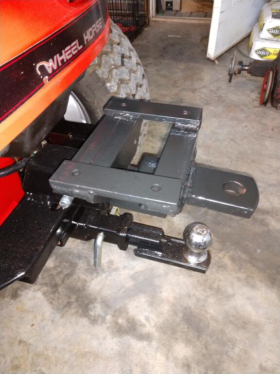

Lee1977 7,784 #10 Posted June 1, 2023 (edited) Here my other hitch It's removable. Only fits the 312-8. The 312 hitch is braced to the top of the transmission. My others are all braced to the hitch at the back of the transmission. Edited June 1, 2023 by Lee1977 3 1 Share this post Link to post Share on other sites

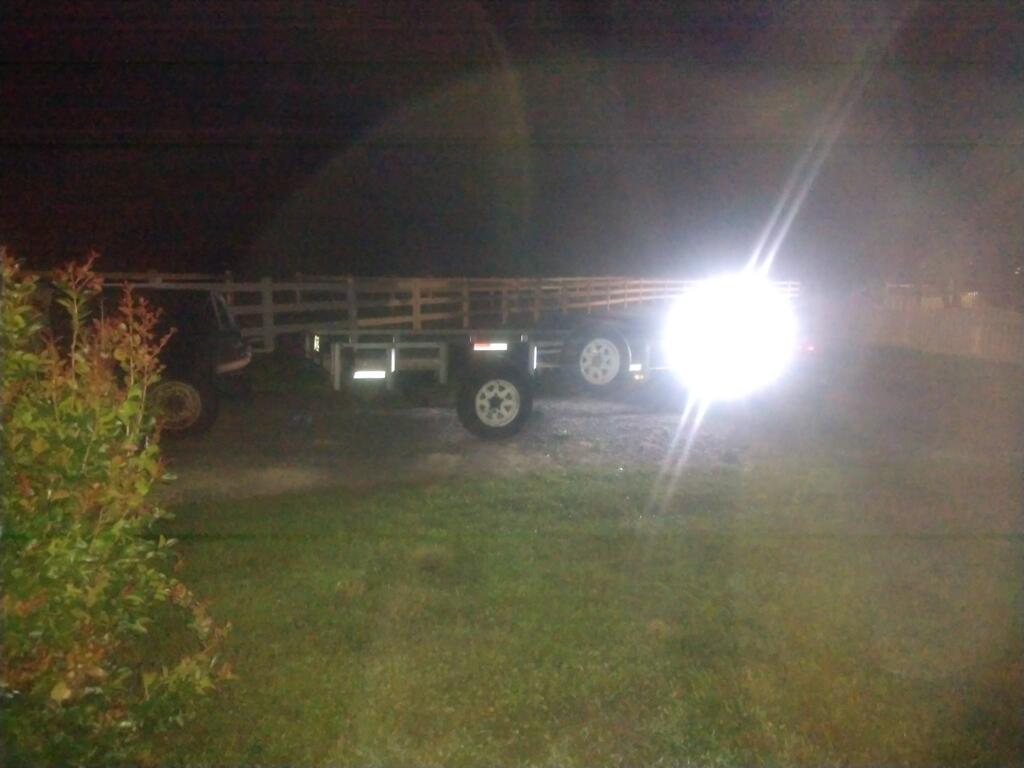

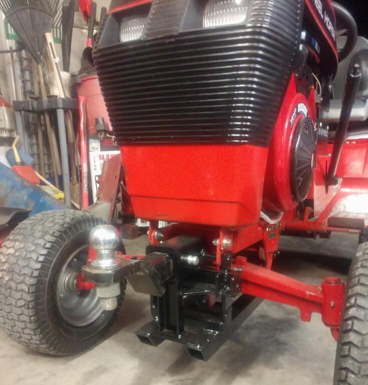

kpinnc 18,970 #11 Posted June 7, 2023 Speaking of hitches... My front mower hitch was built to have two purposes: one to carry the front mount deck, and secondary a receiver for a front trailer hitch. I've seen several members talk about moving trailers with one of these, but I had no idea. This might be the smartest thing I ever built! It's like an aircraft tug now. So much easier to maneuver a trailer around! And another shameless plug for LED headlights for those who still don't like them. Drops my digital voltmeter by .2 volts... Tractor is in the same position, not even facing me. 1 3 Share this post Link to post Share on other sites
OutdoorEnvy 1,817 #12 Posted June 7, 2023 @kpinnc that is the most robust front hitch I’ve seen! Well done! The double mounting to front and at the attachamatic bar is a great idea. It looks seriously tough. 1 Share this post Link to post Share on other sites
kpinnc 18,970 #13 Posted June 7, 2023 1 hour ago, OutdoorEnvy said: The double mounting to front and at the attachamatic bar is a great idea. It looks seriously tough Thank ya! I tend to go overboard on my stuff. I worried that shoving the brush cutter in places I couldn't really see might overstress the front hitch alone. It can of course pivot/ bounce up, but maybe this hitch will tolerate it. 3 Share this post Link to post Share on other sites
