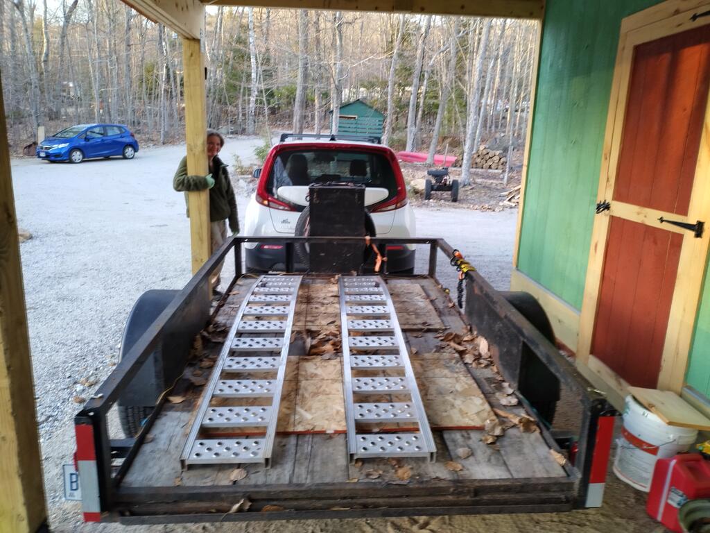

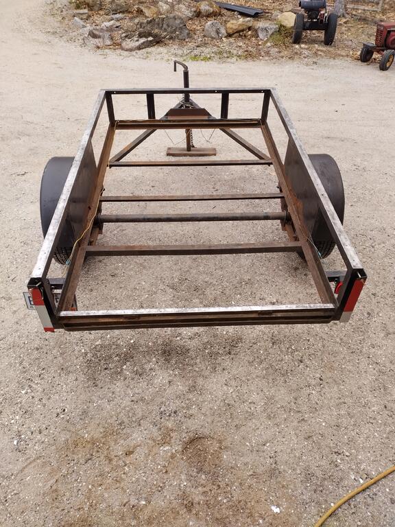

ebinmaine 81,289 #1 Posted April 20, 2023 Our 5 x 8 heavy duty utility trailer has been needing new deck boards for a few years. We've thrown some temp boards in once maybe 3 years ago ((??)) Worked fine but now it's time to fix it long term. Trina's next destruction/rebuilding project is to remove the KD and OSB, scuff off as much rust as possible, repaint and install nice new PT 2 x 8 boards. 7 4 Share this post Link to post Share on other sites

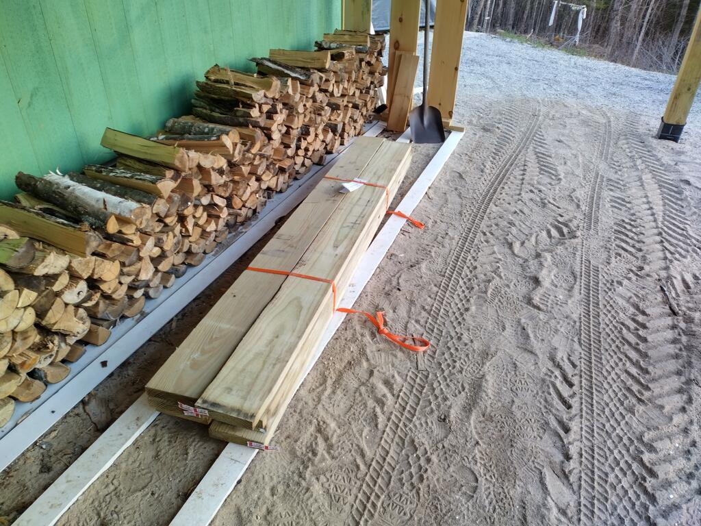

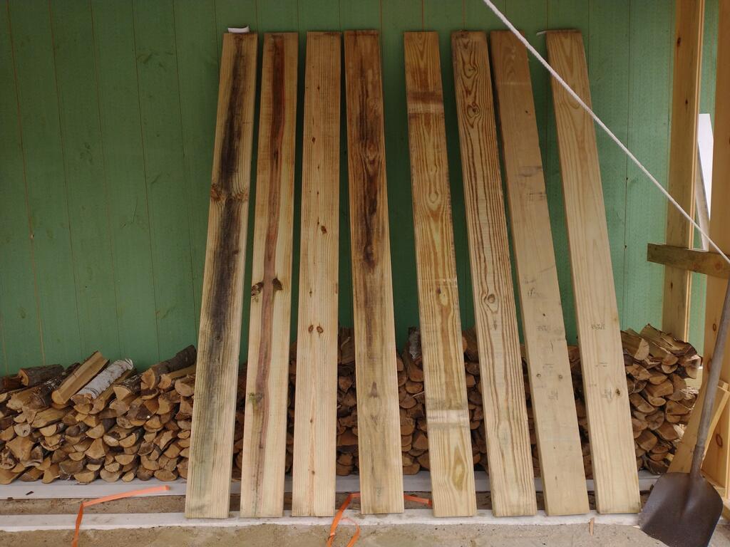

oliver2-44 11,850 #2 Posted April 21, 2023 May I suggest you unbundle those PT boards, get them higher off the ground so they will dry out as much as possible. I realize the trailer floor will get wet in service, but its amazing how much some of those boards can shrink when dry. so that's why I like to install them relativity dry When I repainted my trailer after scuffing it up, I coated the rusty areas with OSPO to somewhat neutralize the rust. I used the Hammered Black paint with a spray gun and semi-don't recommend it. It faded quickly and lost the "hammered look" But it has been on there for 8 years and has not peeled or let rust occur, but it does to appear to be wearing thin from age. 6 Share this post Link to post Share on other sites
ebinmaine 81,289 #3 Posted April 21, 2023 1 minute ago, oliver2-44 said: May I suggest you unbundle those PT boards, get them higher off the ground so they will dry out as much as possible. I realize the trailer floor will get wet in service, but its amazing how much some of those boards can shrink when dry. so that's why I like to install them relativity dry Good idea there. 2 Share this post Link to post Share on other sites
Tonytoro416 1,396 #4 Posted April 21, 2023 Coat underside of the boards before you put them on. I know they are treated but I still water sealed mine 6 Share this post Link to post Share on other sites
Rob J. 1,945 #5 Posted April 21, 2023 I did a little 4x8. Just ripped the old floor out. Bought I think 7 2x6x8’ treated boards and used self tapping lag bolts to the cross members. 3 Share this post Link to post Share on other sites
953 nut 70,665 #6 Posted April 21, 2023 10 hours ago, oliver2-44 said: suggest you unbundle those PT boards, get them higher off the ground so they will dry out as much as possible. Be sure to allow a 1/4" or more between boards so dirt and debris won't accumulate holding moisture. Share this post Link to post Share on other sites
Sparky-(Admin) 26,899 #7 Posted April 21, 2023 Fixing it before or after Zagrays? Share this post Link to post Share on other sites
ebinmaine 81,289 #8 Posted April 21, 2023 29 minutes ago, Sparky said: Fixing it before or after Zagrays? Definitely before. If Trina does not have a busy work from home day today it'll be shredded by the time I get home. 30 minutes ago, 953 nut said: Be sure to allow a 1/4" or more between boards so dirt and debris won't accumulate holding moisture. As it works out by the original manufacturer that's exactly what happens when you use the right boards. 1 Share this post Link to post Share on other sites

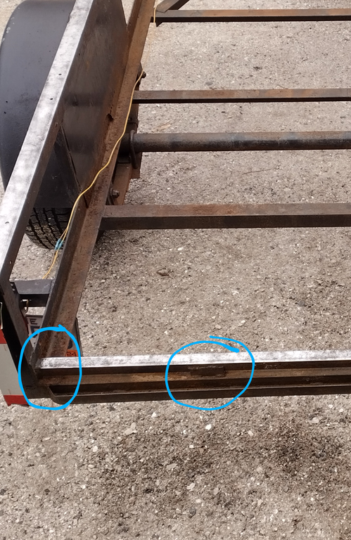

Pullstart 71,571 #9 Posted April 21, 2023 Are there steel lips on both ends of the boards? I saw a video of a dude put the first end under the lip, then stuck an appropriate sized block between the board and first crossmember. He bent the board down under the rear lip and had someone blast the block out with a BFH. 2 Share this post Link to post Share on other sites
ebinmaine 81,289 #10 Posted April 21, 2023 4 minutes ago, Pullstart said: Are there steel lips on both ends of the boards? I saw a video of a dude put the first end under the lip, then stuck an appropriate sized block between the board and first crossmember. He bent the board down under the rear lip and had someone blast the block out with a BFH. Yeah that's how this one is set up. My boss saw that same video. No way we can do that with these boards though. I don't know about the rest of the country but up here in the Northeast anything pressure treated is almost always yellow pine which is technically a hardwood for the hardest of the softwoods, if you like. We have no way of bending it enough to put that much of a bow in it. Trina's thinking she will probably take an 8-in cut out of the middle of the back piece. When it's time to put it back together we could hold it in place with a piece of strap steel or wood for a few weeks until I can get the welder there. 3 Share this post Link to post Share on other sites
Pullstart 71,571 #11 Posted April 21, 2023 10 minutes ago, ebinmaine said: Trina's thinking she will probably take an 8-in cut out of the middle of the back piece. When it's time to put it back together we could hold it in place with a piece of strap steel or wood for a few weeks until I can get the welder there. great approach! 1 Share this post Link to post Share on other sites
gwest_ca-(File Mod) 12,557 #12 Posted April 21, 2023 1 hour ago, ebinmaine said: Trina's thinking she will probably take an 8-in cut out of the middle of the back piece. When it's time to put it back together we could hold it in place with a piece of strap steel or wood for a few weeks until I can get the welder there. Could you cut the metal on one end and the side and bend it up to insert the wood. Bend it back down. Maybe two 4-1/2" cuts and split it in the center. Bend back down and may not need welding. Sure would be nice if you could eliminate screws. First place the wood rots. Quote 2 Share this post Link to post Share on other sites
ebinmaine 81,289 #13 Posted April 21, 2023 Just now, gwest_ca said: Could you cut the metal on one end and the side and bend it up to insert the wood. Bend it back down. Maybe two 4-1/2" cuts and split it in the center. Bend back down and may not need welding. That could be a thing. I'll take a look at it when I get home. Share this post Link to post Share on other sites

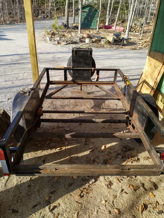

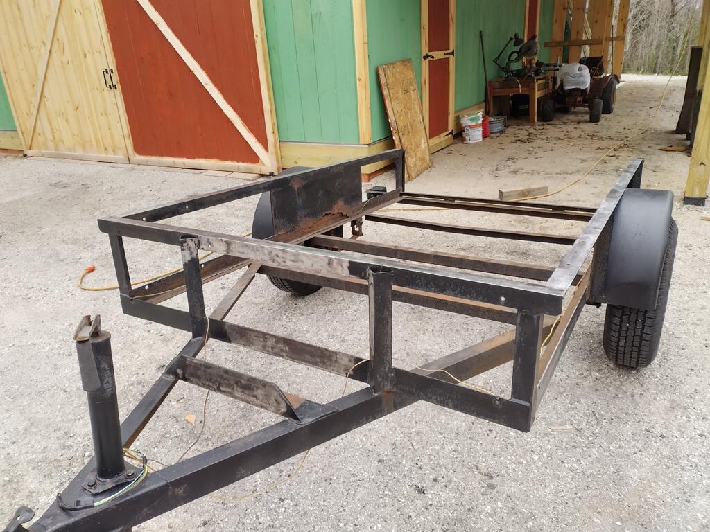

ebinmaine 81,289 #16 Posted April 21, 2023 Earlier today Trina separated and stood up the deck lumber. After that she and the Momma shredded the old deck outta the trailer frame. 5 1 Share this post Link to post Share on other sites
Oldskool 6,679 #17 Posted April 21, 2023 While apart it maybe a good idea to look over every weld for cracking. 3 1 Share this post Link to post Share on other sites
ebinmaine 81,289 #18 Posted April 21, 2023 1 minute ago, Oldskool said: While apart it maybe a good idea to look over every weld for cracking. Yessuh 1 Share this post Link to post Share on other sites

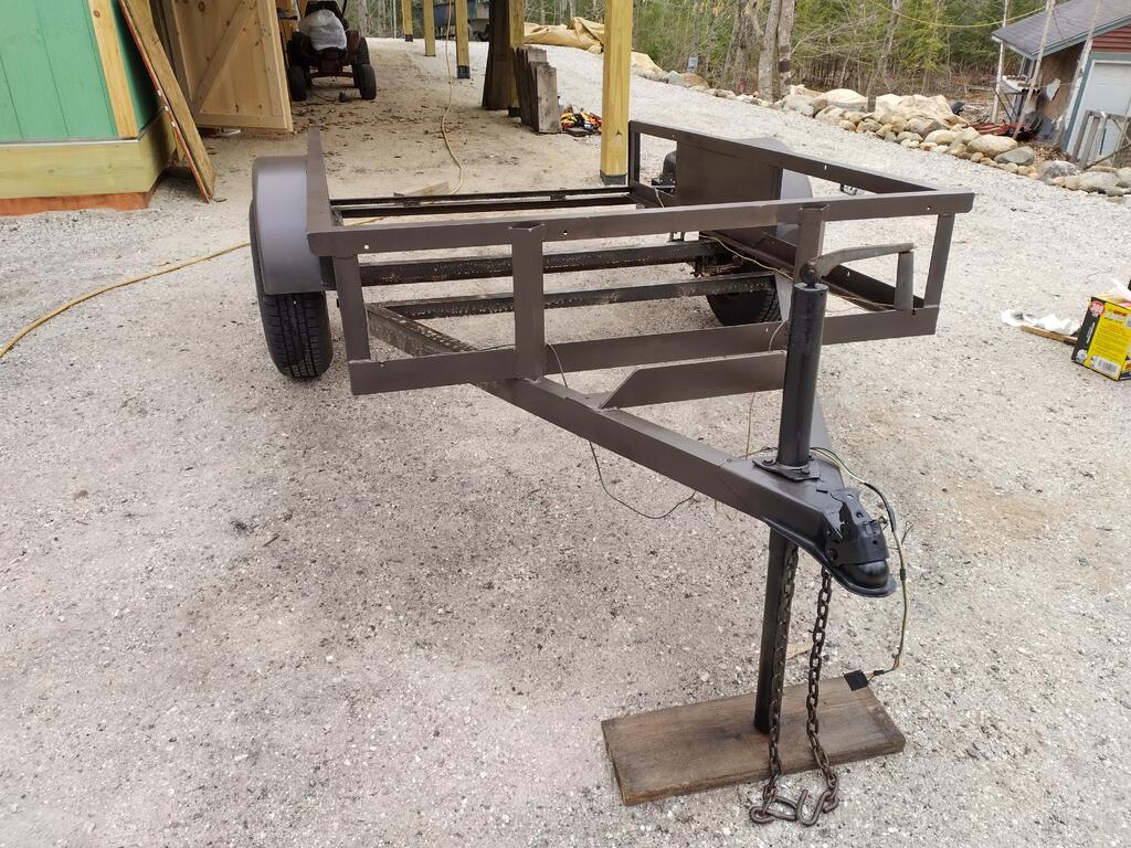

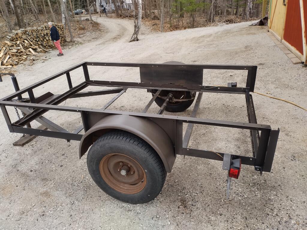

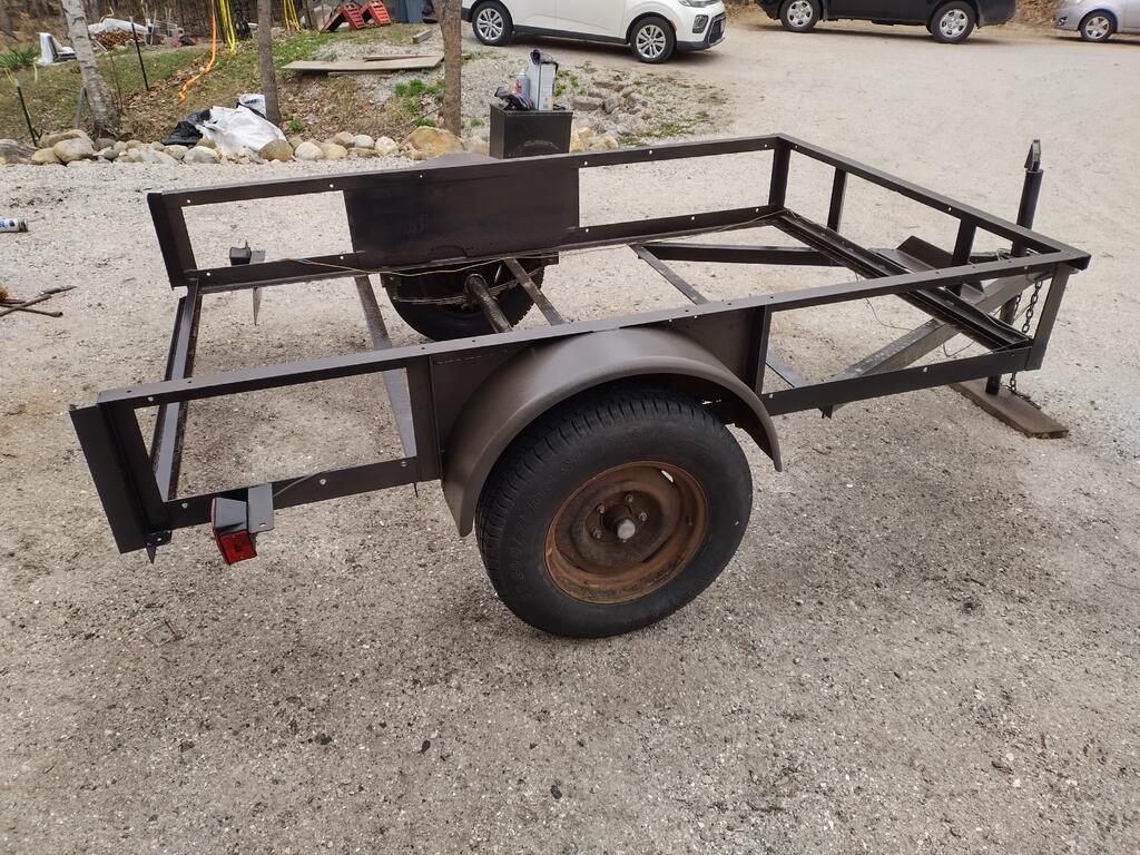

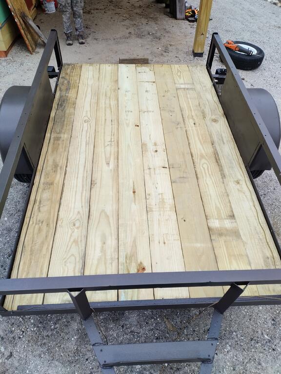

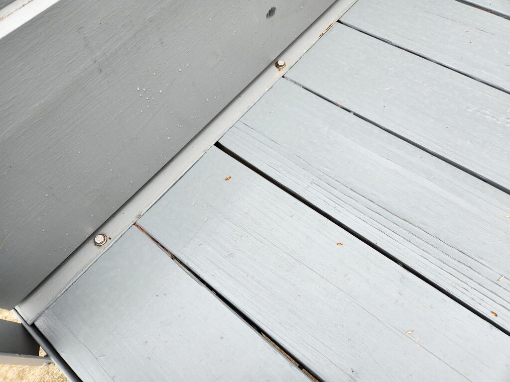

ebinmaine 81,289 #21 Posted April 22, 2023 20 hours ago, Oldskool said: While apart it maybe a good idea to look over every weld for cracking. Checked the welds. All looked good. Earlier today I cut the tall "toolbox" off the front. Never liked since we bought the trailer. It's always leaked and was tough to reach the bottom. Removed the biggest portions of rusty scale from a few areas. Washed with acetone. Trina sprayed some paint on the upper/outer surfaces. I sprayed Fluid Film on the others. Went with the dark brown sand filled gritty textured paint that I originally bought for Colossus. I made some changes to that color scheme so we had 3 full cans. Ran a little shy at that so we used black here and there. 3 4 Share this post Link to post Share on other sites

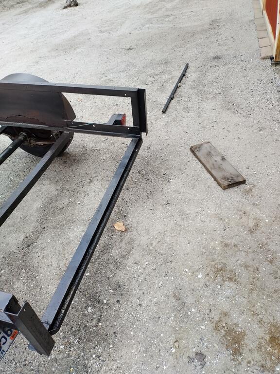

ebinmaine 81,289 #22 Posted April 22, 2023 After we got all the coatings done I was gonna move on to setting the boards in place. I measured the length of the trailer in comparison to the 8' standard lumber. The trailer mount was about 1-1/4" shorter than the 96.5" boards. Rather than trim them Trina and I decided to remove the rear deck retainer. 4 welds cut and blammmo. I found some 5/16" x 3" carriage bolts. Drilled the boards and frame, 1 per. All boards are set with a frown so whatever water hits it will be prone to running off. Nearly complete. Just need to add conspicuity tape up front on the sides and fasten the wires in a few spots. 5 3 Share this post Link to post Share on other sites
OutdoorEnvy 1,817 #23 Posted April 22, 2023 So much better! Looks like it’s ready for the long haul! Good work! 1 1 Share this post Link to post Share on other sites
ebinmaine 81,289 #24 Posted April 22, 2023 26 minutes ago, OutdoorEnvy said: So much better! Looks like it’s ready for the long haul! Good work! Thanks!! Trina said just about the same thing. This repaint/repair should last for years to come. 1 Share this post Link to post Share on other sites
Oldskool 6,679 #25 Posted April 22, 2023 Looking really good. Like brandy spankin new. Kinda surprised you didn't do something with the wiring before decking it over. 1 1 Share this post Link to post Share on other sites
