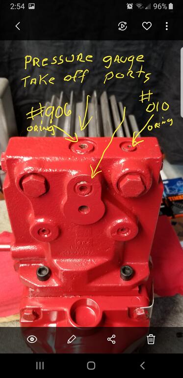

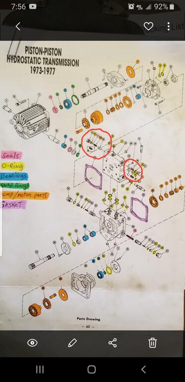

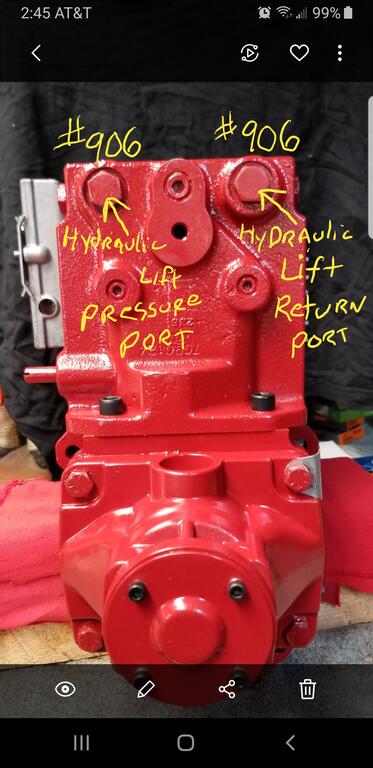

Jeff young 5 #1 Posted April 19, 2023 I have a charger 10 with a sundstrand 90/2046. It was a manual lift and I am putting a hydraulic lift on it. Can anyone tell me where I can buy this cone and spring I need to put in the pump, and also what ports the hose hook up to. Any help is greatly appreciated. Share this post Link to post Share on other sites
gwest_ca-(File Mod) 12,365 #2 Posted April 19, 2023 More https://www.wheelhorseforum.com/search/?&q=8-4111&type=downloads_file&search_and_or=or&sortby=relevancy 2 1 Share this post Link to post Share on other sites
Jeff young 5 #3 Posted April 19, 2023 Thank you very much sir. It’s hard to find what I was looking for and this is the ticket. Now I just have to find a cone and spring. Thanks again 2 Share this post Link to post Share on other sites
