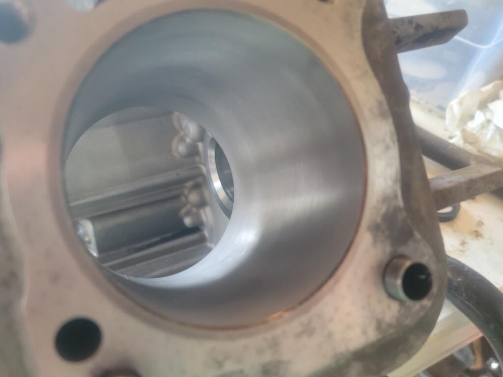

RED-Z06 2,720 #5 Posted April 18, 2023 Ive never liked ball hones myself, i use a 3 stone, crank up the tension and use brake cleaner for lube. Cuts fast, hard on the stones, but leaves a nice pattern quickly. 4 1 Share this post Link to post Share on other sites

RED-Z06 2,720 #8 Posted April 19, 2023 56 minutes ago, oliver2-44 said: @RED-Z06 @pacer @Achto What grit do yall like/recommend to use? Alot depends on the material and how bad it is, as well as my ring composition. A K/M is just a cast iron bore, not quite as hard as a steel sleeve like a modern engine, if you're using normal iron rings, 180 or 220 is good, if you're using chro-moly faced rings a little finer grit, if available is better, like a 280 or a 320. You have to make sure you set the cross hatch right on the last few passes, i like to use my cordless drill, low range, and slow my stroke rate down to set the cross hatch. Biggest thing is cleaning, hot soapy water, you can't get it clean enough. 1 1 Share this post Link to post Share on other sites
