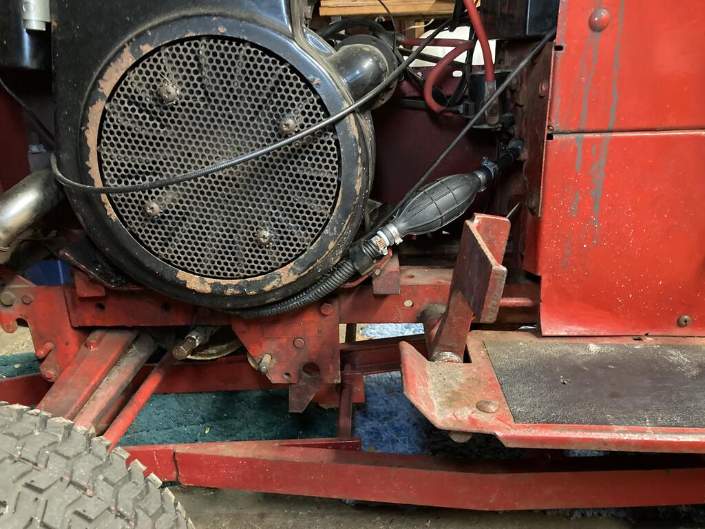

SylvanLakeWH
:text-yeahthat:
Heres my primer bulb. Works like a charm... couple squeezes and starts / runs perfectly...
Edited by SylvanLakeWH
  • Like 1
  • Excellent 1

The primer bulb is pretty nifty. Where do you get one at? What kind of electric pump is used and i guess its wired to the switch? So the factory fuel pump has a back flow valve in it? All this makes since since the filter is usually dry after a couple of days. Still amazing how much faster it starts now.
